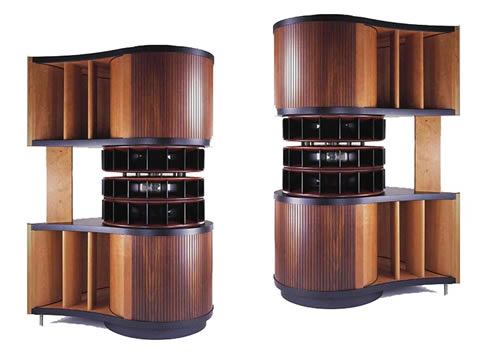

Has somebody tried to build a 360 degree multi cell horn consisting of conical flares with a compression driver at the center of the horns both in the top and bottom?
Platinum Audio:
How predictable is the “waveguide” on these things? Does it follow a certain mathematical shape? I remember you made a 360 degree paraline (YouTube). Have you ditched that idea? If so, how come?

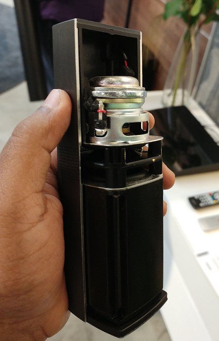

The Bose Lifestyle 650 satellites appear to be close to omnipoles. Note that their outer width is just 1.84" (47 mm). The drivers are so small that even the vertical dispersion could be good up to 5 kHz, maybe even higher. I think the difficult part of building something like this would be to design the shape of the 'reflector' cones.
(pic taken from HarwareZone.com)
Would be interesting to see a picture of the reflector.
