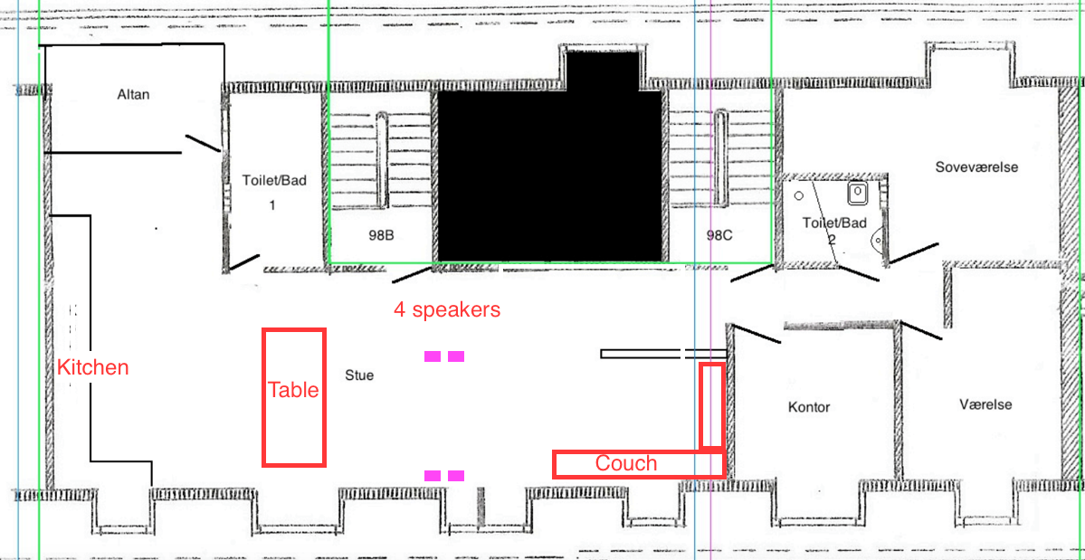

In-wall will not work for me. I have a fairly long living space of 55 m2. In one end is the couch-area and in the other end is the dining table and kitchen.
I need speakers placed halfway between the dining table and couch area. Ideally 4 speakers back to back. 2 pointing towards the dining table and 2 pointing towards the couch.
This is why omni would be ideal or figure eight.

The Duevel posted is omni, it doesn't sound like you want omni? A plan of your room and where you want the speakers would help.

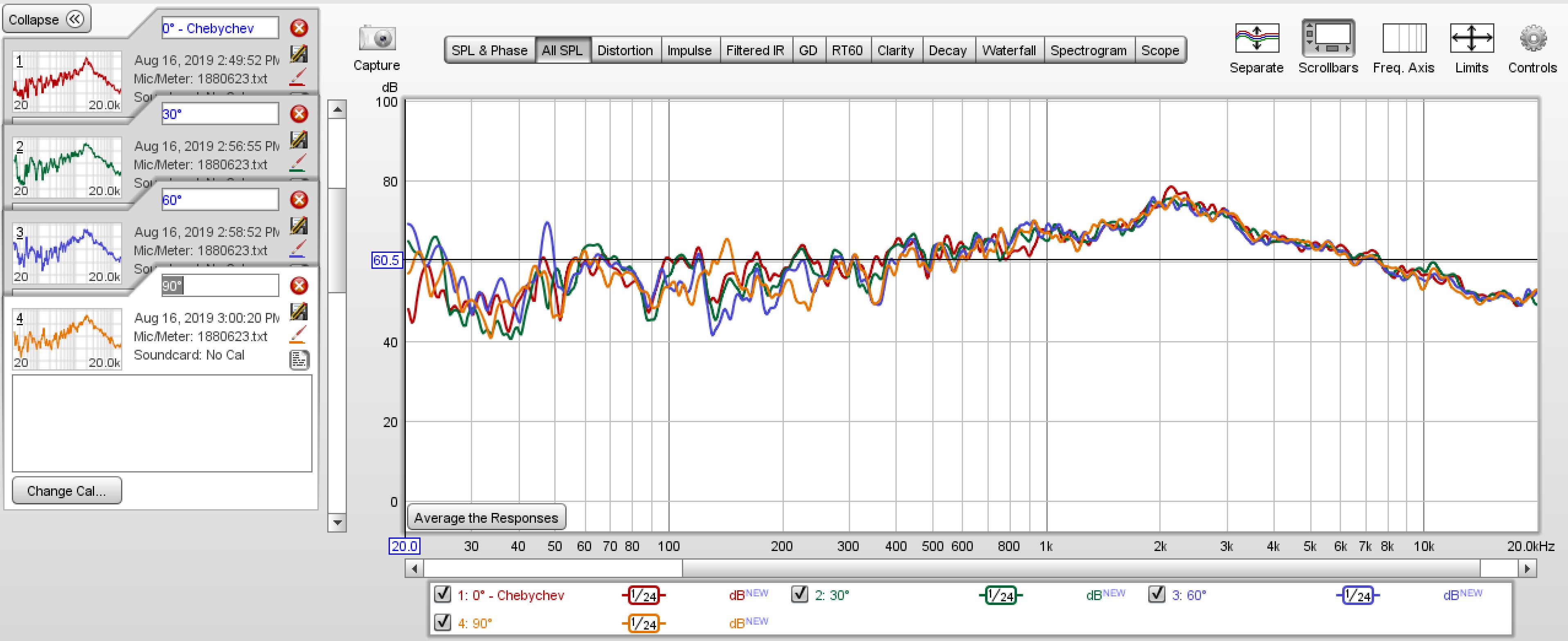

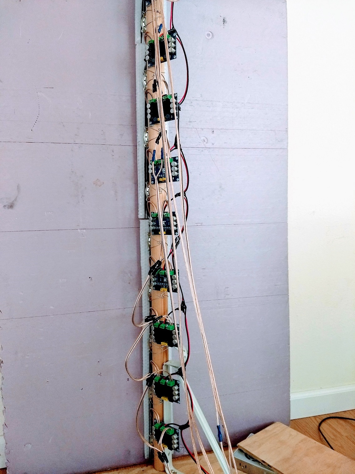

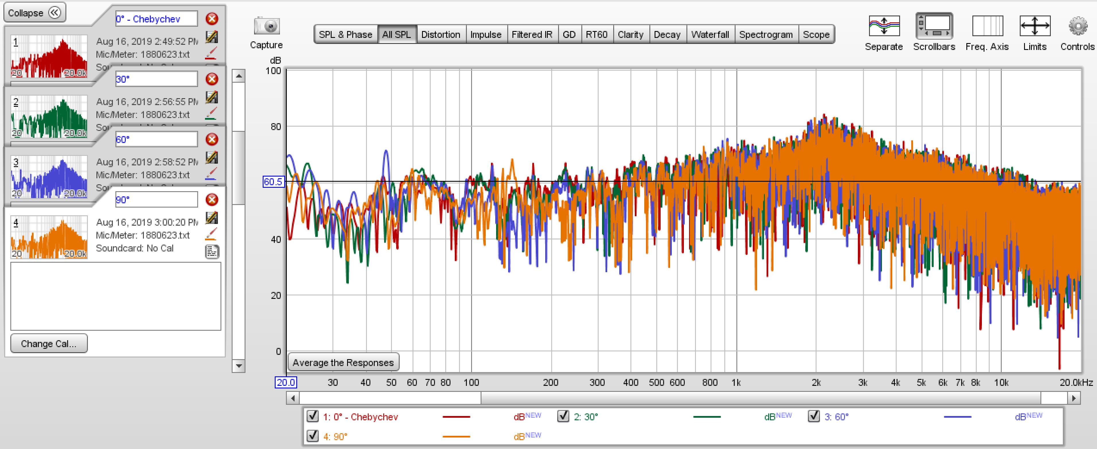

I'll explain my thinking. I combined a CBT array with a distributed mode loudspeaker array that becomes pistonic at lower frequencies. My goal was to have wide physical dispersion with narrow psychoacoustic perception. It also provided something I didn't know I wanted, a vertical sound field.
It measures and sounds the same front and rear. But it isn't omni. It's dipole. It cancels on the sides. It's narrow and thin. On the other hand, it's tall. It also requires a minimum of six channels of DSP to delay curve the CBT portion of the array. And DSP is absolutely required for EQ. I'm sure a genius can figure out how to design the panel materials and dampening without EQ, but I certainly can't.

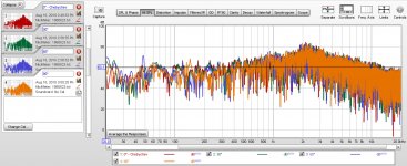

Or maybe not. I'm not sure because I don't know if the CBT is helping or not. REW measurements read a chaotic frequency response at the mic that I can smooth, but I don't know what really going on. I think I hear improvement with the CBT but I can't trust my ears and inherent bias. It's possible that a multi-actuator array in a narrow-tall without CBT time delay and shading sounds just as good.
Subjectively, they do what I wanted even though I can't figure out how to properly measure them with REW. They also do something I didn't know I wanted, produce a vertical sound field. To my untrained ear, strings and piano sounds great. I think it's because of the vertical sound field of a tall array but I don't know.
The bottom line is that with your floor plan you might like a tall-narrow dipole CBT built with traditional cone speakers. If you use DSP you can make it a straight array rather than a physically curved array. You'd be able to accurately measure CBT performance with REW because you'd have regular cone speakers. And most of your EQ would be handled with good driver selection. You'd get dipole cancellation on the sides but I'm not sure if you'd notice it because your sitting/standing areas are in the kitchen and on the couch. People standing in the kitchen would get good sound and so would people sitting on the couch. Most people wouldn't notice the sound was degraded for a moment when they walked from the kitchen to the couch.

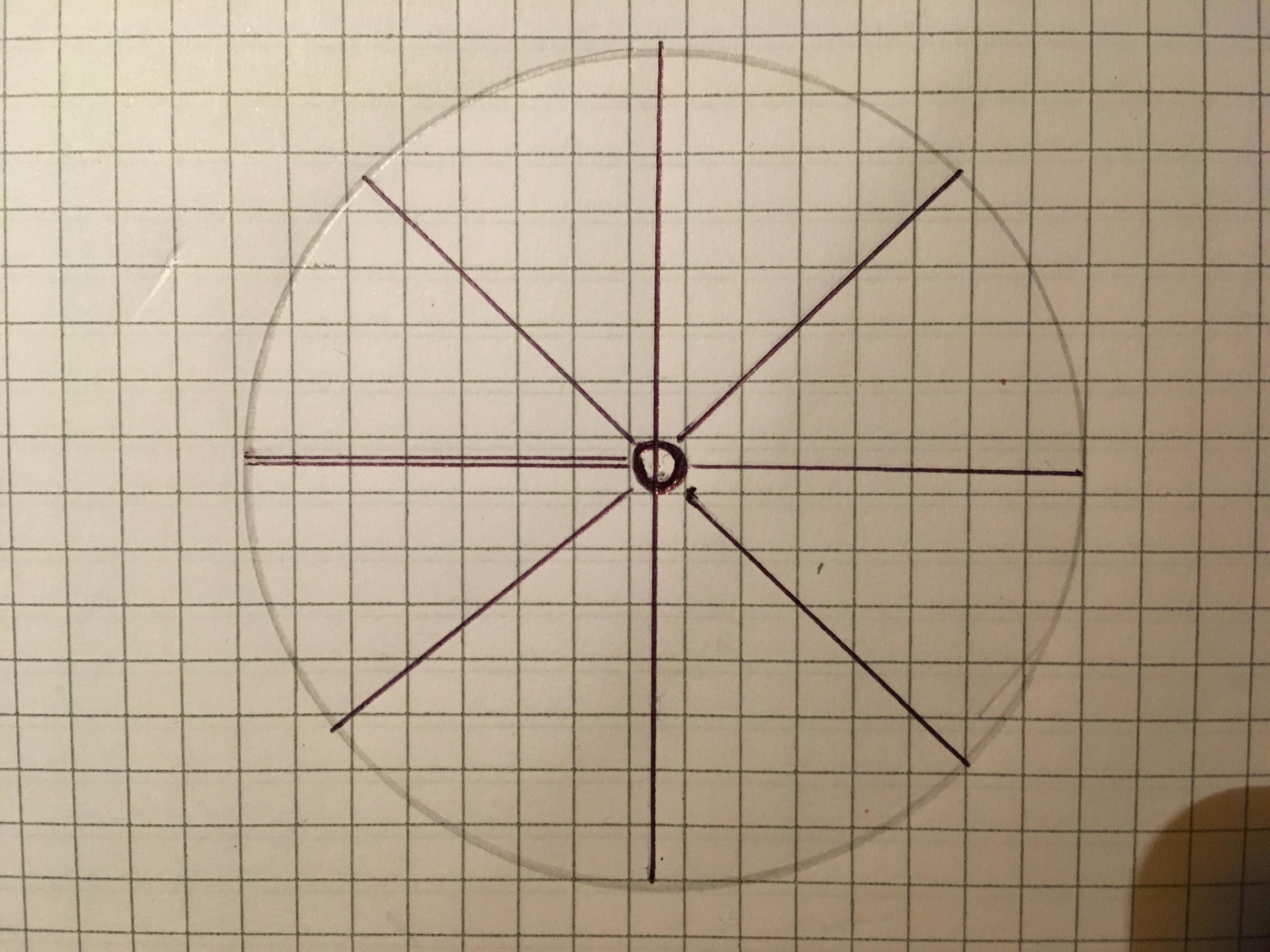

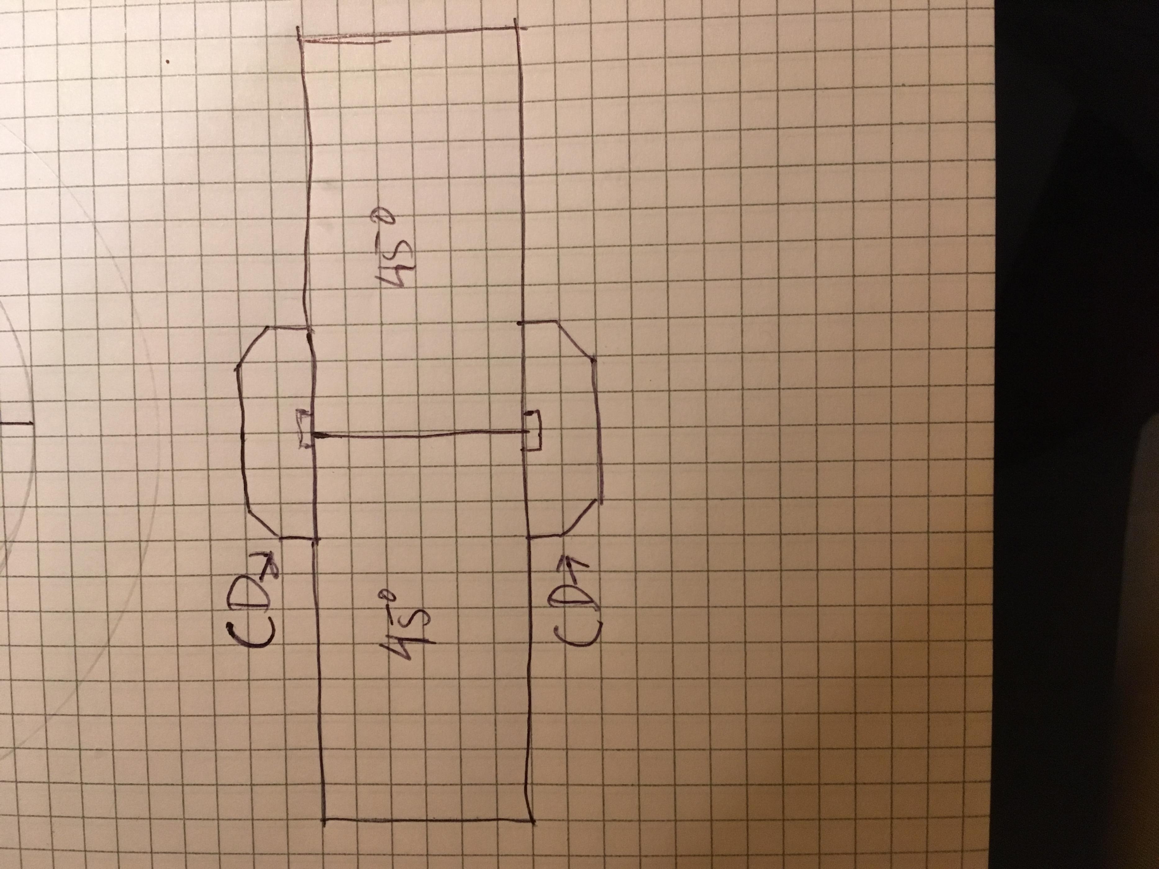

Has somebody tried to build a 360 degree multi cell horn consisting of conical flares with a compression driver at the center of the horns both in the top and bottom?
