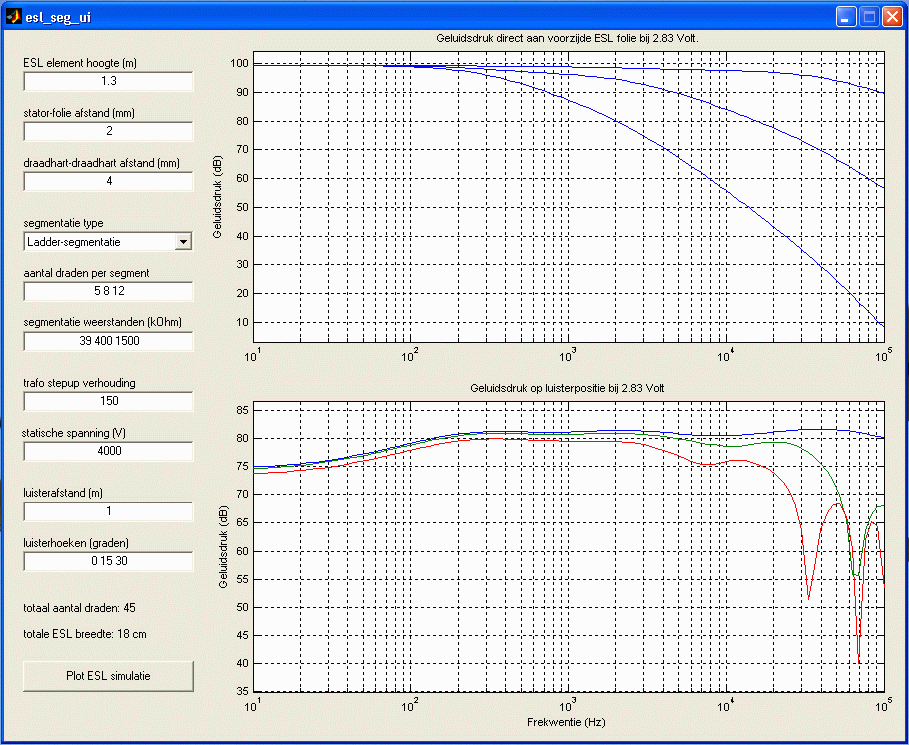

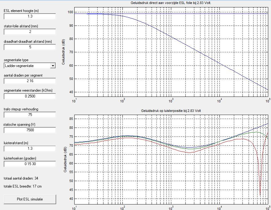

Hello,
I'm currently designing a hybrid ESL with the help of a software tool thats floating around on the web, made by a Dutchman whose name I regrettably cannot retrieve. It's a simulation of dispersion and frequency response of a flat ESL panel, plotted for different listening angles. I'm sure most of you are familiar with the program.
I have made this design where dispersion up to 30 degrees listening angle and up to 20 khz is about equal. Of course, this comes to a price where the frequency respons is less than ideal. However, I'm planning to have active equalization through a miniDSP because of the hybrid system, enabling me to adjust the frequency response to a flat line, whilst keeping the advantage of wide dispersion.
Is this a real possibility or am I mistaken? Sorry if it's an stupid question, just a newbie here.

Perhaps it's a real possibility as ESL_seg seems to be quite good approximation to real word figures.
However you are trading lots of sensitivity for that.
Some beaming control is required but I think in your case it's too extreme 🙂.
Second, making the dispersion too wide can bring a lot of room reflections into listening position whats not good either.
Also the wires could be closer to each other, that would result in more field strength and D/S spacing could perhaps be reduced if the construction is accurate enough.
Lukas.

In order to flatten out your curve you will need more segments.
I have created simulations with a similar curve that you have shown keeping in mind the possibility of using active filtering to flatten it out completely.
This would greatly reduce the power requirements of the resistors.

Basically geraldfryjr is correct, you need more segments to improve SPL.
I went as far as making 24 segments for 30 cm wide panel but perhaps thats not really necessary.
If you are aiming for high dispersion a narrow element(10 cm or so) can do the best; could be mounted on some kind of flat baffle to improve low-midrange response.
Even without optimized segmentation it can give dispersion wide enough.

Thanks for your extensive replies. So I understand that active filters to overcome a curved frequency response could be possible, with some drawbacks. I am wondering though if a 5-10 db difference in frequency response could easily be overcome by a system like miniDSP without distortion problems. Anyone got a thought on that?
I am using miniDSP with ESLs and it works well. DSP cannot correct long decay of diaphragm resonances and polar response.
The distortion can arise if you increase SPL too much in critical regions due to amp/or DSP clipping.
Your model is around 70db/2.83V efficient on average even with very high bias; in my opinion its far too low. If you try to combine with a woofer having sensitivity of 85db it would need a 10-20db boost. That translates to panel requiring 5-6x the voltage. Probability of clipping at either DSP or amplifier output is high indeed, depending on crossover point.
The target is to get as flat(in terms of FR) and efficient panel as practical and apply less electronic EQ IMO.
Some people point out beaming as a significant problem of ESLs; I think it's only so with wide, non-segmented panels.
And if you build a segmented wire panel its easy to re-solder resistors and try different configurations.

Hello jeronimo83,
A few comments conerning segmented wire stators:
1) Wire Spacing:
For best uniform electrostatic field, do no space your wires further apart than 2x the diaphragm-to-stator(D/S) spacing.
2) Bias Voltage:
For reasons Bazukaz explained, the bias voltage will be limited to a maximum of about 2kV x D/S(mm).
For example, for D/S=2mm, set Bias Voltage=4kV.
3) Dispersion vs Efficiency vs Flat response:
With ESLs, efficiency is the name of the game. You need to get as much output for a given area as possible. A panel that has very wide dispersion but doesn't play loud enough to listen properly to music is not useful. At a minimum, aim for 80dB. A panel that needs large amounts of equalization for a flat response uses up your amplifier headroom.
For a useful flat response, a minimum of 3 sections are needed...a good starting point for experimentation.
See attached example for a panel similar in size to the one you posted.
