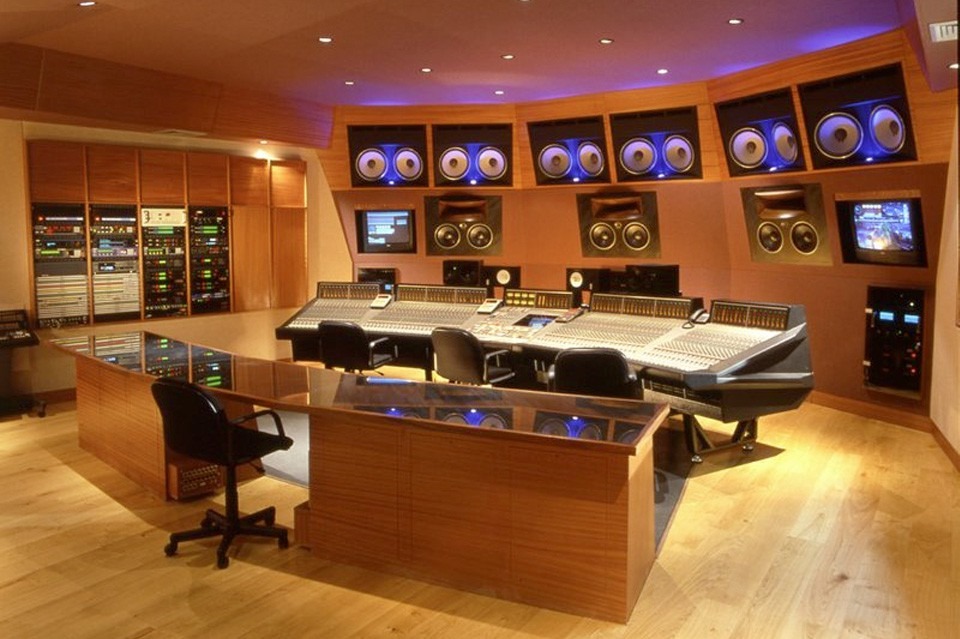

From some study i've done about this kind of config (but with TH-4001 instead of biradial) 500/600hz is the upper limit for 2x12", beyond that and there is serious lobing appearing from woofers configuration.
It kind of explained why i prefered the Kinoshita Rm7 ( d'appolito config) to the Rm4 ( 2x15" juxtaposed) i've heard. I felt the Rm4 were too directive at xover freq.
http://www.reyaudio.com/large-e.html
I spent time in front of another system using 2x12" and TH4001 and it was less severe issue with this but it was dsp filtered using much steeper slope and xed lower in freq ( circa 500hz iirc) which helped too.
See attached file.
Kind of explained the choices made about the Rey Audio's Warp monitors ( Kinoshita's baby too) were 12" are used instead of 15" and even lower xover freq at 420hz. And they are angled too ( Auspurger used same arrangement with their studio monitors too) in order to widen sweetspot.
http://www.reyaudio.com/warp-e.html

Is it safe to assume the dual driver layout in the Onken style cabs would be vertical ?
@krivium, thanks for the links. This angled design is way beyond my capabilities but definitely gives me something to research and perhaps copy a proven design. Leaning towards the dual 12's. I can experiment and drop my crossover down to 500Hz, the horn flare rate is 240Hz. Using LR 24dB slopes now, but I can also experiment here too.
