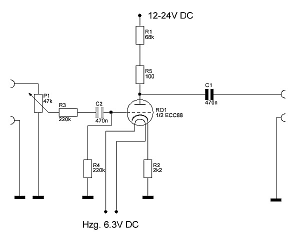

If its just for the tube sound, i simple 1-tube-buffer would be enough.

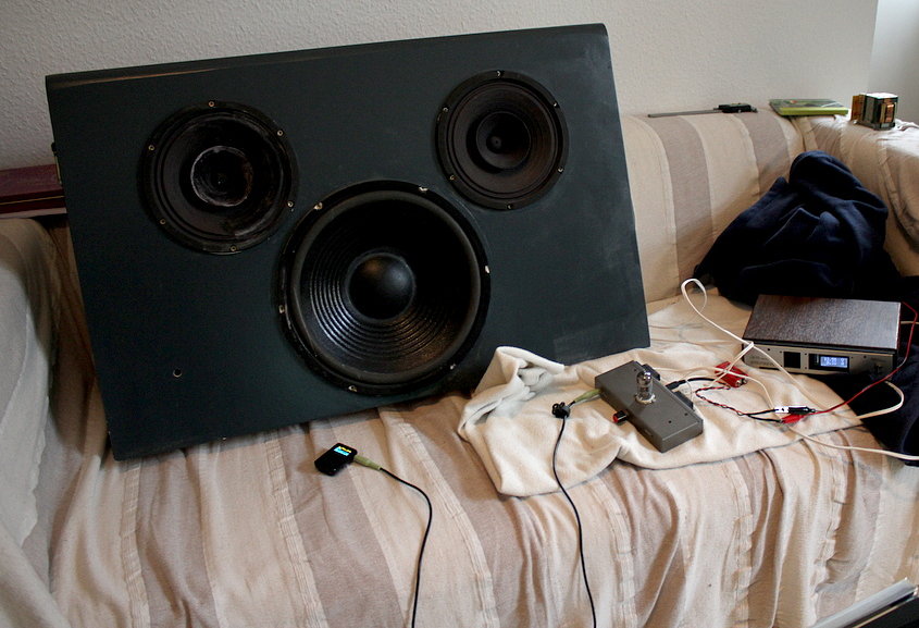

I first were like:
attachment.php
That gives:
attachment.php

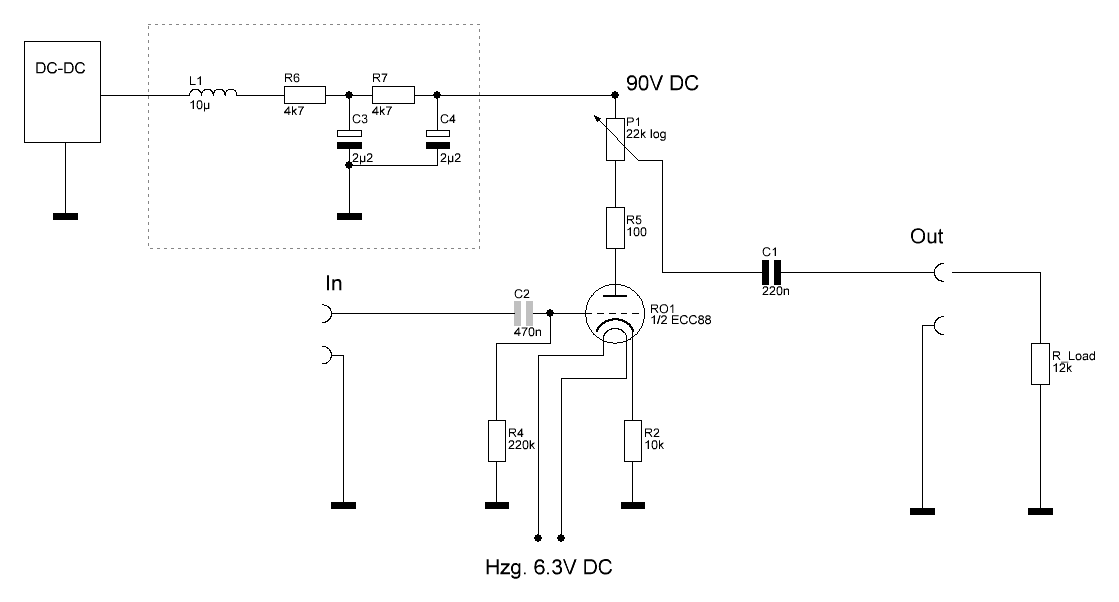

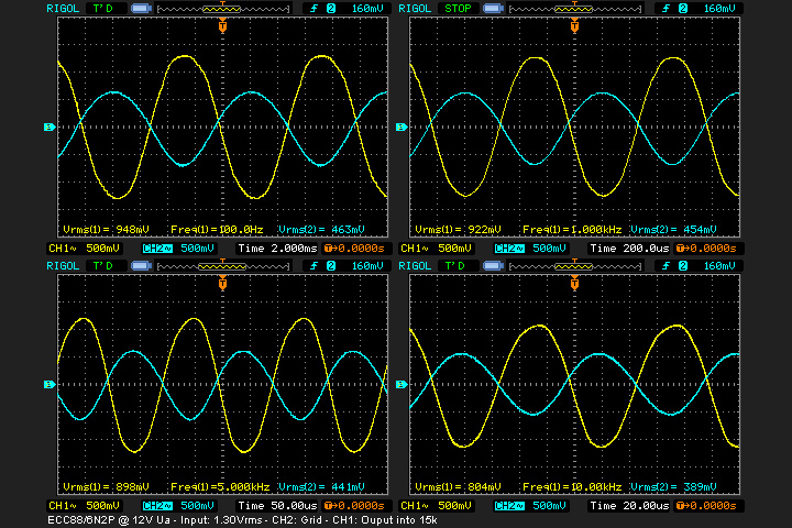

I then ended up here:
attachment.php
That gave:
attachment.php
attachment.php
ECC88 + MAX9704 Class-D (2x10) with 12VDC in for the Amp, Step-Up to 90V for the tube an 6.3V Step-Down for the heater.

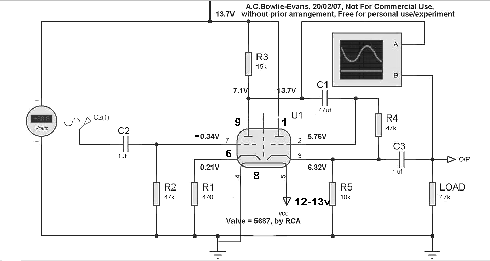

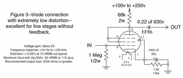

Ideas came from:
attachment.php
attachment.php
Thats why im asking.
