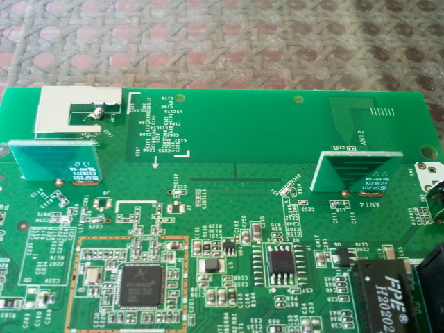

I have a wi fi extender with four on pcb internal antennas
But the signal I am getting from the free WiFi area beach is marginal. I am thinking of making a diy yagi antenna to boost the signal by about 10db but do I connect it to any internal antenna on the pcb?

Unless you can tap into a point that matches the 50 ohm coax feeding your antenna, you may loose more signal than your antenna can get you due to impedance mismatch.
Best are the units with detachable antennae...that you can work with.
There are many articles about "coffee can antennae" for wifi on the net and some of them may address the impedance mismatch issue.
Have fun.

Hmm good point. I guess the impedance match is with a capacitor?
At these frequencies anything with length can be an inductor and anything with area can be a capacitor.
And your impedance matching may require a couple of each.
I don't even consider trying this modification an option.
If you had a unit with a detachable antenna...

The other thing about Rf (besides the "anything with length can be an inductor and anything with area can be a capacitor") is that with inductance and capacitance come a characteristic impedance.
And if the characteristic impedance is not utilized correctly you can end up with an RF short circuit at a point that can measure open circuit with an ohmmeter.
The Circuit Designer had to match the impedance of the antennae to the transmitting and receiving devices. There might not be a point where the impedance matching networks transformed to a point where you can tap in with a 50ohm (or other) load.
You might not affect the circuit at all. Which is OK for the circuit but you will not be extracting any power to transmit with.
Or you may detune the existing circuit to either present a higher impedance load to the transmitting device and not get any power for transmitting or present a lower impedance and blow up the transmitting device.

And I only need like 10 db. As it is I need to stick the extender right on my balcony edge which is ugly otherwise it cannot connect inside the house. With the antenna the extender can stay inside.

Can't you get another WiFi adapter that has a detachable antenna?
