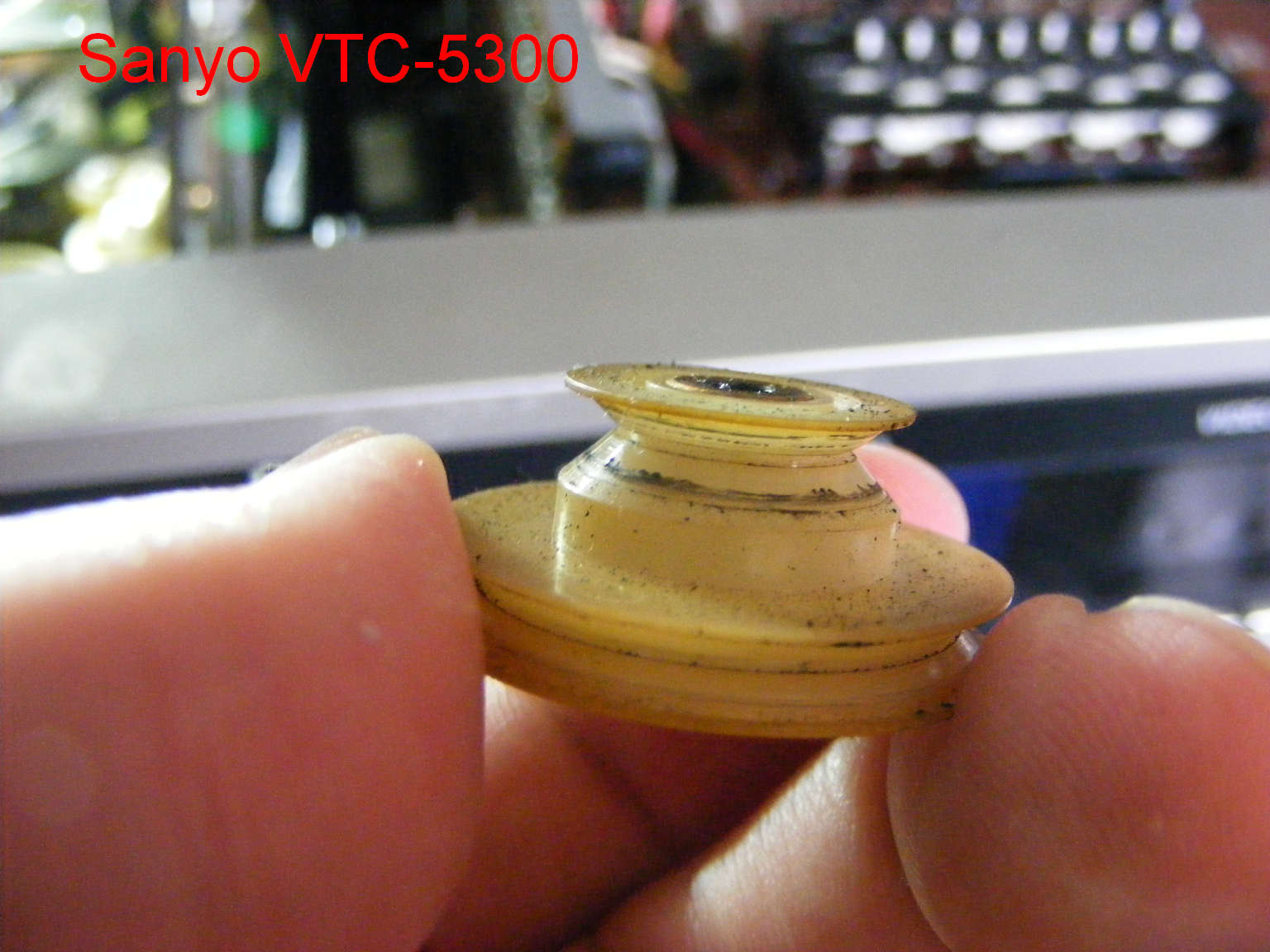

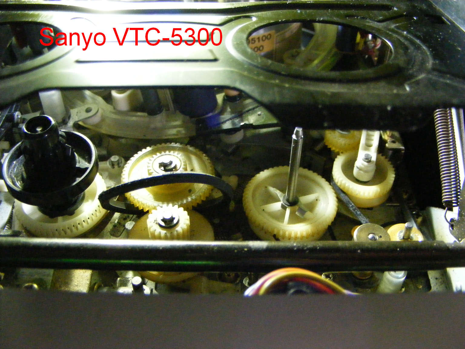

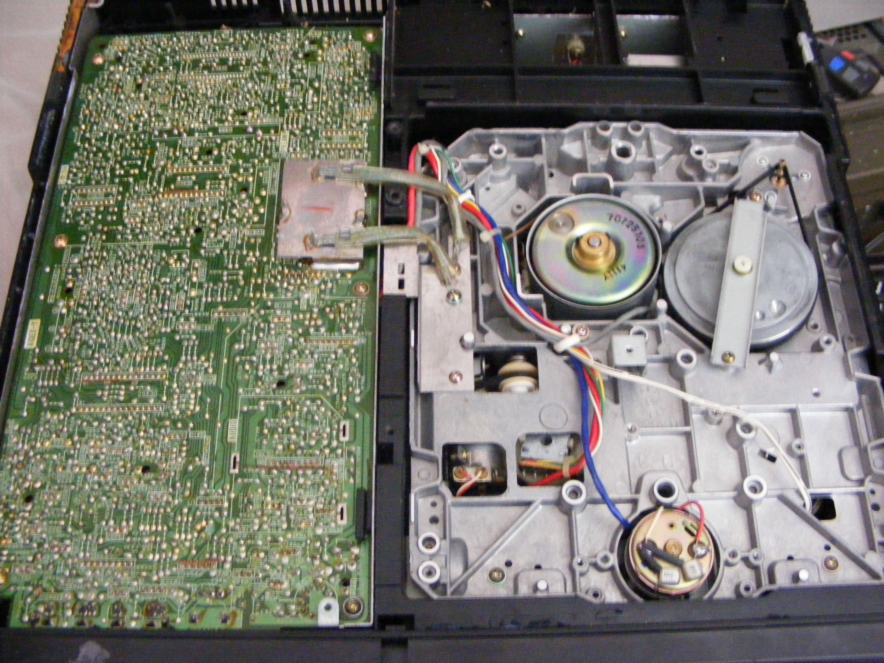

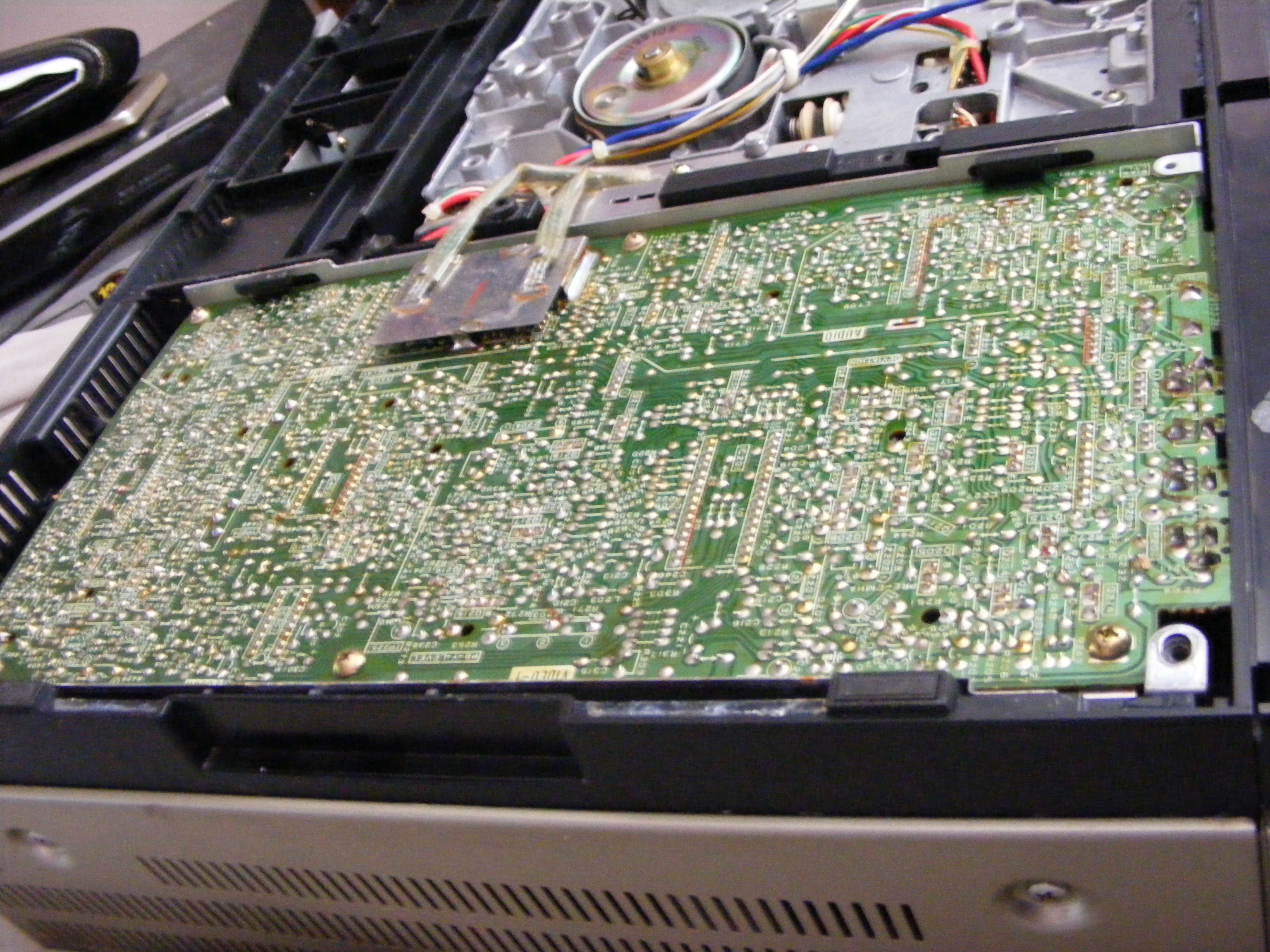

In other news I also got my Sanyo VTC-5300 Betamax deck today but that is broken too, this Sanyo VTC-5300 has a serious issue with the picture looking like it is speeding up and slowing down (but the tempo remains rock solid so the tape actually is not) and the color moves to the left and right of the screen very quickly. Anyway there were other issues with the deck also namely playback and rewind/fast forward so I took apart the gear mechanism and greased everything and reassembled everything but it didn't fix the problem. You would immediately think pinch roller and I must admit the pinch roller does look like its in pretty poor shape with lots of cracks, I'll have to measure it up to find a replacement tomorrow.
Anyway here is the Sanyo VTC-5300's problems:

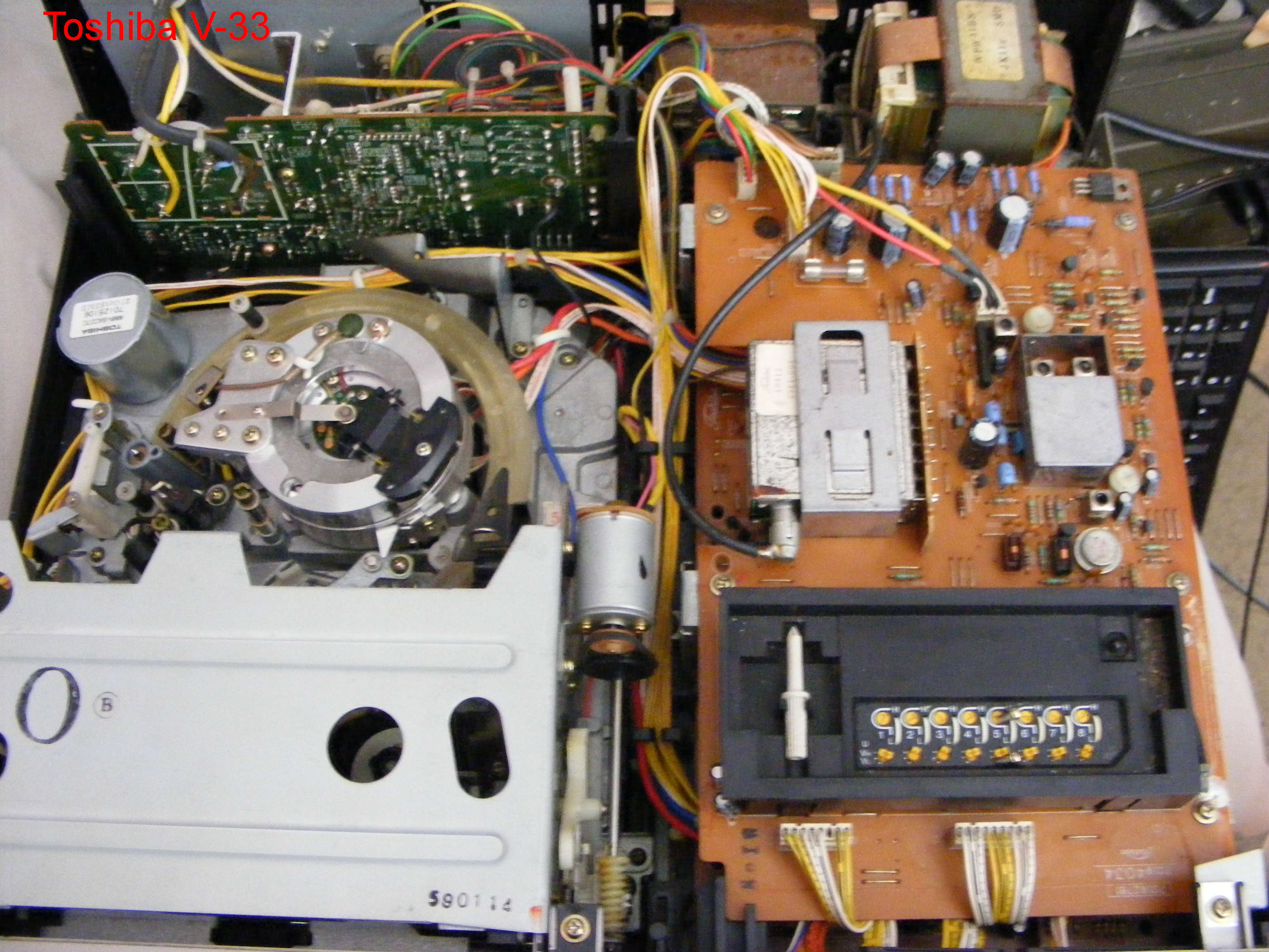

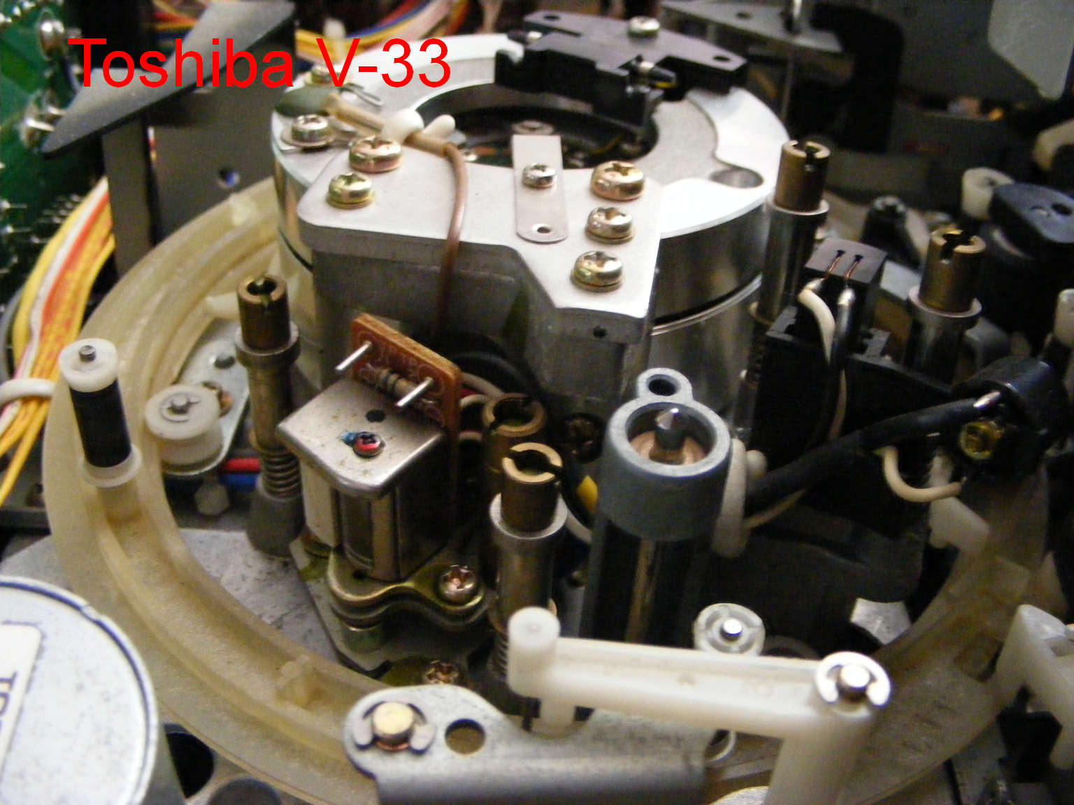

Kind-of fixed the Toshiba V-33 after cleaning it.
Here is a capture after cleaning it: VimeUhOh
Also after going out and buying the ISO this morning from Bunnings for $8 I did the Toshiba deck as well. On that I cleaned all of the rollers and I even removed the plastic tops off of the tape guides and cleaned the shaft of those too because I noticed that one of them wasn't spinning in the Toshiba deck and was kind of sticky to turn with my fingers. I also put a very small dab of Singer oil on the shaft of each one and put the plastic caps back on. They now all spin very freely.

Already cleaned the pinch roller and capstan of both machines, on the Sanyo I removed the entire capstan magnet assembly from beneath by simply removing the arm and pulling the magnet off then I cleaned the whole shaft with some baby wipes, I could do it again with isoprop but I think its sufficiently clean enough to count the capstan out as a source of issues.Venus, you need to make a dummy tape so that you can run the machine in Play/FF/REW and clean the capstan with the PR temporarily removed with a hint of brasso on a cotton bud.
I could pinch a pinch roller from an old discarded VHS deck and start doing that as a regular thing, wouldn't even need to buy pinch rollers then. I have an old AKAI VHS that I'm currently tossing out because of completely broken/fubar tape eject mechanisms.
In the Toshiba V-33 I also cleaned the entire head assembly with a tissue and isoprop and I noticed a small amount of oxidation came off of it but it was very clean to begin with, I suspect both the Toshiba V-33 and the Sanyo VTC-5300 were "serviced" by a golden screwdriver when they were down in Sydney before I got my hands on them because I noticed that the idler on both machines have this sticky substance on them almost like irremovable spilt ice cream or something AND I noticed a 1 Watt resistor was holding back a "guide roller" which has a spring on it and glides across the tape, I forget the names of things.One the capstan is clean of any oxide, use ISO on another cotton bud to surgically cleanse the capstan before refitting the PR.

The head on the Toshiba deck is visibly worn on the outside, not the worst I've ever seen but still fairly bad. As mentioned above I did go through it with isoprop and cleaned everything again and it did clear up the picture quite a bit. As things are right now it is in servicable condition.The first video shows tape dropouts most likely due to worn out heads but could also be wrong back tension.

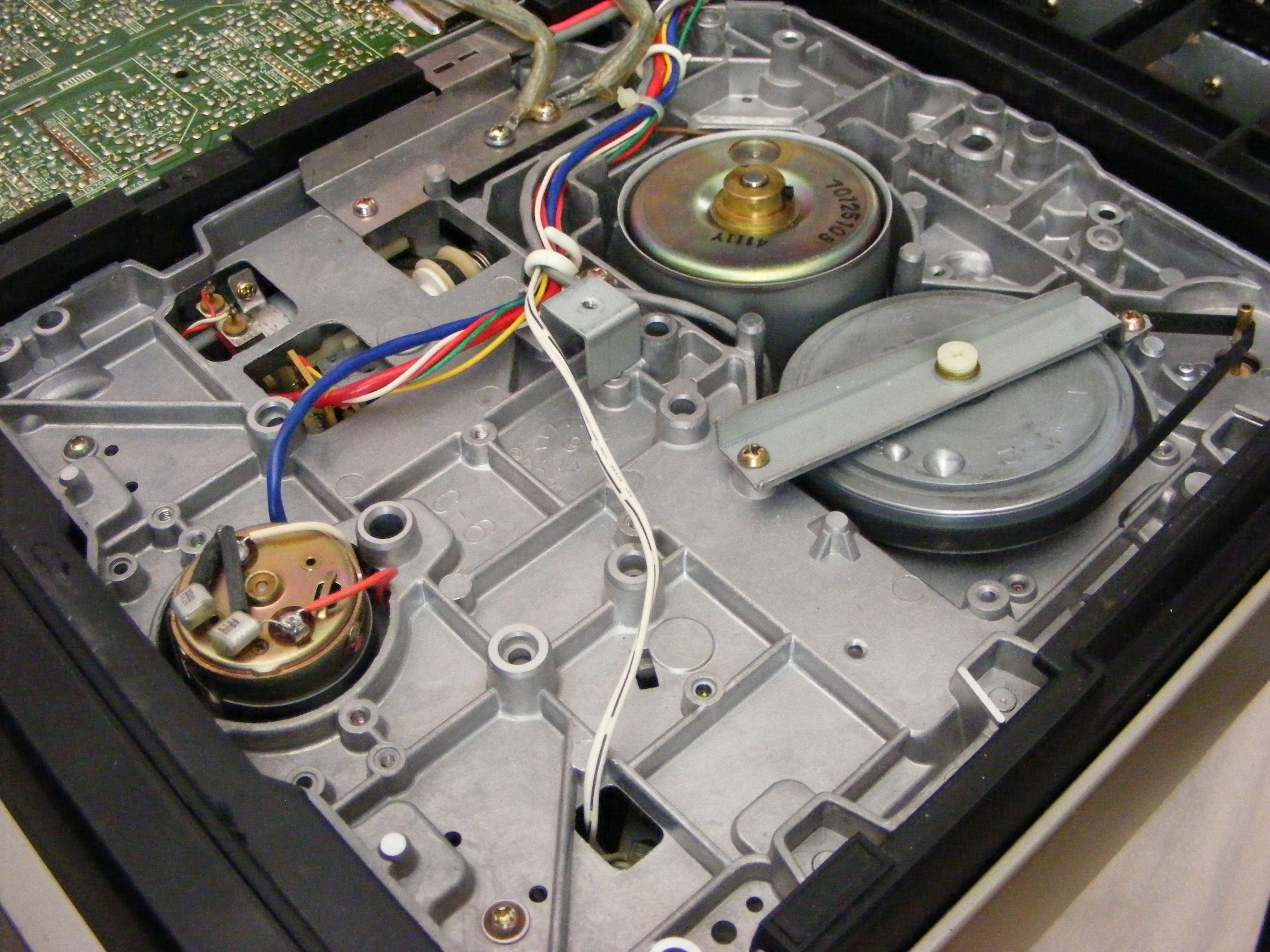

Rather strange I don't think my Toshiba deck has a tension band, its got brakes.The first rule of servicing these decks is DO NOT tweak the guides unless strictly necessary, and not until the whole tape path is pristine clean, new PR fitted and back tension band cleaned.
Yeah my dad told me that once a long time ago. Don't mess with the tensioners! I could clean them I guess as you say with a brush.Do not be tempted to adjust BT band, merely remove one end of the BT band, clean the plastic dust out of the felt with a cut back med size art brush and refit.

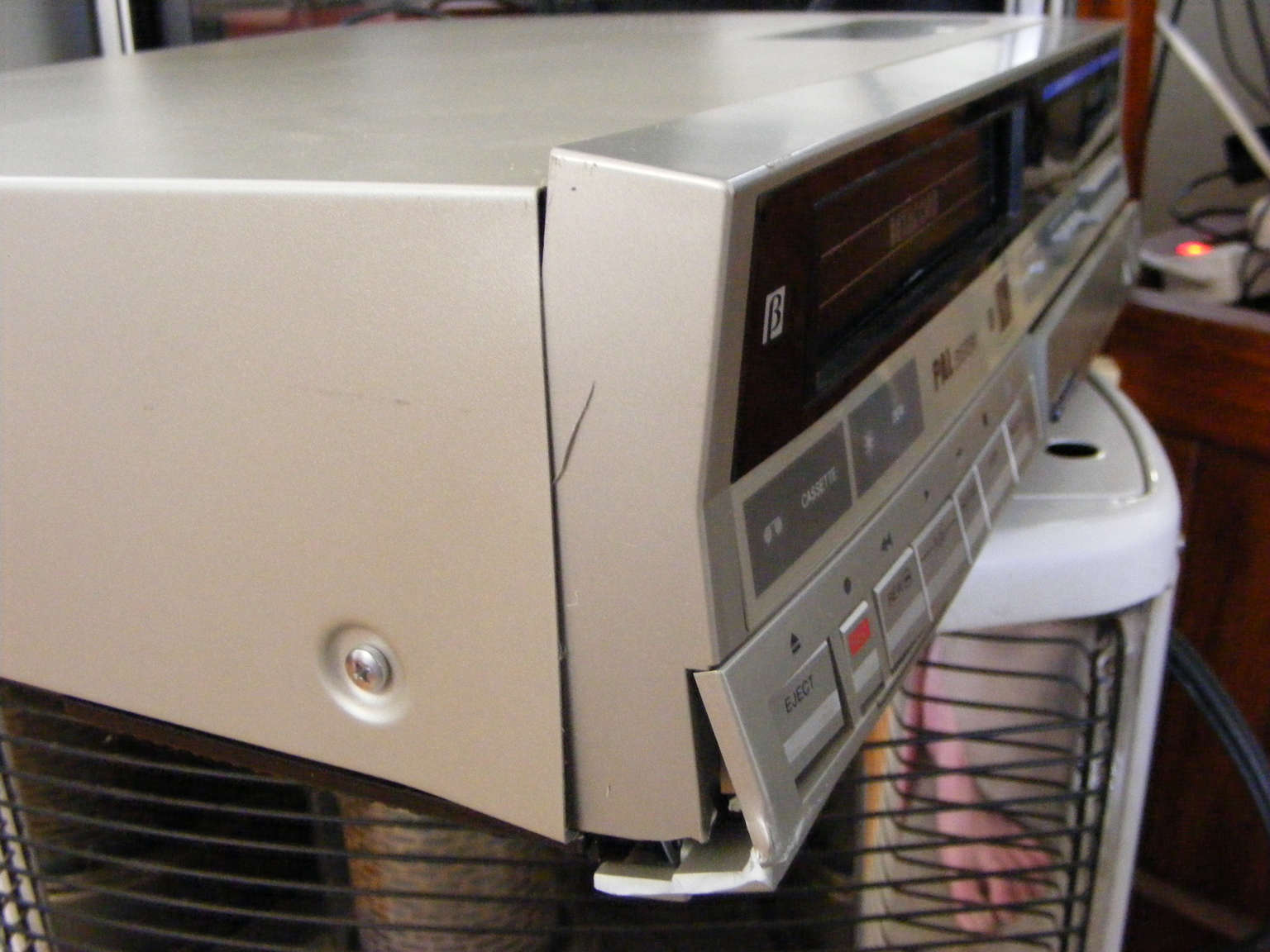

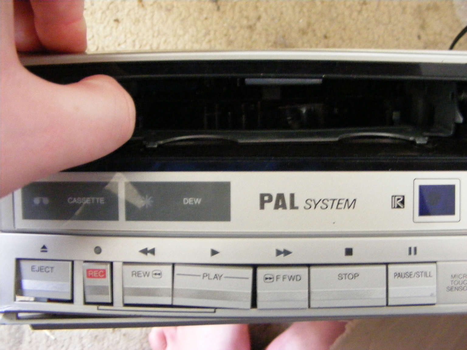

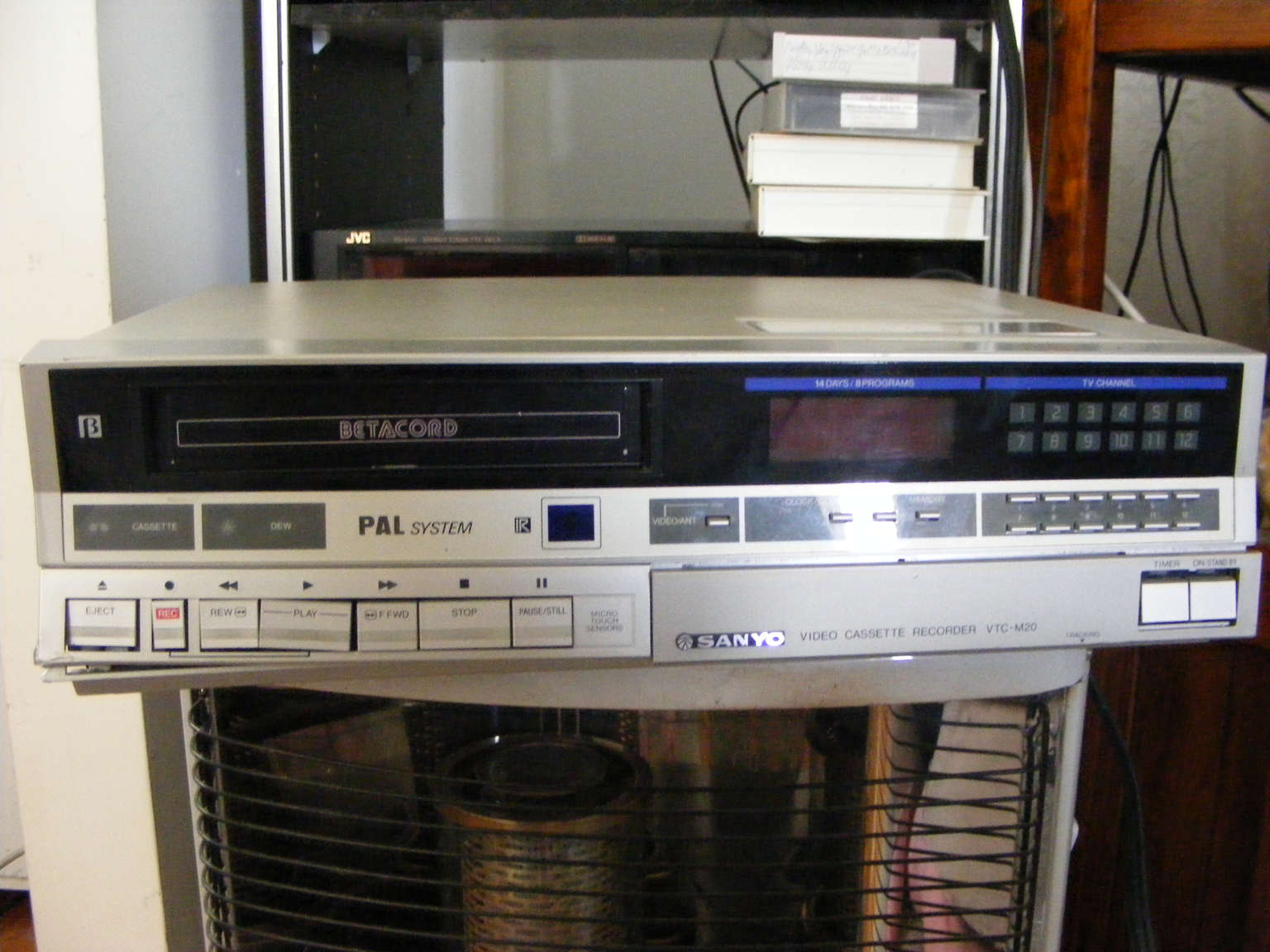

The mint condition Sanyo VTC-M20 has arrived with the front of the VCR all smashed up to hell like it was beaten to death with a ******* mallet. 😡
Needless to say there is no damage to the box that the VCR was shipped in and so therefore I am fuming like a god damn volcano right now.
EDIT: I found some damage inside of the box due to an impact. So the seller and the courier is to blame.
