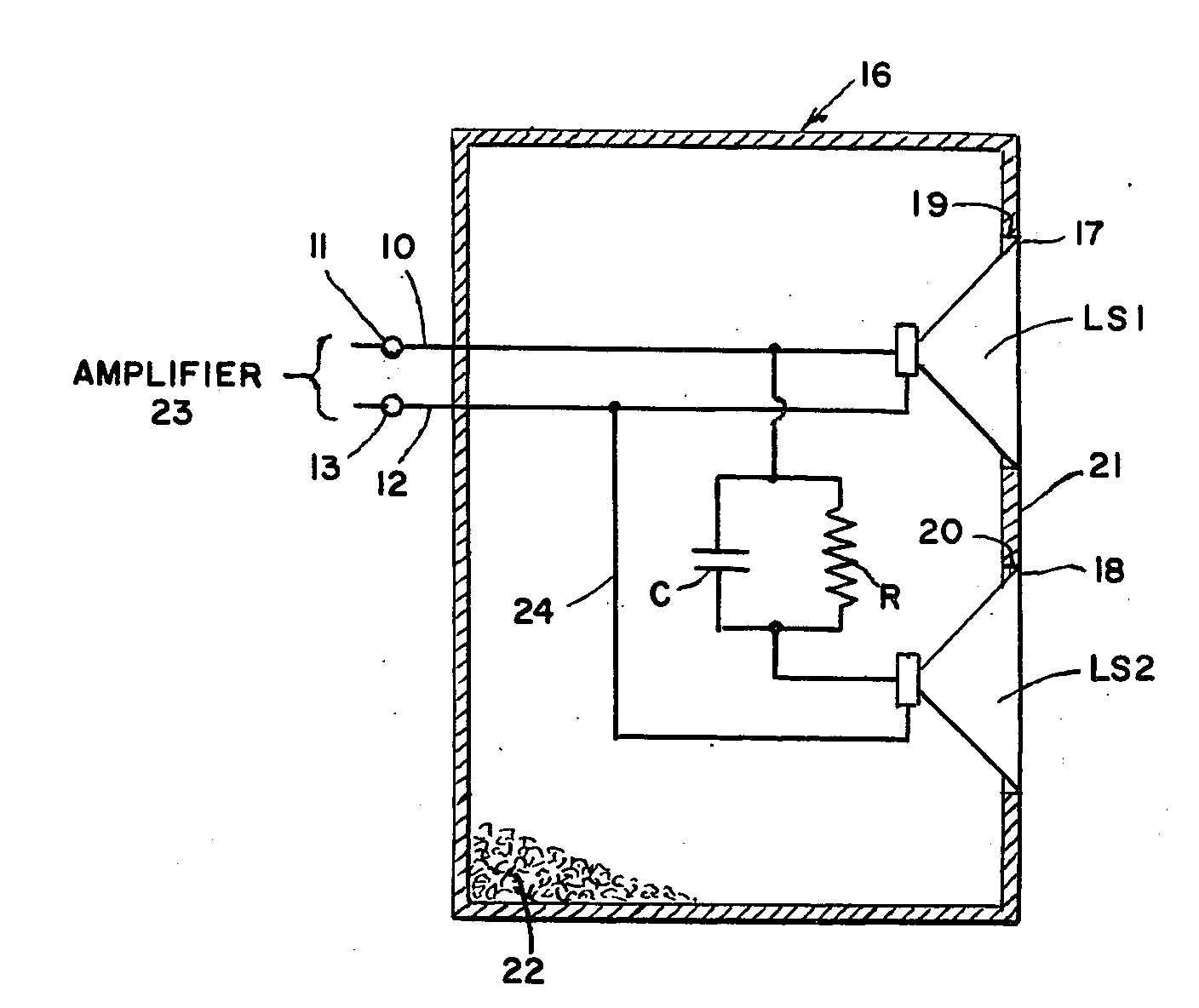

With the right TS parameters, the mid can be used synergistically with the woofer. There is a patent on this. I forget the number but it’s old. You have to choose suspension stiffness (Vas) such that the mid (more likely a large full range) is similar. For example, a W8-1722 is really a flappy full range and makes a nice mid. Then use a typical 8in woofer with Vas to fit the box volume. This could all be simulated in Akabak and would help to optimize driver choice. However, you will have Doppler distortion on the mid due to cone motion from bass and playing mids at same time. It might not be so bad though as that happens on a full range anyway when a big excursion happens. With the tweeter facing up, it’s more for ambiance so that mid will need to cover up to 12kHz.
A cheap way to try this might be a PA130-8 for the mid and DC130 for woofer with a cheap 1in silk dome for the tweeter. It could be done in a tall box like a conventional standmount to test the concept. A cube looks neat to try and uses less material.
You are referring to a Nestorovic Woofer System, but it works in a somewhat different way. In fact, all loudspeakers which used Nestorovic Woofer system (some Speakerlab models and of course Nestorovic Labs models) were 3-way and 4-drivers, with a genuine midrange driver and with (superficially looking) two woofers, with a different size. The larger woofer is partially woofer and partially a passive radiator, thanks to the crossover which is a part of the whole patented system.

Nestorovic woofer system
Patent seems to show 2-way as nominal case.
226387d1307621959-nestorovic-woofer-system-3984635-png
That illustration is Fig. 6 from the US patent 3,984,635 by Nestorovic and Modaferri, describing the woofer system only.
LS1 is a regular woofer (8" or 10"), and LS2 is a slightly bigger (10" or 12", respectively) woofer. Fig. 3 and Fig. 4 show frequency response and impedance respectively for frequencies below 200 Hz only.
I have never seen a 2-way loudspeaker with Nestorovic Woofer System (although I suspect that one older Celestion model used it), but yes, you are right, it can be made as a quasi-2-way system, only if it follows these steps:
1. Pick one good 6" midbass.
2. Pick one good 8" woofer with substantially lower resonant frequency (both from higher mass and much higher compliance) and connect one big capacitor C (and a optional parallel resistor R) serially to it, as in above illustration.
3. Design a low-pass filter for 6" midbass + 8" woofer/passive radiator, preferably at 2.5 - 3 kHz.
4. Pick one good tweeter and design a high-pass filter which complements above low-pass filter, to get flat overall frequency response.
So, it can work, but it is completely opposite to the system proposed by OP.
