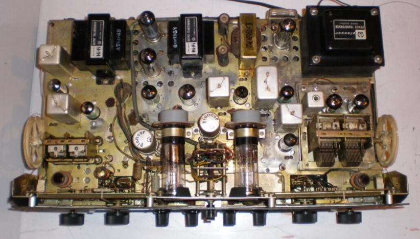

Here is another amp with dissimilar OPTs, Pioneer SM-Q140. You can see one is slightly smaller than the other.
I think there was a time when there was a different view of the potential take-up of Stereo. The Pioneer was designed to be used when the only stereo radio broadcasts were one channel on AM, and the other on FM, and in those days most people had mostly mono recordings.
