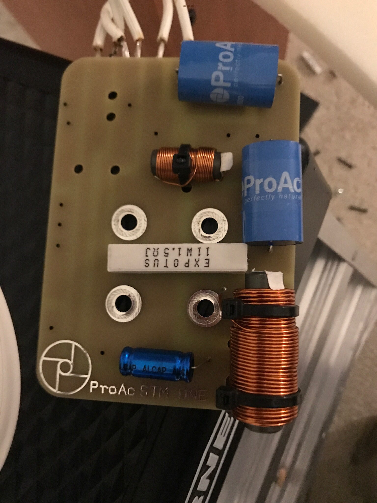

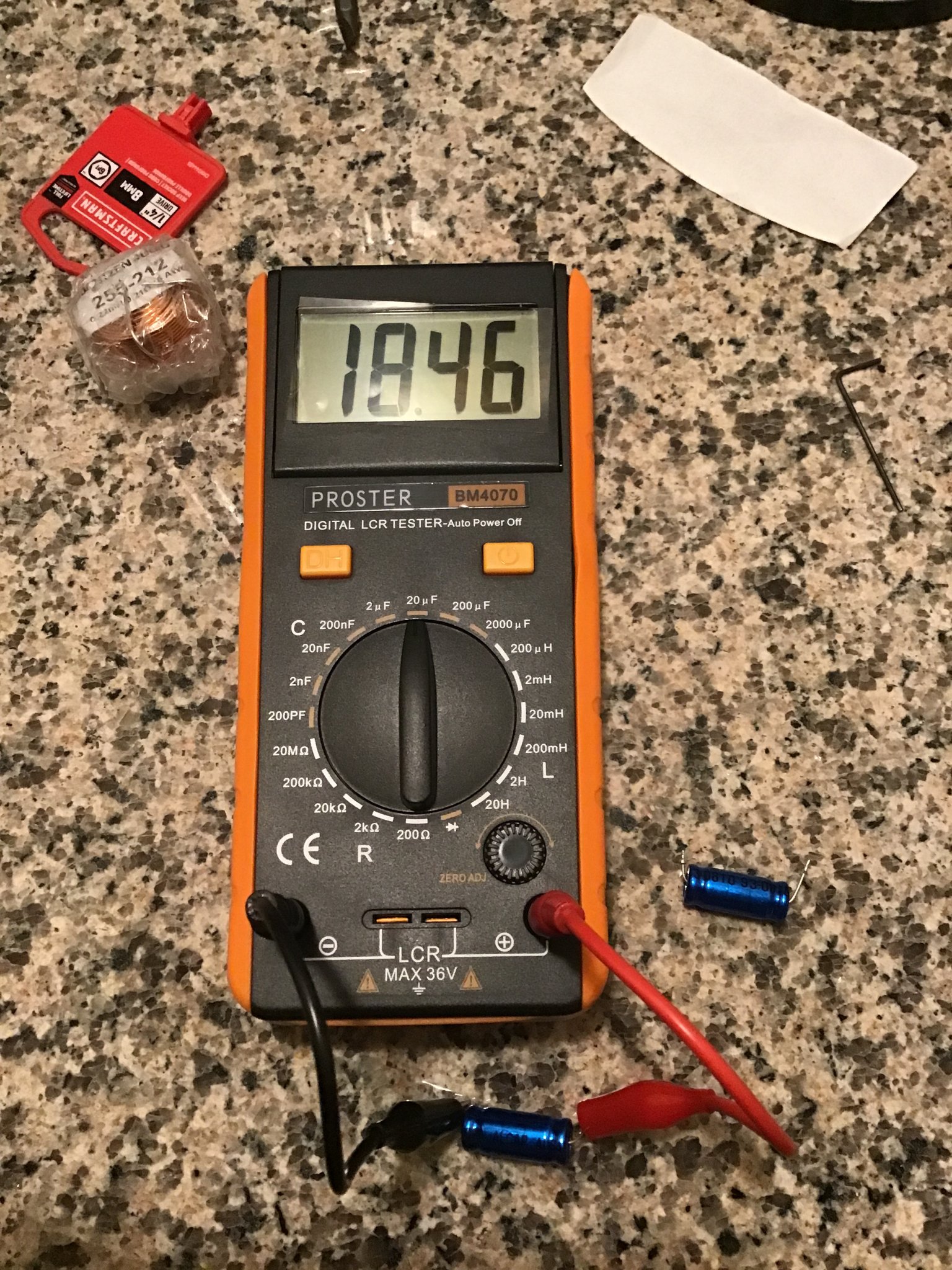

as some of you know , I am creating an external xo for my Proac DT8’s
I’m the xo woofer circuit there is an ALCAP 16uf cap, and on both speakers they measure a touch over 18uf.
im confused.
the woofer circuit has only an inductor and cap. Why would Proac put a cap in there that is +-10% ?
did they know these caps measured 18uf ?
was the design originally for a 16uf cap there but they just threw in a cap that measured a bit over 18uf?
im confused because i put in a Poly cap which reads 16uf and that value sounds quite a bit different than 18uf.
its not a bad sound but just different now that the woofer I’m assuming is crossing a bit higher.
i don’t get why someone would put in a cap that says 16uf but measures a bit over 18uf.

From a dealer.

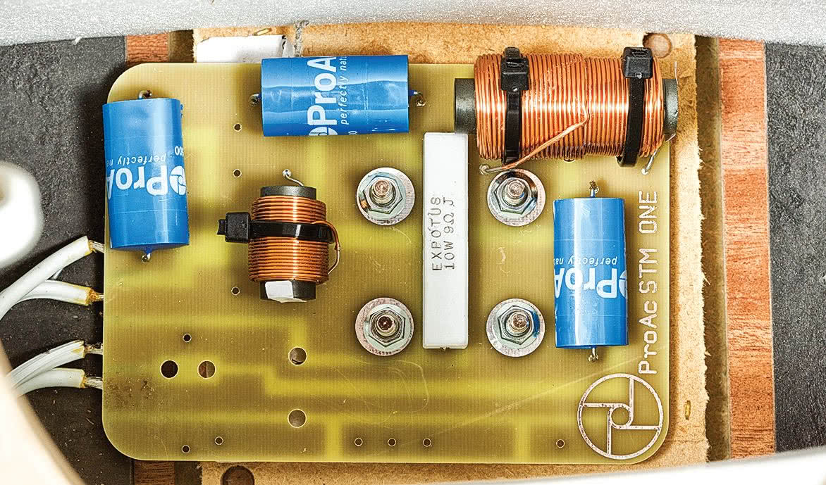

that pic you have isn’t the same speaker.
the electrolytic on mine says +-10%. So it’s a bit more
but I still don’t get why such a bit difference which is clearly audible.

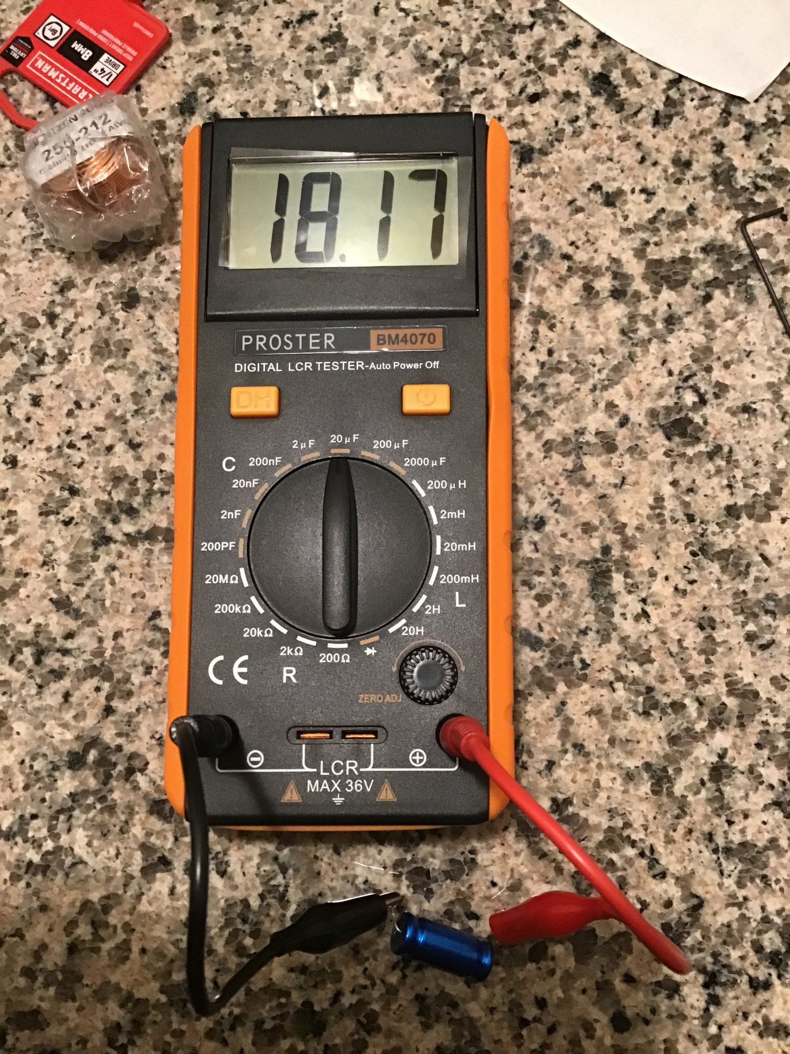

Seriously, it’s the other way around. KEF for one (at least used to) pick the exact value they need by measuring the cap, disregarding the value printed upon. An approach pretty normal when buying large quantities of certain parts. On the other hand: both your C-meter and the one at ProAc labs have each only to be 6-7 percent off, while the real value is about 17uF. Or your meter is really off. Compare it with another that also resolves the ESR.
everything else I measured with the meter is spot on.

The original cap (measuring 18 uF) is an Alcap electrolytic.

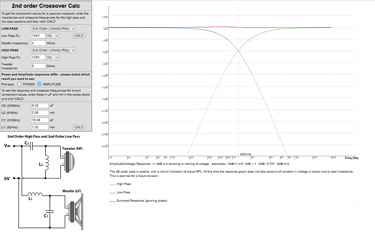

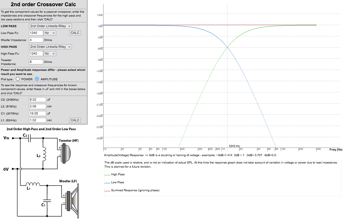

Using this calculator, which allows substitution of individual part values:
https://speakerwizard.co.uk/1st-and-2nd-order-crossover-calculator-and-response-simulator/
And with no idea of the your speakers actual crossover point or type (BW or LR), ran a few examples.
Though the examples assume fixed impedance and inductance for the drivers through the crossover region, (usually not valid), they do indicate little change from a 16 (design goal) to an 18.46uF woofer capacitor value.

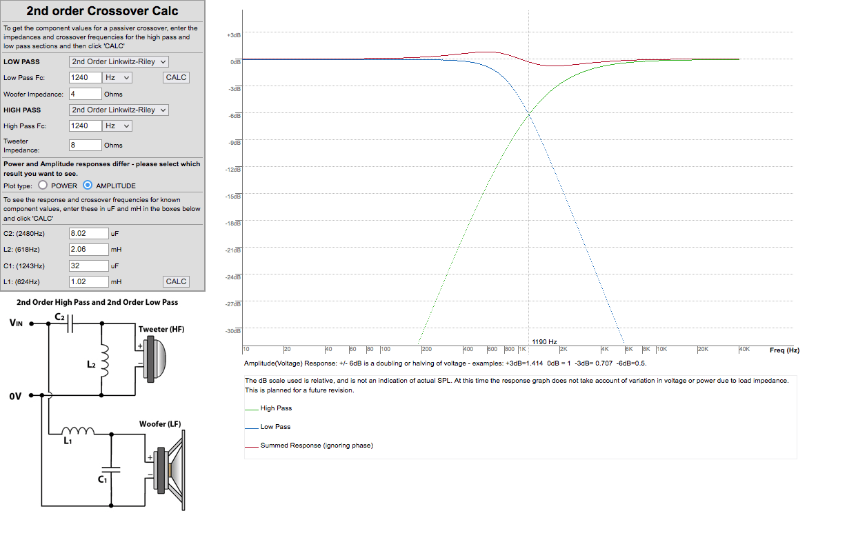

Doubling the value to 32uF makes the slight difference in what you are hearing more apparent.
Anyway, interesting to see what the "wrong" values might do.
Art
