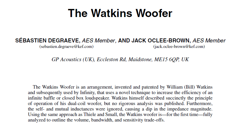

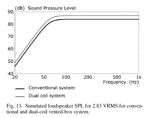

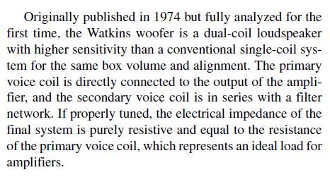

It is a pity indeed, perhaps opening the Watkins Woofer as a new thread. As the authors say, with the properly tuned filter the speaker now represents a purely resistive impedance to the amplifier.
And the authors have the CV to warrant paying attention.

I got a pair of Entec woofers... they use a servo circuit. I don't think they are dual coil, since that would require twice the amplifier power but the concept of using a dual coil to apply compensation to the main coil is quite interesting. I guess self powered woofer systems like the Entecs simply feed back the correction system into the input signal. Given the low frequencies ( long wave periods ) a sufficiently fast correction system is easy enough to concoct.
With a passive dual coil... would the amplifier then see half the load impedance? Assuming that both the mechanical load and the correction load both have the same impedance load ( just spread out over different frequencies ).
Would it be reasonable to dual amp each driver? On first blush, I don't think we'd want to do that for the Watkins Woofer since the main job of the second coil circuit is to "correct" the inductive loads to the amplifier., so the amp must see both loads in parallel.
But on further thought, I'd guess that the correction might be done at the mechanical level proper and dual amplifiers would work as well, so long as they are not affected by the power factor going into the speaker.
