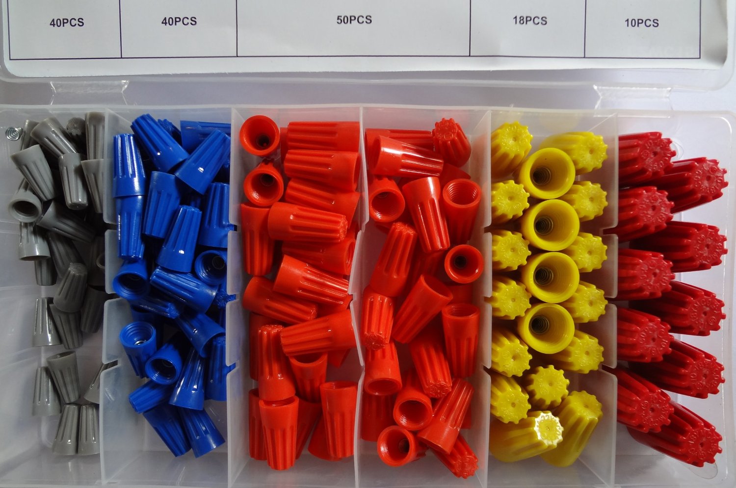

Why are wire nuts used, at least in the US, in junction boxes, switch boxes, outlet boxes, etc. for ac mains connections? why not crimp connectors as we use in our chassis?
I find them frustrating, especially when tying together 3 wires.
Agree, I have a section box with my collection of wire nuts. They come in many sizes. If you are tying three 12ga wires together, you need a nut designed for it.
They are cheap, reliable, installed without tools, and easily undone for changes or troubleshooting.
I find it baffling when a customer brings me an amp, where the wires to the speaker plug onto the board with a molex connector, yet they leave the connector on the board and cut the wires a couple inches out. ARRRGGGHHH! Just unplug the thing... I see wire nuts like that. A crimp is a splice, while a wire nut is a connector.
It is important to strip the wires to the correct length, and align the wires (lengthwise) into the wire nut. I've also found some brands far easier to use than others. My favorite is "Ideal" brand. Use the correct size for your application.
