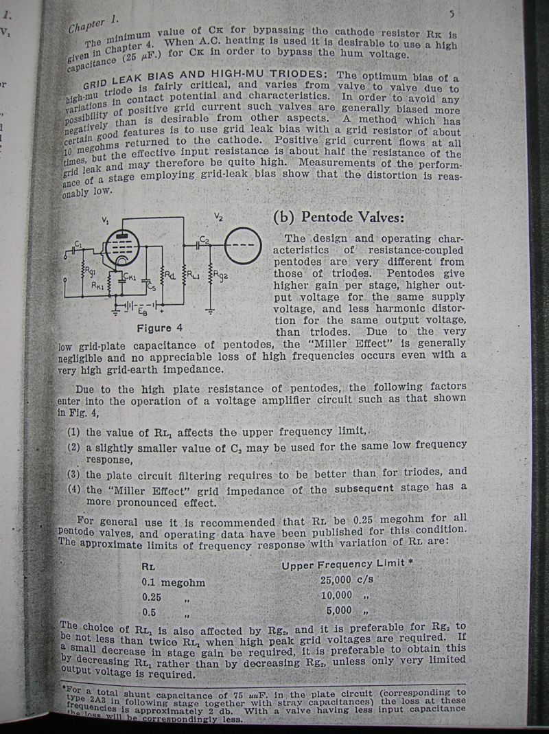

Perhaps a further extra - by now much belated. I had a graph somewhere (mislaid, I believe the nice term is for sloppy filing) indicating some 3x variation in distortion with the ratio of plate and screen voltages in a pentode RC application.
Then back to the original question for using pentodes as input stages. I don't recall the (lack of) Miller effect being mentioned. As a power amplifier input stage with an undefined feeding impedance - one often simply sees a 1M volume control there - I have found on accasion that a triode input can have an influence on NFB stability with the feeding impedance varying between say 200K and a few K.ohm. Again depending, Miller effect time constant can approximate that of some phase-correcting RC over the plate, making the h.f. stability plot less than desired. Perhaps not of prime concern, but another reason why I prefer using pentode inputs: Independence of feeding impedances.
