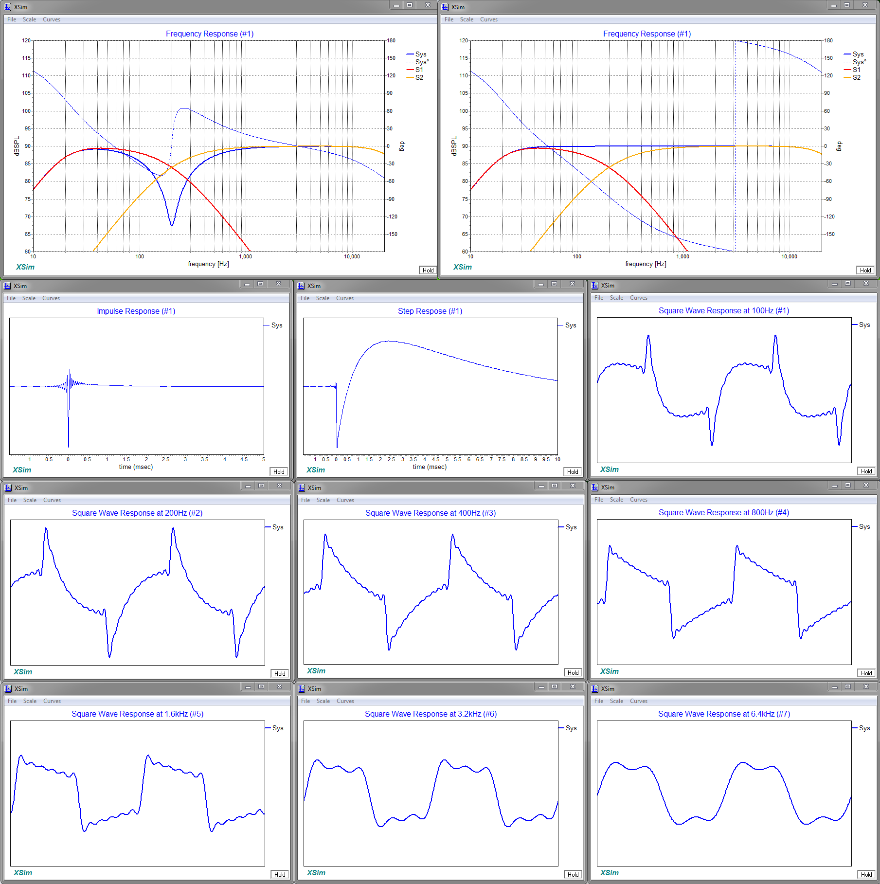

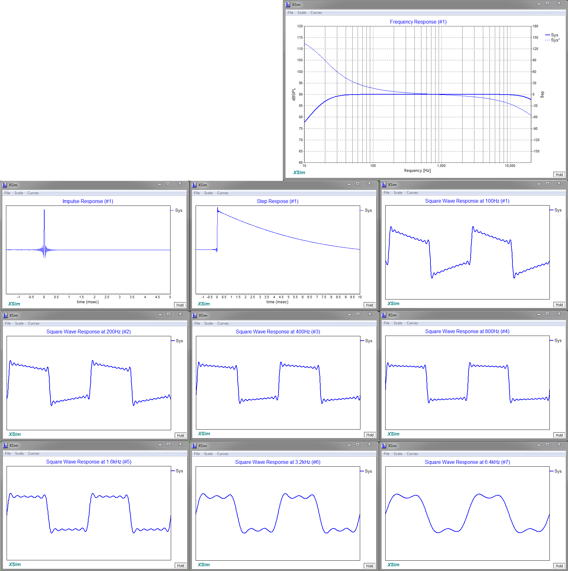

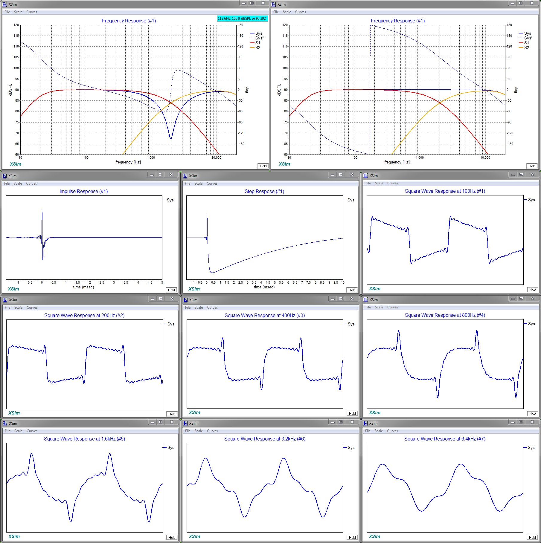

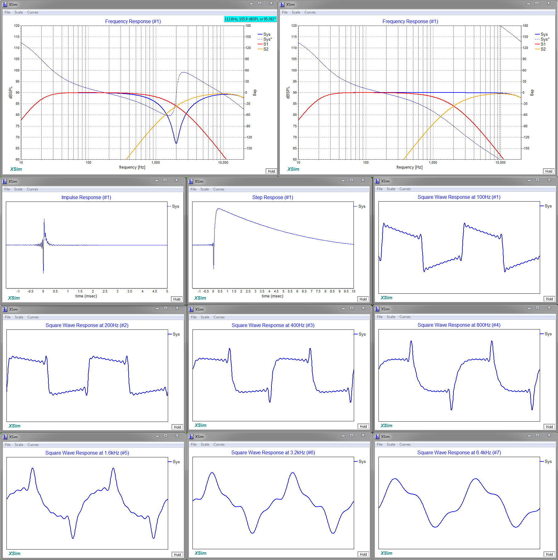

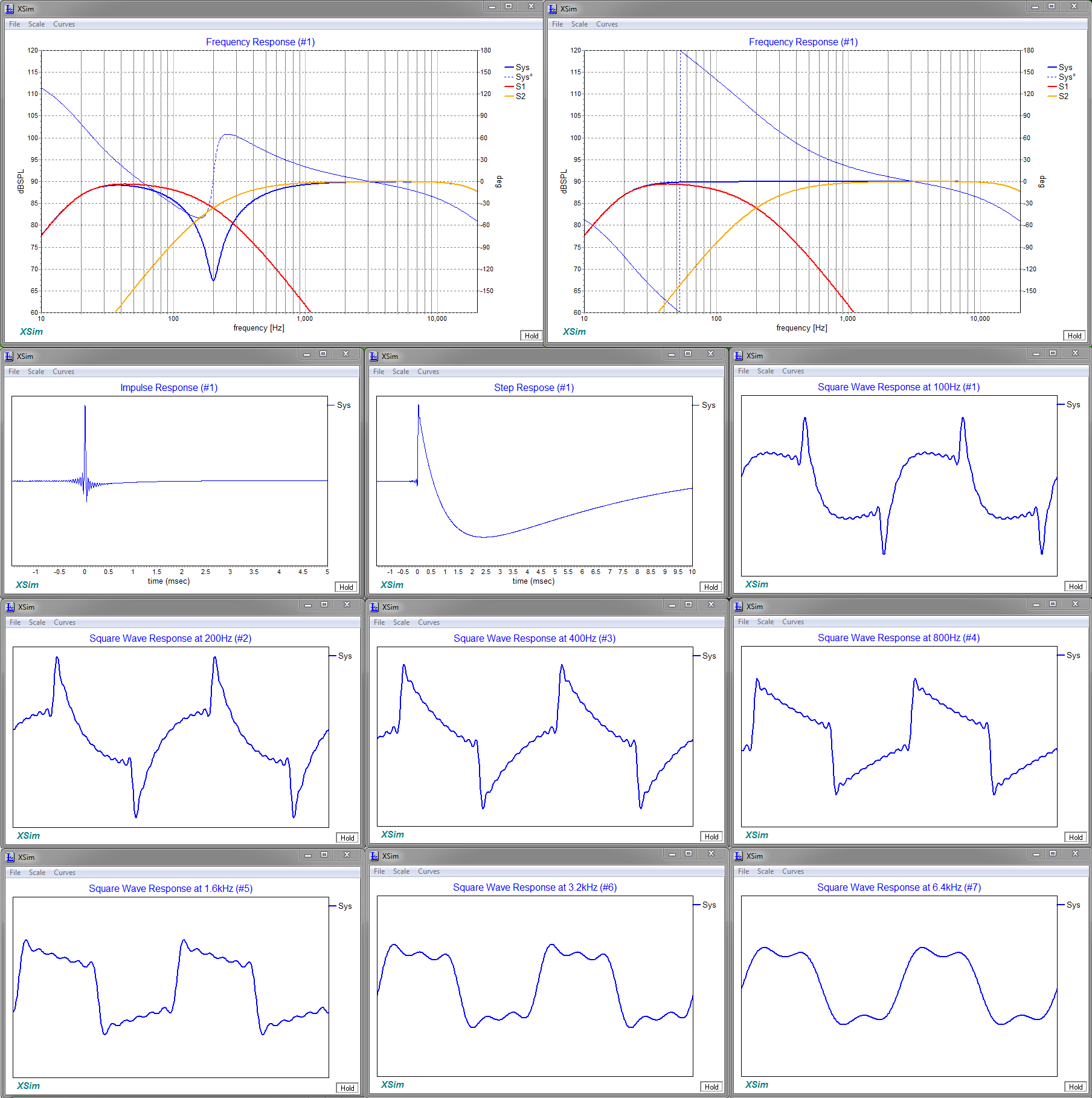

Her some on topic visuals how XSim see it for two-way second order LR XO.
Common for all five system stop bands is BW2 20Hz to BW2 22kHz.
1. Two way LR2 XO at 200Hz tweeter polarity reversed.
2. Two way LR2 XO at 200Hz woofer polarity reversed.
3. Two way LR2 XO at 2000Hz tweeter polarity reversed.
4. Two way LR2 XO at 2000Hz woofer polarity reversed.
5. One way with exemplary good full ranger : ) or lets say two or three-way system with FIR XO.
