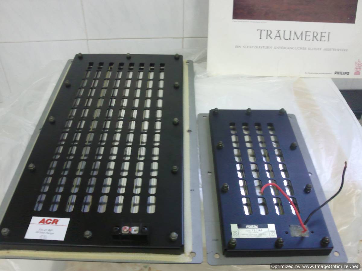

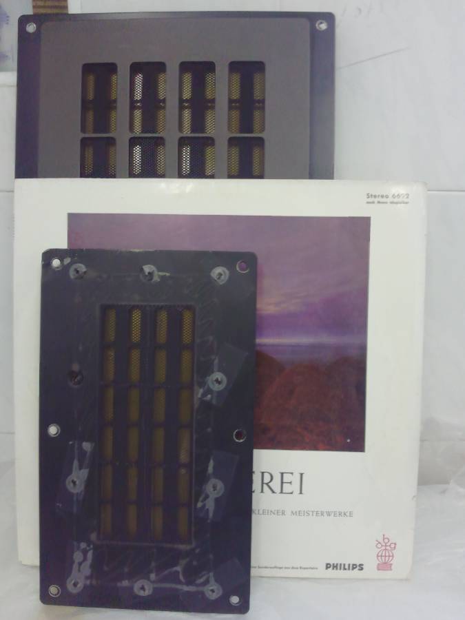

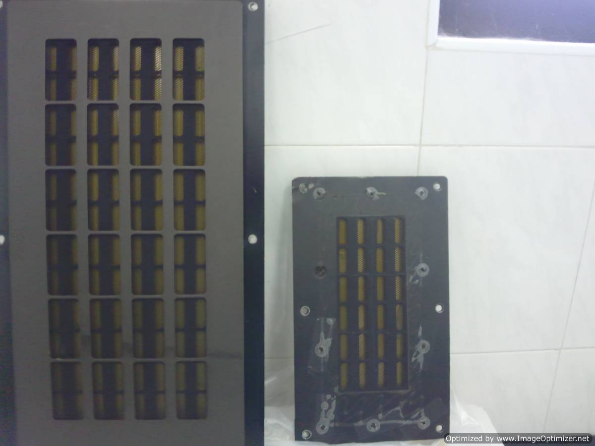

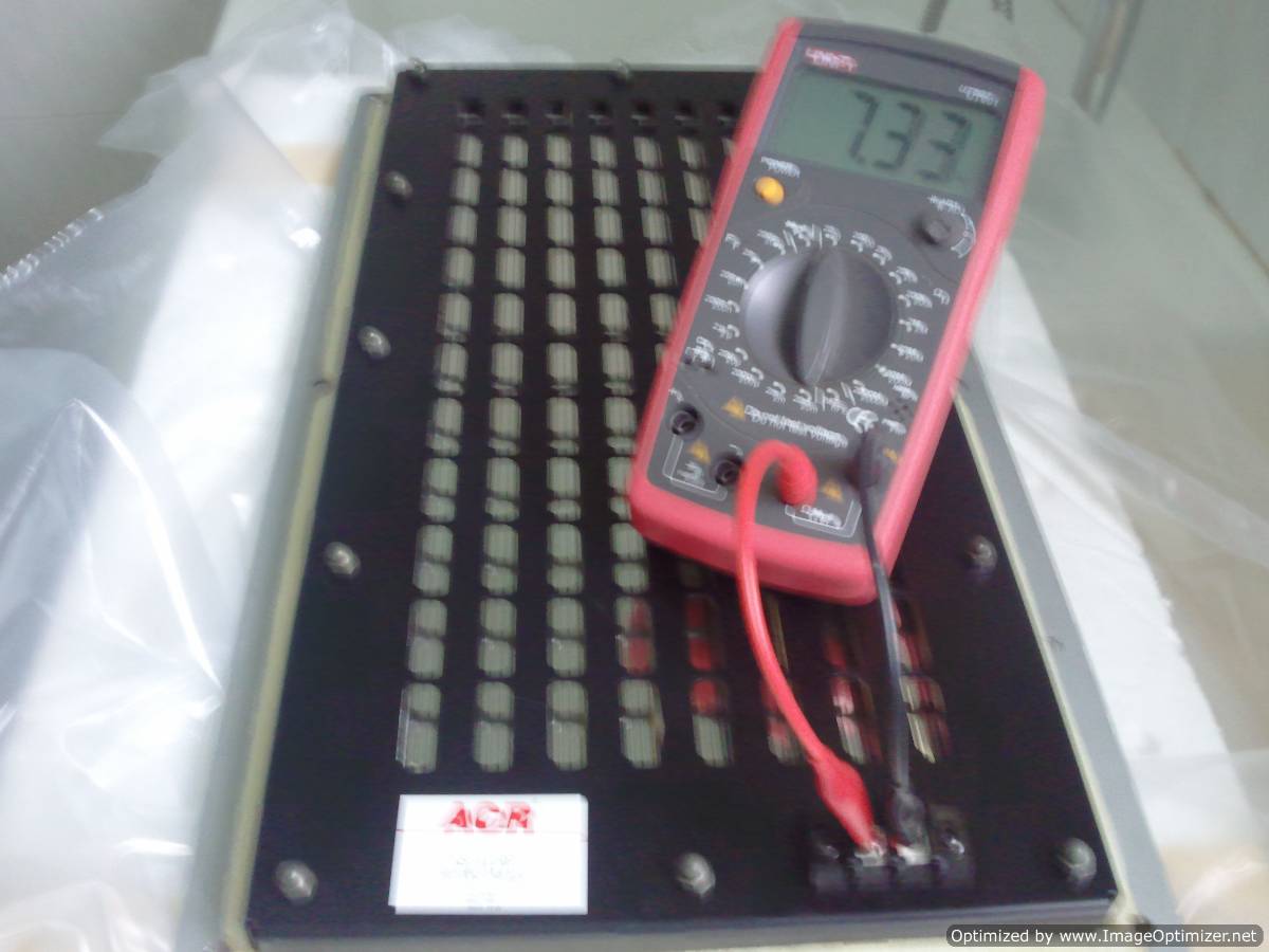

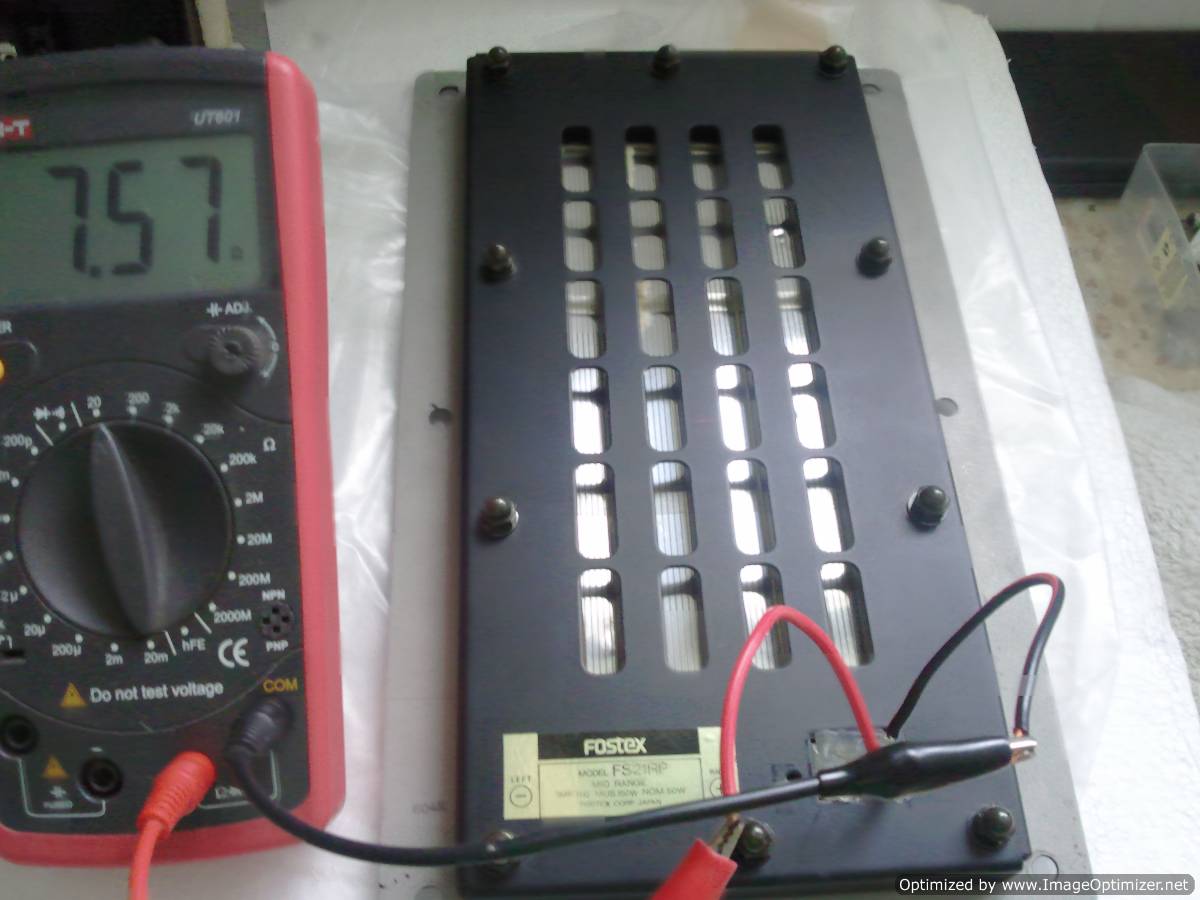

Got them both.
I have to say that the FS41 looks great.
5 kilos weight and the diaphragm tight as a drum some 30 years later!
I haven't seen any L-EMIM looking this tight!
