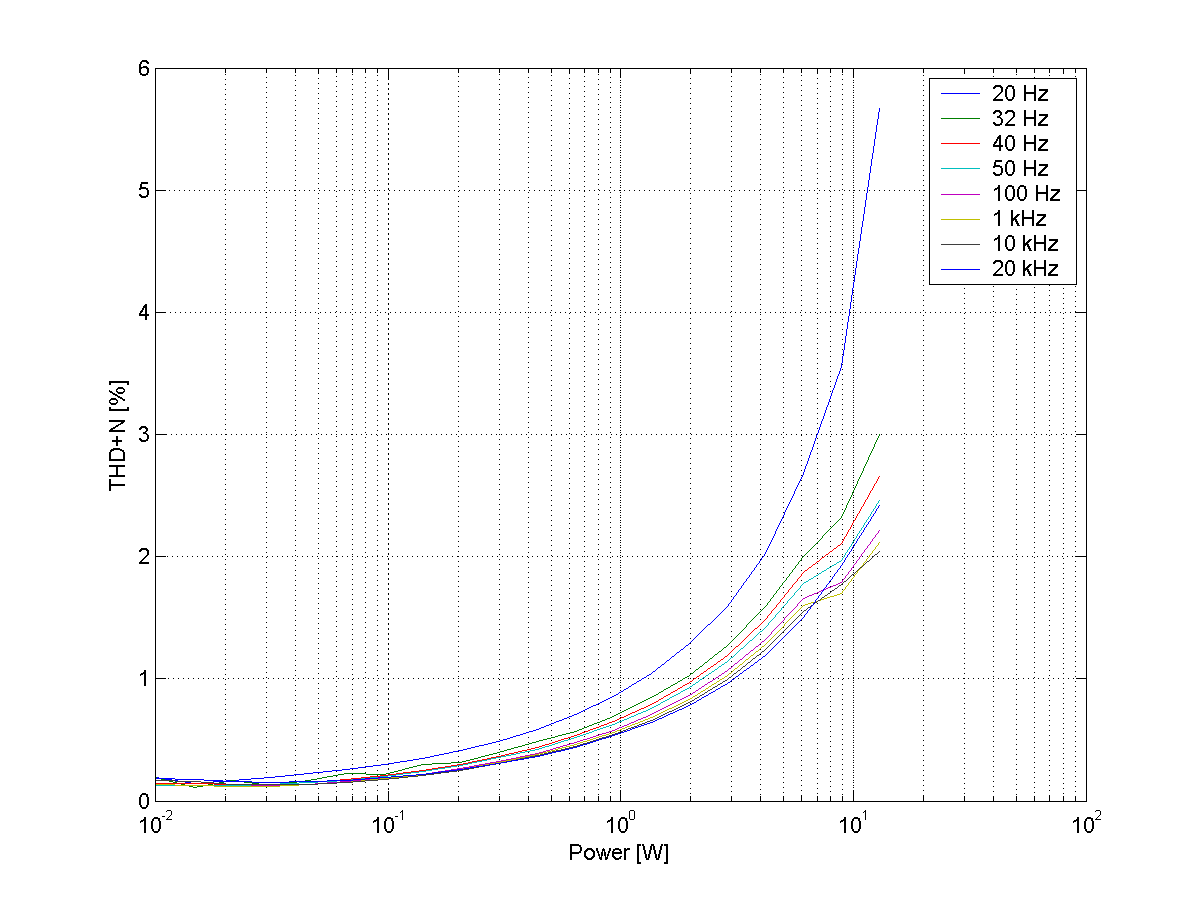

300B @ non-wimpy operating point
JJ 300B, 375 V anode-cathode, 100 mA, 4.2 kOhm OPT primary, resistive load.
Sounds fantastic also.

I wanted to run 400 V on the anode (cathode grounded), but my supply runs out of headroom at around 390 V on low AC supply (114 V). I set it at 385 V which leaves about 375 V across the 300B. It measures well and sounds sweet.
With just one channel running, I can get the supply to run at 400 V. I'm not noticing any difference in the sound quality between it and 385 V. It measures slightly better at the higher voltage - 0.60 % THD @ 400 V, 100 mA, 1 kHz, 1 W vs 0.66 % THD @ 385 V, 100 mA, 1 kHz, 1 W. The max power drops by maybe 0.25~0.5 W at the lower voltage. I kinda went meh.... Changing to a higher voltage would result in a significant redesign loop as I'm using a regulated supply and need to ensure that the front end of the supply can survive running without load at high AC mains voltage.
