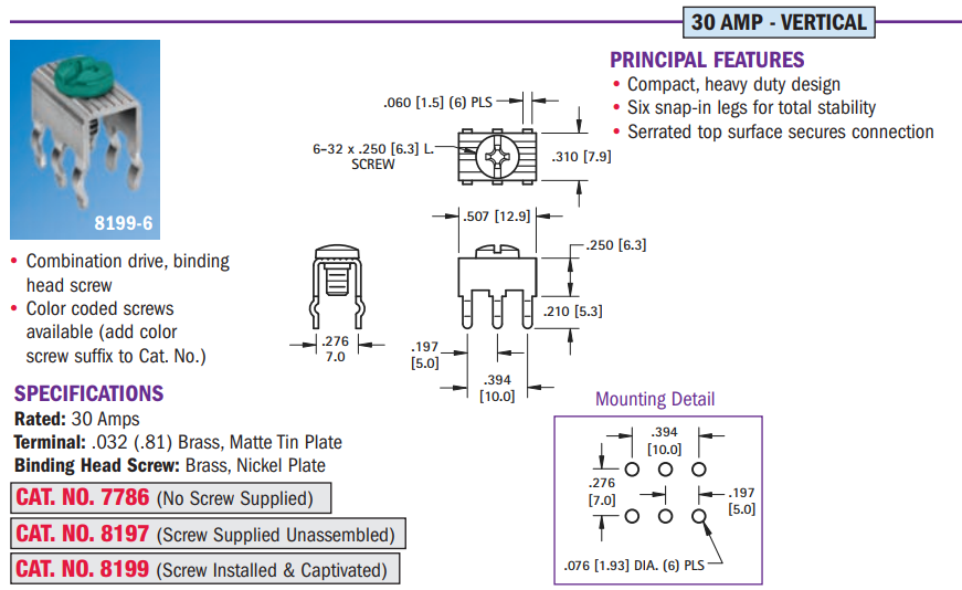

The Power Supply Soft Start Board V.3, sold in the diyAudio store, uses the extremely nice "Keystone 8197" connector. Picture below, link to Mouser sales page

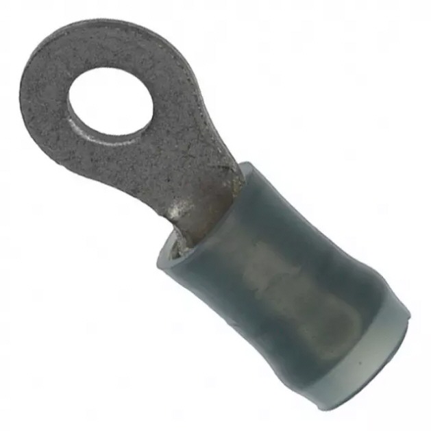

It's rated for 30 amperes, it's got six leads, it's got a screw terminal where you can attach either bare wire (boo!), or spade lugs (meh), or ring connectors (yay!).
_

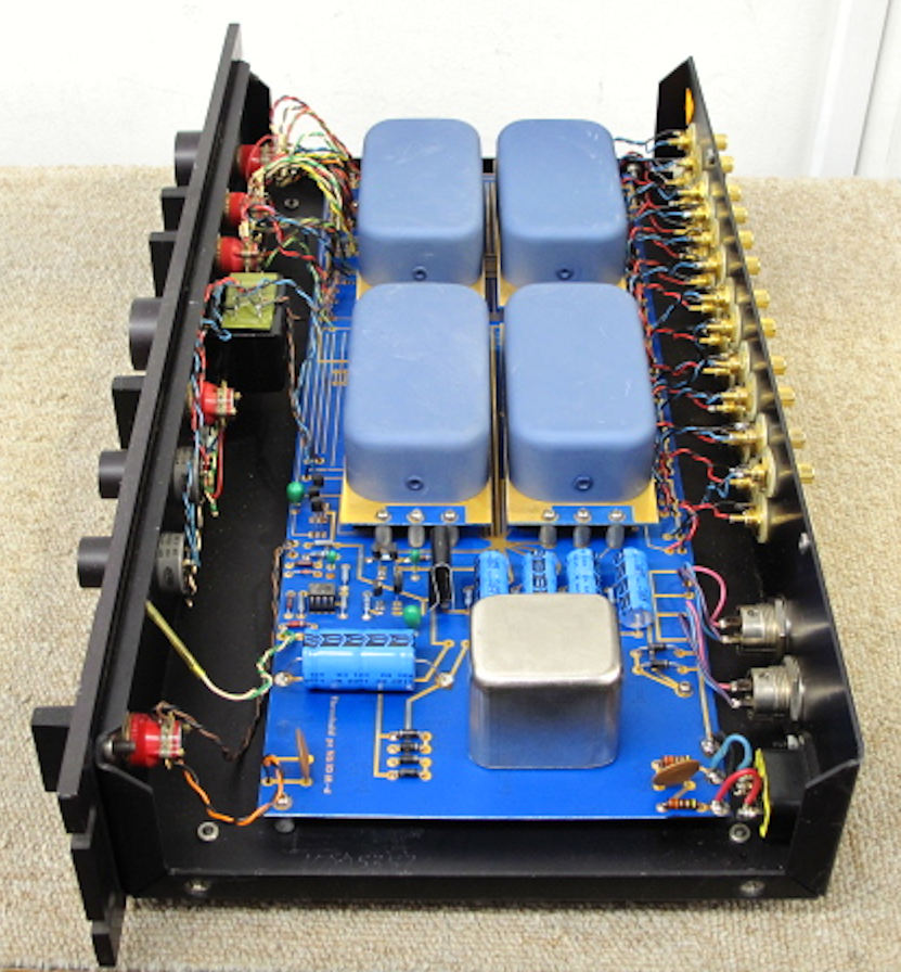

Behold the Threshold NS-10 preamplifier designed by Nelson Pass. The red and blue wires at bottom right, connect the AC mains (IEC inlet) to the PCB.
_
Of course, exception are Mr Pass' designs. 🙂
But again, his commercial designs aren't meant to be disassembled and reassembled frequently.
There are exceptions of course... This is clearly done to avoid making audiophiles nervous by having too many connectors in the "signal path"...
The way the IEC connector is wired is perfectly acceptable from a safety viewpoint. Repairing this thing is going to be cumbersome because of the many solder joints that have to be undone before the board can be taken out.

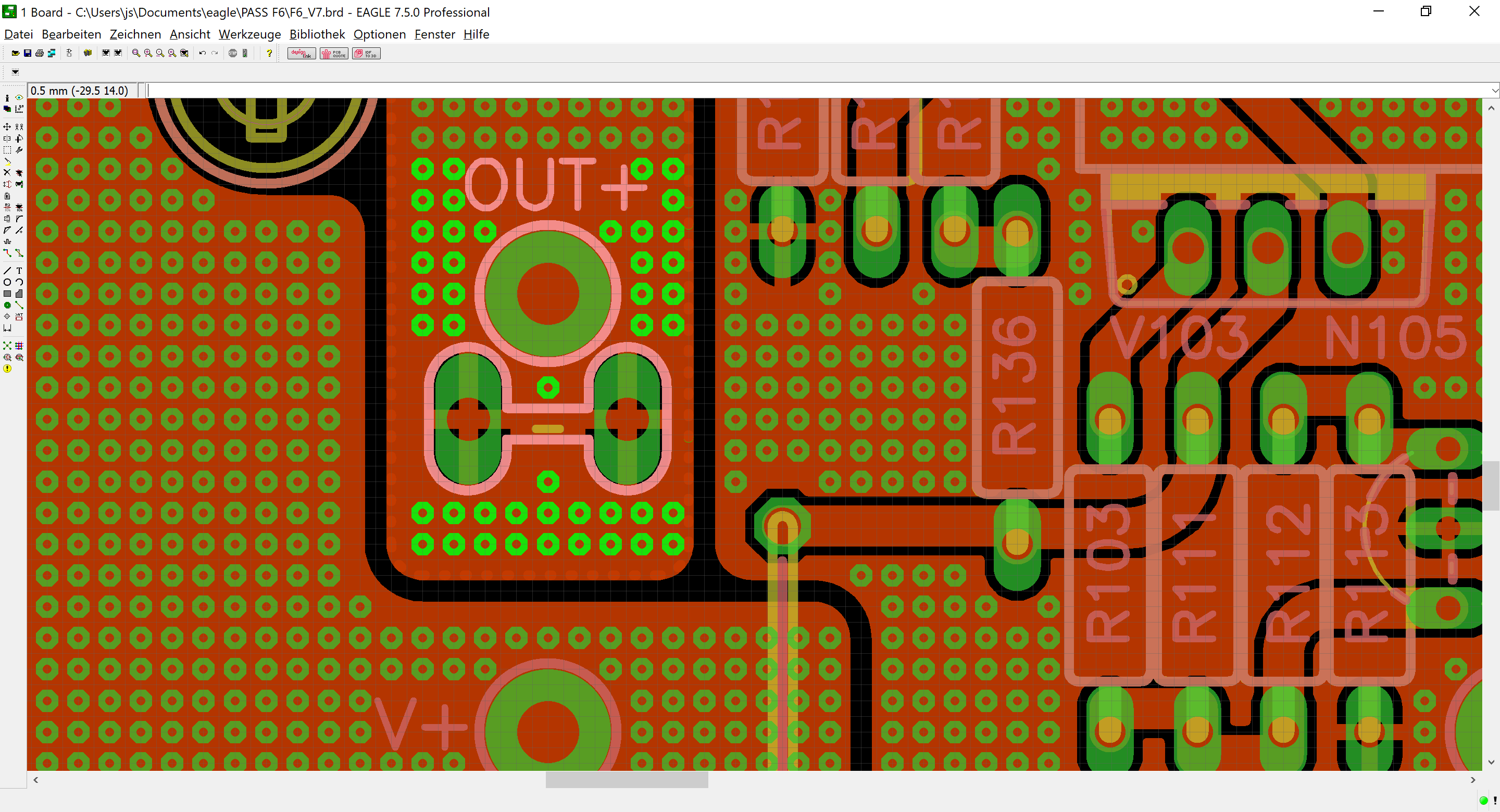

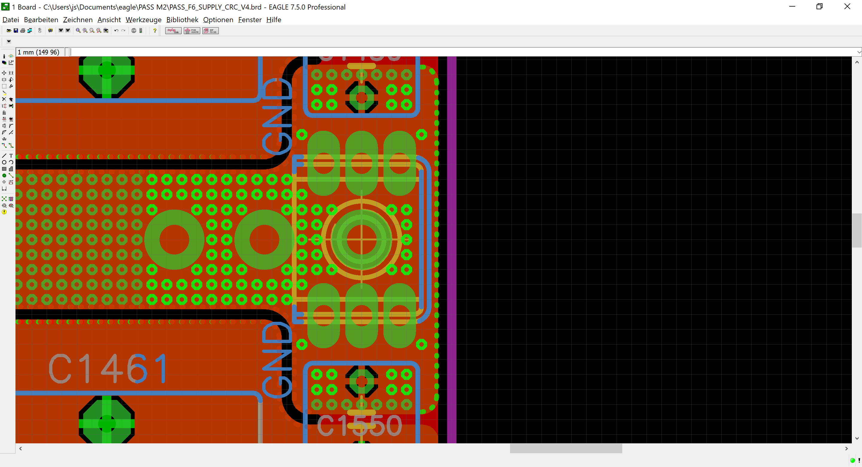

The biggest problem with a spade terminal is that its electrical fuction (solder conductivity to the PCB) and mechanical fuction (solder holding it on the PCB) are not separated. It is not able to withhold much stress, the solder joint will break after a couple of connection cycles. Sometimes it happens by itself, if the thermal expansion constant is different from that of the solder. A hardly visible crack may occur that is very difficult to troubleshoot.
This is a problem shared with many components which are heavy or in another way subjected to mechanical loads. Think of any type of connector, heavy transformers, switches, encoders and pots and whatnot. Also parts that double as board mounts have this issue, think of boardmount RCA connectors that have a screw for mounting it to a panel. The board is then supported by the connector, and thus ultimately from its solder joints. A similar thing happens with some BNC connectors.
A good way to deal with this is to always use a double sided PCB, and solder the thing on both sides. Also, take care of sufficient copper area around the part on both sides. Ultimately, it is the adhesive between board and copper that keeps the part in place.
Great solution. I wish everyone designing a layout in this forum would do this. Especially the DIYA Store PCBs of Pass amps.
