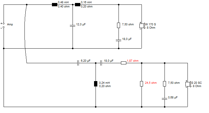

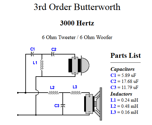

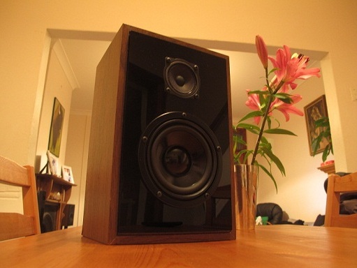

A couple of things up front: I'm no audiophile and I'm new to building my own speakers. With those caveats in mind, can someone answer a question that's been bugging me since I started researching DIY speaker building: why is everyone striving for flat freqquency responses, since that isn't how our hearing works?

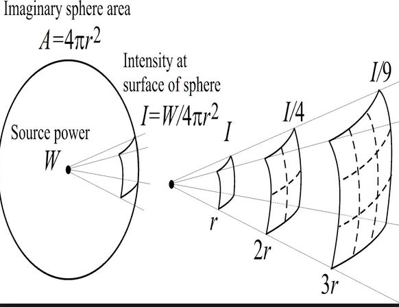

Things are much harder in a room. Dispersion falls off as inverse square. So you need much bigger woofers than tweeters. Hence your 2 way typical big woofer and tiny tweeter. It's a question of spherical waves falling off as inverse square.

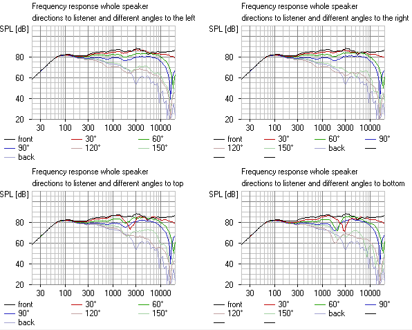

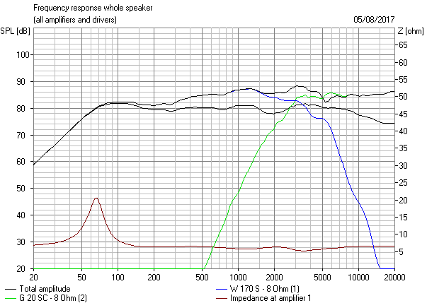

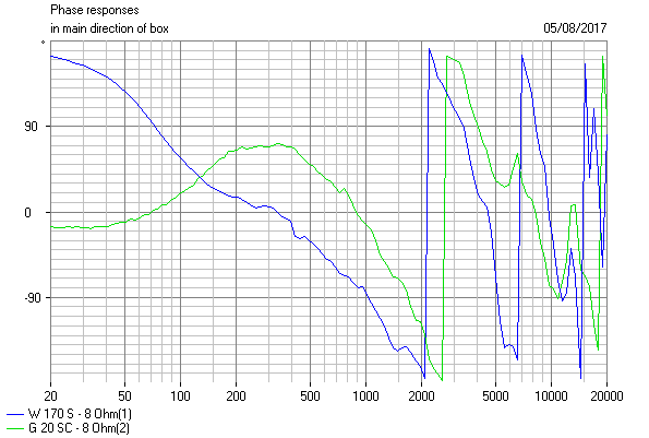

Here's a modelled speaker that looks quite awful on frequency response. 😱
But push that close to a wall for improved bass, and it all pans out nicely. Great impedance that any cheap feedback amplifier will enjoy. And good power response left and right. Some practical speaker designs follow.
Somebody once asked me to name a fullrange driver that could do it all. It's actually easy to find an example. Your average headphone driver is a 19mm. plastic tweeter that satisfies you at bass level. This is because a headphone applies a 1:1 ratio on dispersion to your eardrum.
