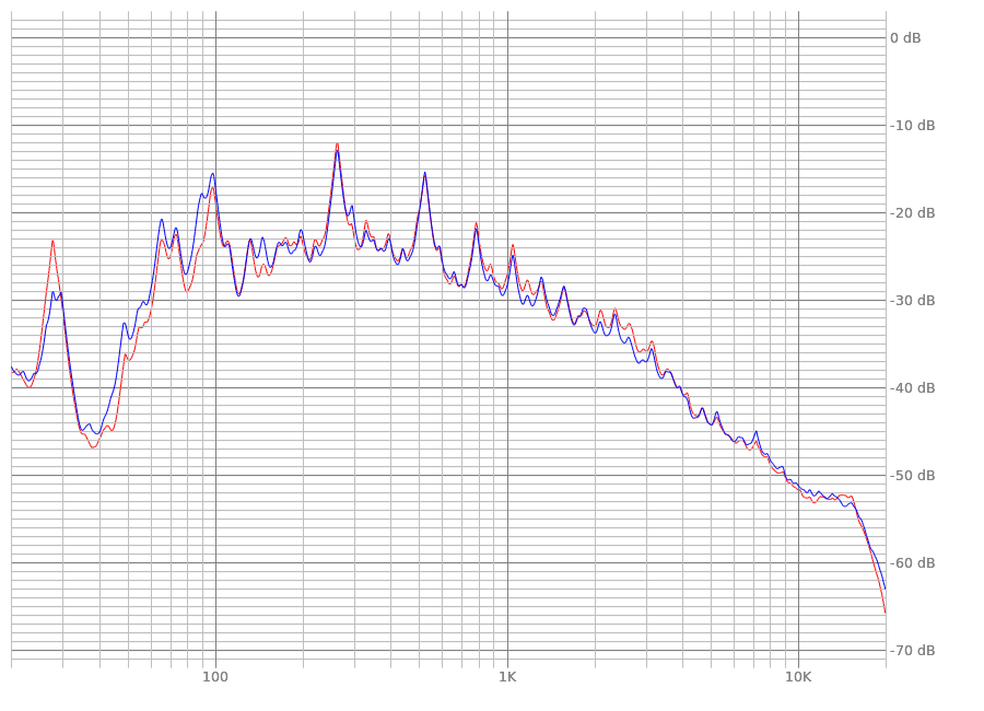

Here is a FFT of an early digital recording (Telarc Sampler 3, track 16).
The bulge around 15KHz is aliasing. This track has loud brass instruments. The brick-wall filter was inadequate.
Ed
Reactions: daqvin_carter
It could well be aliasing, but concluding this from the shape of the bump sounds like cutting corners to get to that conclusion.
It could be confirmed by finding folded back harmonics when the original sample rate is know, it would need careful spectrogram analysis of the relevant audio part.
