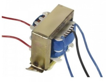

Another thing regarding it,
usually, the transformer I saw in non audio circuits look like this:
They have a metal core..

When and why you might use different types of transformers depends on space, location and application.
R Core and Toroidal transformers are generally more compact than their EI counterparts, especially when you start looking at very high power transformers.
However, Toroidal Transformers better couple any mains borne noise through to the DC output.
In a power amplifier a toroidal transformer would normally be the device of choice.
As you are not familiar with toroidals, also read VERY CAREFULLY any notes on SHORTED TURNS - They have to be mounted carefully.
