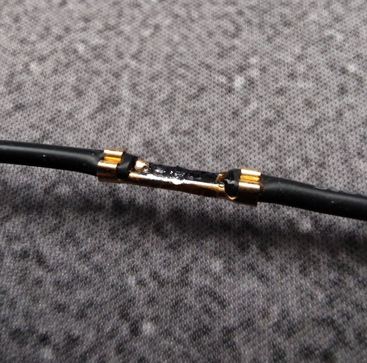

Solder in the middle section leaving the area where the ends are without solder so they can flex a bit to prevent breaking.
Perfect. I love it when someone knows what they are doing.
The location where the solder ends in a stranded wire solder joint is a very difficult place to prevent failure. When we solder stranded voltage tap wires onto our superconducting magnets, we wrap the stranded wire several times around the super cable, such that there is at least two turns left that the solder did not wick into, that provides the flex needed for the room temp to 4.5 kelvin temp difference. The stiff insulation tends to crack the wire if the solder reaches the unstripped location of the wire. We use two layers of kapton as it has 6kV per mil (.001 inch) dielectric capability, and a thick layer of tefzel over that (which is quite stiff and is the reason flexing could break the wire if the solder reaches the insulation).

I used silver solder on all connections for a high end alarm install that was hidden into the stock harness, brain, etc well up under the dash as dash was out when it was installed. There were some wiring soldered together using the mil spec method I posted above and then covered with marine grade heat shrink which makes them water tight. This was installed in 1998 and still works perfectly fine, never once had a wiring issue, been through 10 degrees below zero and 120 degrees in the desert and 300k miles which included being lowered, raised, jumped over things, sliding sideways up a mountain road....lowered again, ver custom paint and body work, new interior again as sell has gone through more high end audio installs....It has been owned by my best buddy for around 10 years now, still no issues.
Rick
Why tin/silver, if I may ask? Is it just what has worked well that doesn't have lead, or other reasons?
About 4% silver in tin is eutectic and physically quite strong. I wonder if it avoids phase transitions at low temperature? Many tin compounds have low temperature phase transitions (pure tin does for instance, know as tin pest). Perhaps silver is chosen as being as being electropositive enough to stop tin pest as well as making a suitable eutectic solder?
