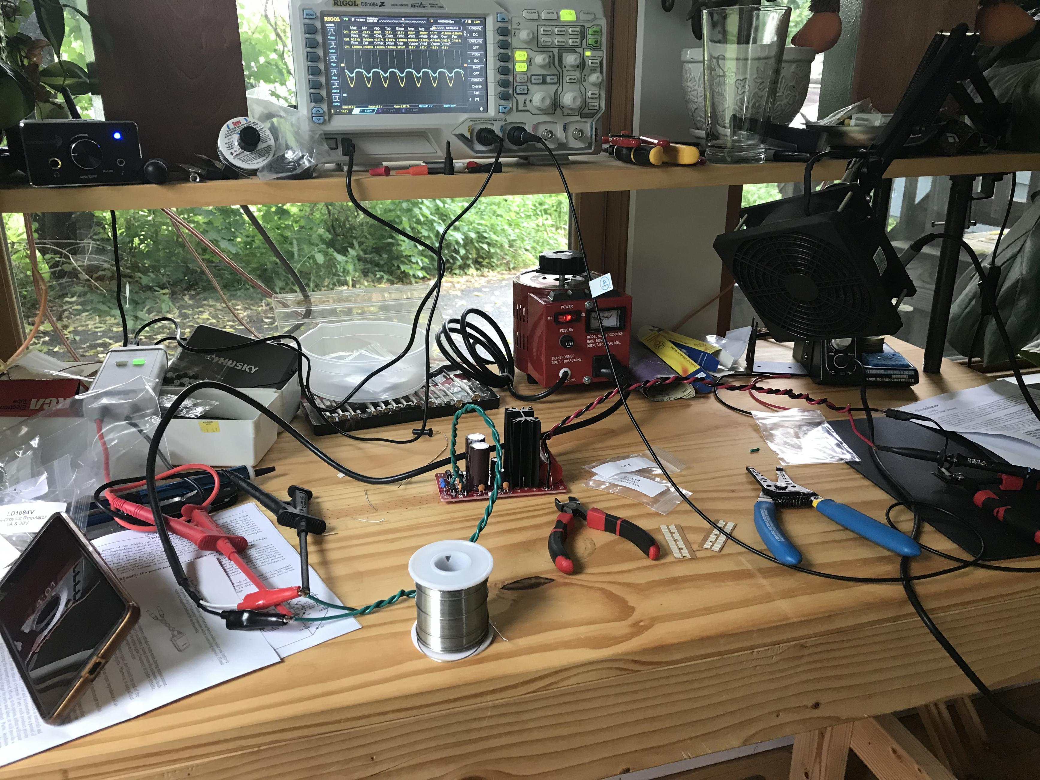

So I'm NEW to building electronics - so thanks in advance for your patience with me haha.
I bought this with the 2.5" heatsink option and 12vdc output.
I rolled up the voltage from 0-18vac and cannot get a clean 12vdc output voltage on it. What am I missing here?
Here's a photo off the scope:

I took a look at the Pictures where he hooked up the REGULATOR circuit..
I wasn't able to see dual Secondary.. All I saw was a single Secondary. So if he connects it to AC then GROUND IS MISSING.
I place his Picture here one more time.
Check out the green Leads for AC
But nowhere is a ground lead to find, which goes back to the transformer. This is essential to have no noise. I know it can be run like that, but for me this is a first grade error. Regulator is running without GND

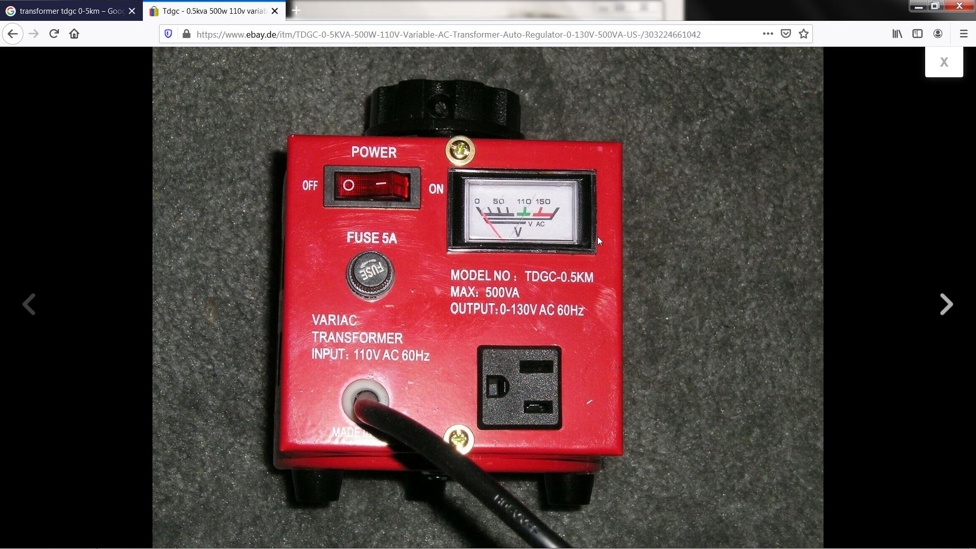

The Transformer is the red box in the back. I suppose the transformer step down step up Transformer. DO NO USE IN ELECTRONICS. Here I found that Picture of his Transformer. With this transformer it is a no go.

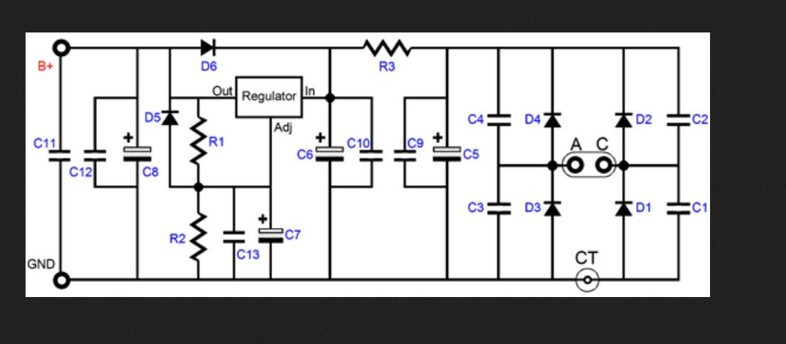

Rick,
I'm going by the cirquit and the way it was designed. In the circuit there is definately a CT = Center Tab drawn. Together with Ground of the Output of that Regulator PCB.
I know and I Agree with you that FUll WAVE Rectifying doesn't need a CT.
But it is there, either on mistake or on purpose. this is what I'm talking about the whole time.
And if you look at the Picture well then you can see on the left side where the AC voltage is fed to the PCB there is also a white/Grey little Box connected too and this one is connected to the Scope.. I don't need to tell you what this is.. To keep AC LINE VOLTAGE out of the OSC input..
What Yannie does here, is not only wrong to start with but also dangerous, becaue we don't know how the connection are in that Variac Box. See the plug then you know that this is not MADE for LOW VOLTAGE USE, meaning someone eventually can get an electric shock if this someone touches the bare output wires..
Check out the added Picture of the circuit

+1 hpro -- methinks we're swinging at the same nail .. but it did take me a while to get there. And thanks for being gentle!
And .. assume we agree that using the CT (connection point - for such a transformer - in your schematic thumbnail) requires that D1 and D3 be removed/not fitted.

This is not my schematics, this is the original from the Vendor of this BOARD.. Find it on Yannies first post.. that's the reason for my followups..
- It isn't a transformer, as I see. It is auto-transformer (variac). The difference is in absence of galvanic isolation. (Among other things it may cause a high level of ripple).
Is there an isolating transformer somewhere before that variac?
Besides that it's dangerous as well..
We call this step up step down Transformer - Means exactly Variac.
