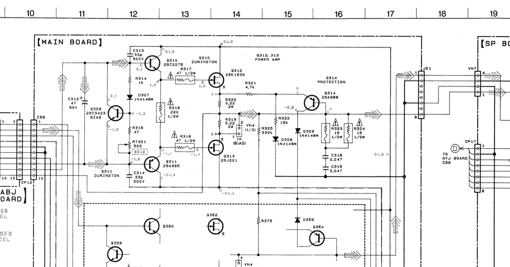

Calvin, thanks. Very informative! Can you please also comment on the Sony TA-F590ES with Mosfets. I have attached the schematic.
Thanks a ton.
Gerry
Single Ended Push Pull aka Quasi Complimentary is likely seen as unnecessary today. SEPP is more of a tube terminology.
Quasi Comp dates from the time where (as far as Silicon goes) PNP power transistors were inferior and more expensive to their NPN counterparts, so it was more favourable to use NPN power devices in the output stage. Nowadays, this is not a problem - PNP's are just as good as NPN's.
It is sometimes seen with MOSFETs because N and P channel devices often have quite different characteristics. One design I know of off hand is Arcam's "Alpha" amps that used the IRF540N device.
As for sound quality ? IMO, quasi or not is irrelevant to it.
