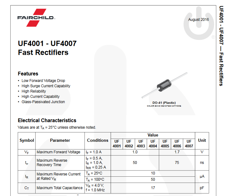

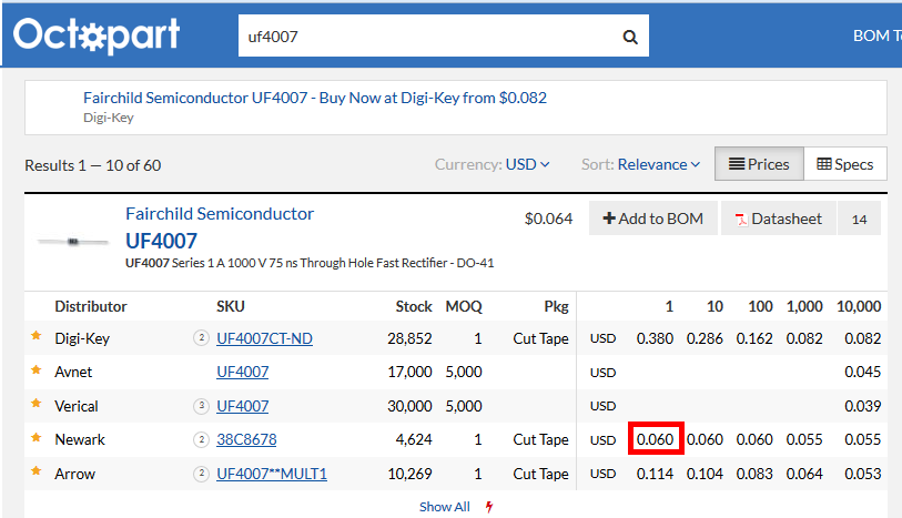

Here's the semiconductor diode that the tube folks rave about. Notice the datum in the red box, image #2.
