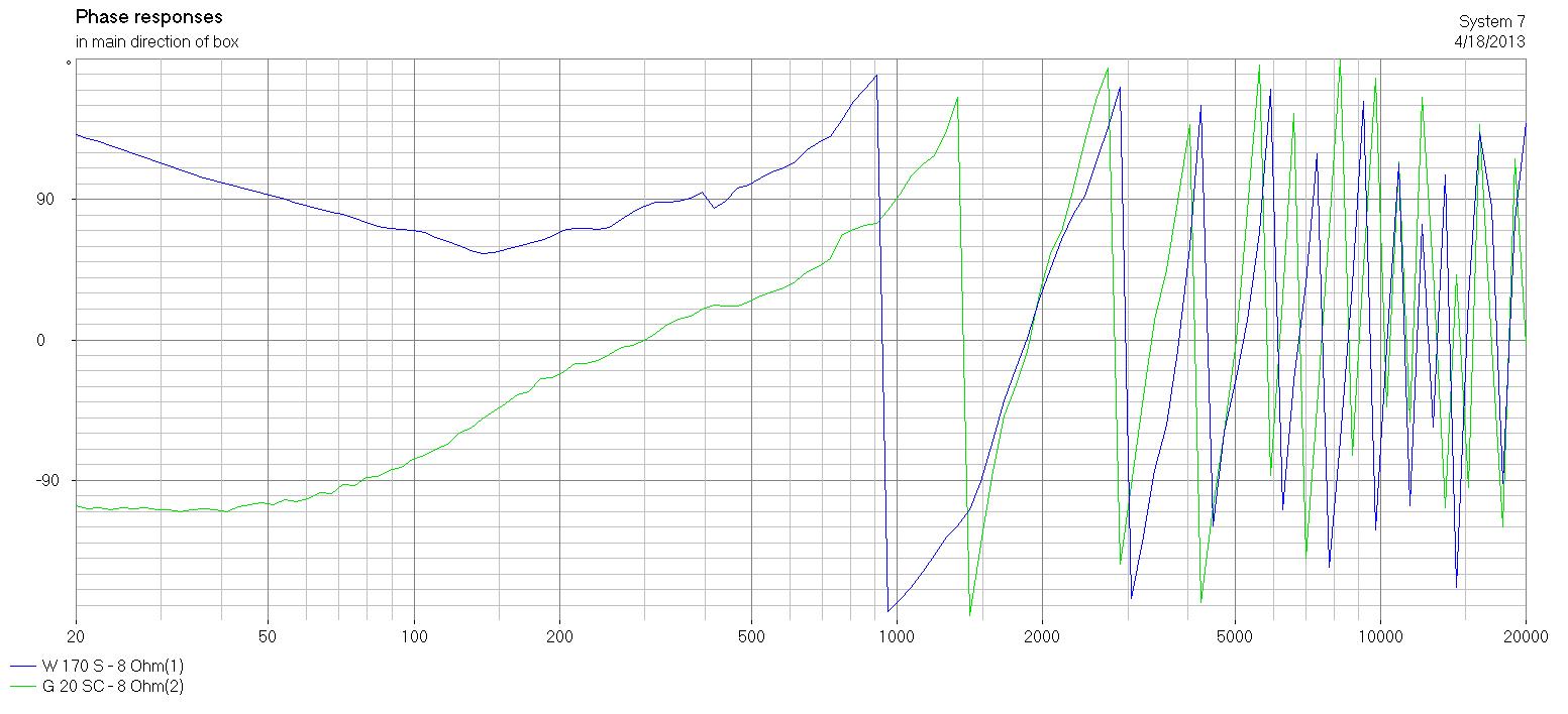

Surprisingly, Time Alignment is not to do with aligning voicecoils. 🙂
But in my experience, you need to set the tweeter back a BIT. I was lucky enough to study digital and analog filtering under the outrageously talented Prof. Tony Constantinides at Imperial College. Along with antenna Theory and the spatial Fourier transform under Doctor Clarke, which is diffraction theory at heart. 😀
When you do it all right, and you will understand that I won't give it all away to the hopeless duffers in this ego-driven game and forum, you can get some outrageously good results with even average components.

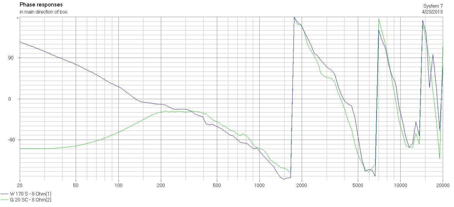

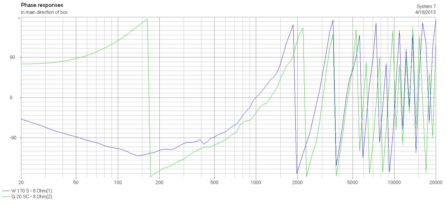

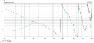

I mean, how good is this for a 6" woofer plus 1" tweeter two way? I don't make this up. 😎
You can tell me Steve (I am a hopeless duffer though..).
It's pure quantum mechanics at heart. Think double slit diffraction. 😎
Hi Steve;
1st - that crossover phase alignment and frequency response is seriously sick!
2nd - HELP! I certainly don't have your pedigree in digital signal processing and diffraction, but I took your clue and tried combining various "resonators" in the forms of either series or parallel notch filters tuned at either 1.5, 3 or 6KHz in different configurations. Mostly I tried in conventional parallel driver set ups - but I also started trying a pseudo series driver set up and it is coming closer - but no way have I been able to capture all the nice aspects or your design or even come close! (worse than a hopeless duffer, if there is such a rank)
I'll put together separate postings showing what I tried - but any more clues you'd be willing to reveal? On the plus side your puzzle forced me to download and get to use boxsim and has also forced me to expand how I think about crossover networks beyond the traditional. On the down side - lots of head scratching!
Any more clues appreciated - it would be nice to actually build that thing!
Thanks - Paul

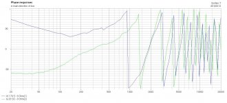

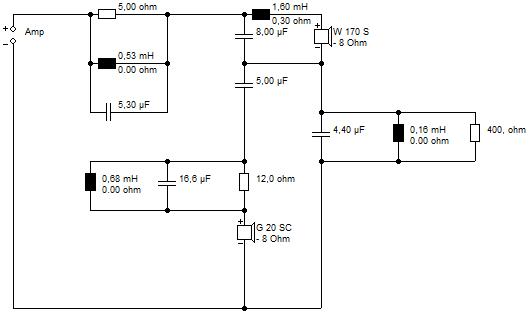

Here's one attempt - a 2nd O filter with some 3kHz notches in series -
Some hope at getting good phase alignment but the rest is pitiful:

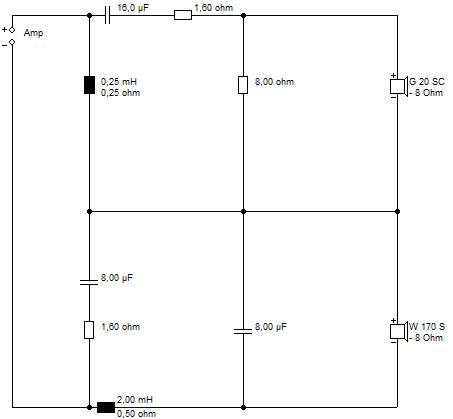

Here is an attempt to get the steeper rolloffs you have achieved by putting series notches in parallel - tuned at -1 octave for the tweet and + 1 octave for the woof:
(phase alignment not too bad near xover - but not over a broad freq range)

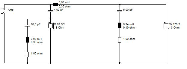

Here is an attempt to match those double impedance bumps + and - crossover in a pseudo series driver arrangement with some - resonators. Clearly I have no idea how to do this series driver stuff:headbash:

So Steve - am I remotely on the right continent with any of these approaches?😕
Any guidance is greatly appreciated.

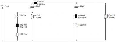

Not really, you are making it too complicated. 😀
The discussions of serial crossovers have been a torment at this forum, and I've got quite cross with some people here. But they do something rather special that you can only approach with parallel filters. An ex radio-frequency engineer like myself spots it straightaway. Radio engineers do stuff PROPERLY! 😎
I will tell you how filters work though. Firstly "diffraction" is in any cabinet, room and drive unit. It's even in the filter. It is a power response that looks like this:
You will never get rid of it, so you must work with it. The envelope is a gaussian distribution, the wiggles and cancellations reflect the wavelength. The gaussian is, AFAIK, unique in signal processing, because it is its own inverse and that is why nature (and engineers who respect elegance in mathematics) uses it so much. When you get a gaussian response, you are doing something right.

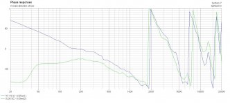

The second diagram shows how linear phase filters and the impulse response works. Everybody in electrical engineering knows this one, but few really understand it.
This is a thing of great loveliness. It is known as a SINC FUNCTION. It is also the Dirac Delta function of quantum mechanics. It tells you that if a filter is steep, it makes the signal ring for a long time. The reason people don't understand it, is that it's a bit of a theoretical thing, because real world filters are causal and assymetric in response. But the transform is straightforward enough and you have to accept that any real loudspeaker will have some group delay or time signature in its response.
FWIW, group delay is the SLOPE of the phase. It's a differential relation. So phase alignment is only part of it. You also want to keep the slope fairly flat.
Hope that helps. You might think you are doing loudspeakers, but actually it's the maths of Quantum Mechanics. Which is WAY COOL, IMO. 😎

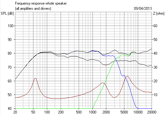

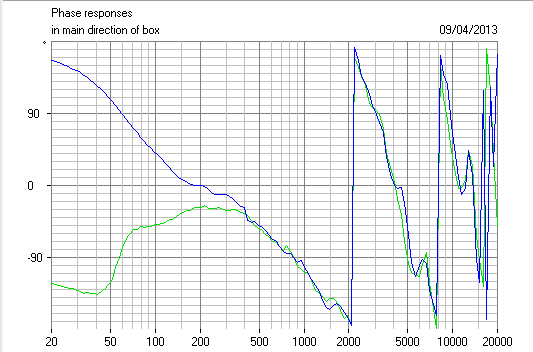

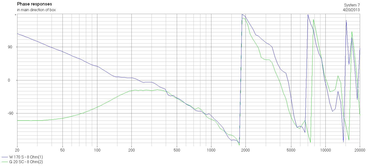

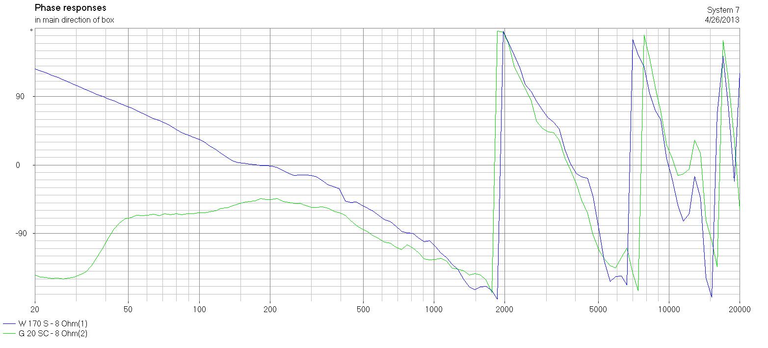

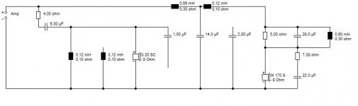

In the mean time I hacked away at this in a more trial and error approach - starting with some LR 3rd and 4th order HP and LP filters, mixing and matching them, putting in Zoble networks and notch filters here and there, moving the tweeter z a bit back etc etc..
Can get a bit closer but still missing that nice sharp LP filter rolloff you have and a bit lumpy (a fish - but a bit of a stinker🙁)
Thanks for pushing me on to say the least!

That was nearly there. It just needed Bafflestep. Then it all fits into place. You can lose the notches, just keep the Zobels. 😎
That's all you get. You must work out the rest for yourself. But I will tell you where the natural point of crossover occurs:
Lynn Olson said:
When working with rigid-cone drivers, there are some hard choices to make: if you lower the crossover frequency to minimize driver coloration, tweeter IM distortion skyrockets, resulting in raspy, distorted high frequencies at mid-to-high listening levels; if you raise the crossover frequency to improve the sound of the tweeter, the rigid-driver breakup creeps in, resulting in a forward, aggressive sound at moderate listening levels, and complete breakup at high levels. (Unlike paper cones, Kevlar, metal, and carbon fibers do not go into gradual breakup.) With the drivers we have today, the best all-around compromise is a 2nd, 3rd, or 4th-order (12-24dB/Oct.) crossover with an additional notch filter tuned to remove the most significant HF resonance of the midbass driver.
Go for the geometric mean of the 1400Hz tweeter Fs and the 5kHz resonance of a 6.5" driver. Roughly.

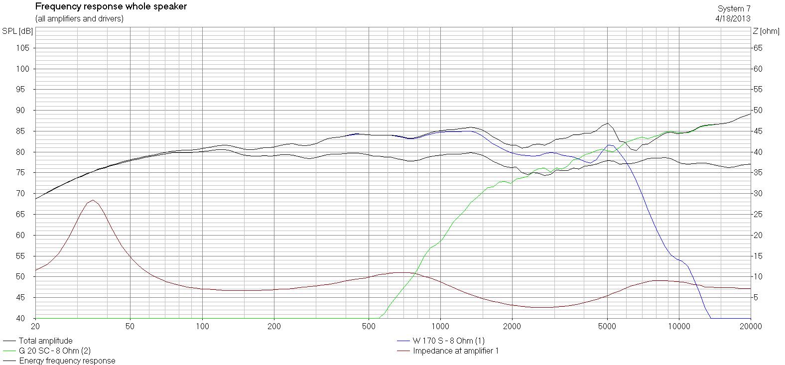

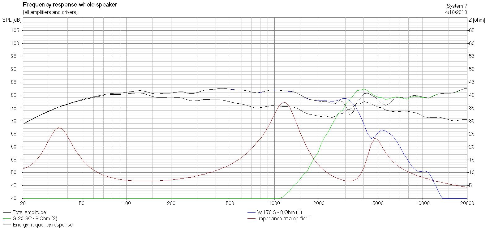

What's wrong with the impedance? It's basically 6 ohm. The 2.2 ohm is to lift the woofer a little, I think. Or are the impedances added at the crossover frequency? With some phase, gumming up? Maybe still close to 6?
Normally the tweeter would play the loudest at very high frequencies. With the 2.2 ohm that end will be attenuated. The other resistor attenuates the shelf below the high end. The woofer is also affected by these resistors with capacitors, the way the curve of attenuation looks like. Less clean capacitance gives less lift for the woofer near the crossover point. The woofer probably has a nasty peak near the crossover point.

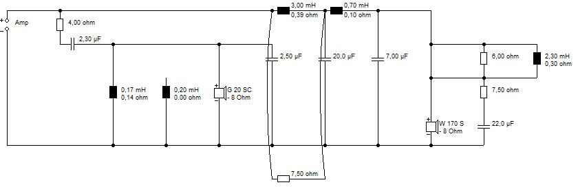

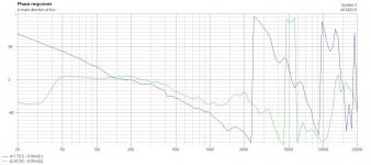

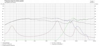

Damn you System 7 - I can just not get the Xover steep enough near the Xover point (and match the phase at the same time)! This is the best of several tries so far where I prioritized being down ~15dB at the 5KHz cone breakup and tried to be low on the HP filter for the tweet Fs at ~ 1400Hz. Almost buildable, though the lack of crisp filters leads to ~3dB sag in the middle. - not sure about that high frequency impedance - is that ok? :worried: Also 2 more parts than you used - 🙁
@strawberry: Bit hurt by your lack of faith there, my old fruit! You had it right the first time. It IS interesting. You who likes a bit of ripple in the old Chebyscheff filter. 🙂
@phivates: Don't go all sensitive on me. Irony is misunderstood by Americans. Why is that? Beats me...😀

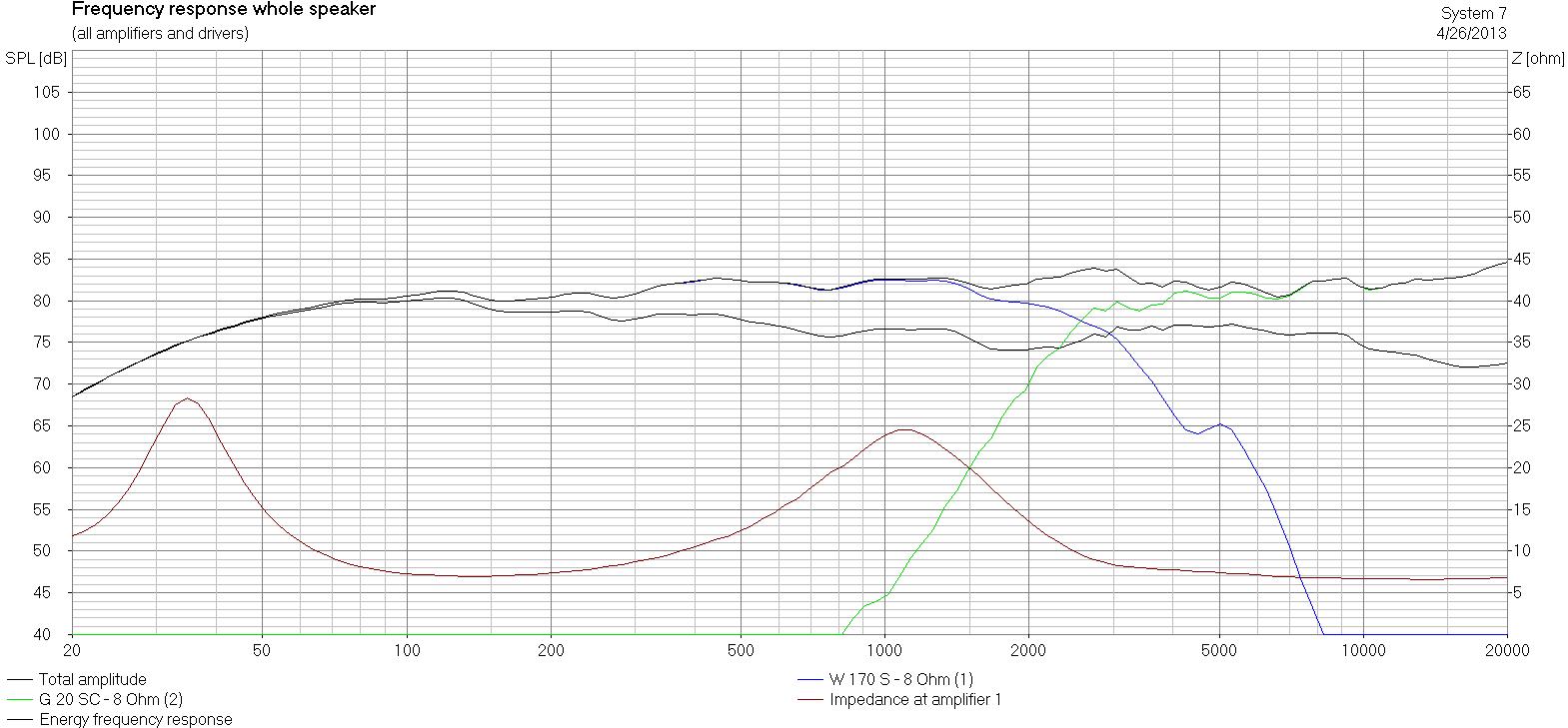

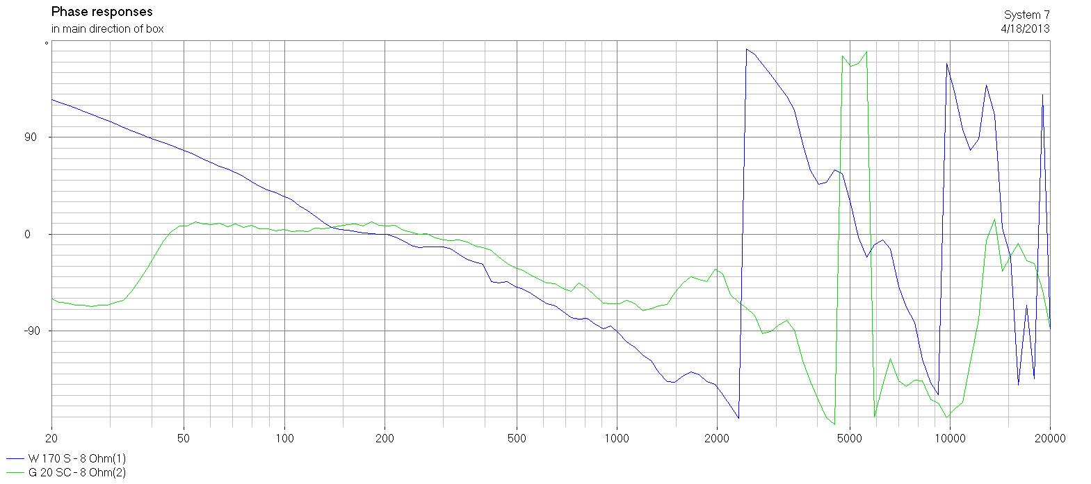

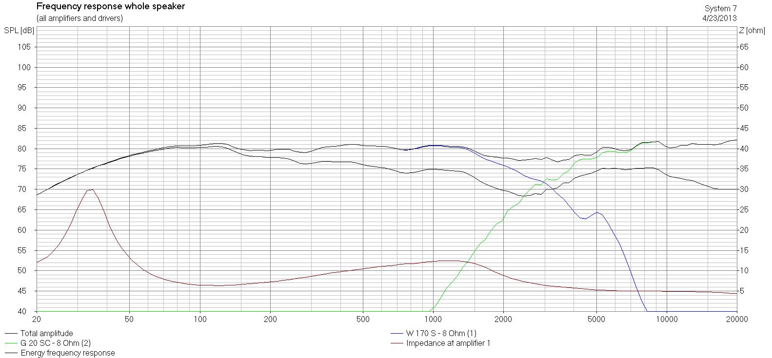

@nvr2: Very good effort. You understand the need to define source as well as load impedance just like the radio frequency folks. But surely I'd told you it was series filter, not a parallel. Different animals. They do different things. Conics in Geometry shows the relationship to my way of thinking. Parabolas versus Hyperbolas.

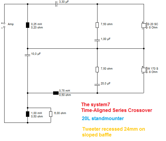

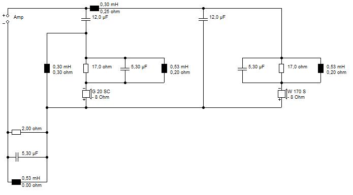

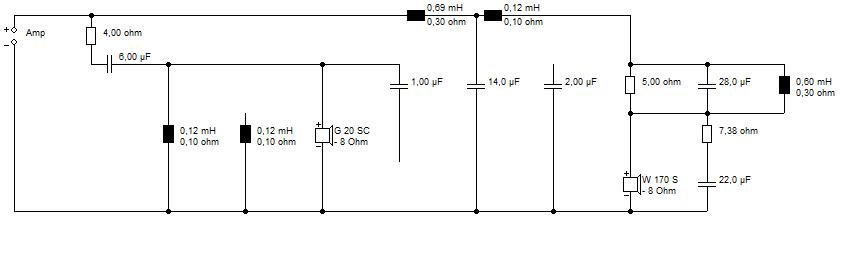

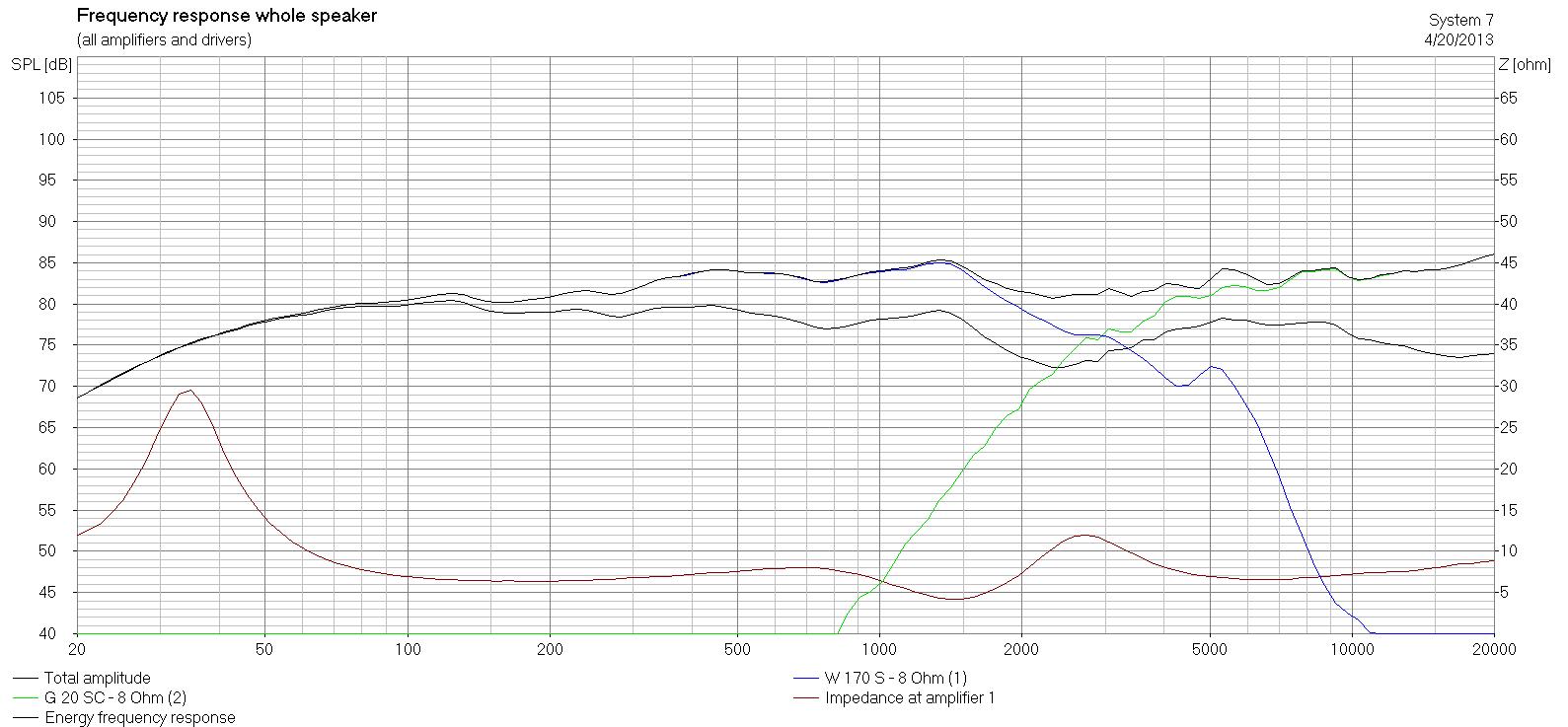

Anyway, here it is. A thing of great loveliness, IMO. Just like Mike Creek always used to say, every component punches its weight and does several things. The tweeter Zobel can be a 22R resistor instead. Either way is good. 😎
@nvr2: But surely I'd told you it was series filter, not a parallel. Different animals. They do different things.
System7 - Truly a thing of beauty - sorry for not full catching on to your clues earlier. I caught that you said series crossovers did something special - but then at the same time you pointed me to the ESP posting that said they were basically the same except for different sensitivities to woofer impedance changes or back EMF - so I misunderstood your message. At the time I tried my hand with a couple of Series arrangements but was completely baffled by how both HP and LP curves moved with each change of a component value. When I saw the email saying you responded to this post revealing the secret - I was both elated that I would get to see the magic and deflated for failing - so I did not open the response without going back again to your clues and trying my hand at the series crossover again. Here is where I got to with a redo of your clues - not the full answer but not bad for just 8 components 🙂.
When I get back from vacation I'll play around some more to hopefully get a deeper understanding - then maybe I'll make one of these for my Daughter. THANKS again for pushing me on this - it was fun!
