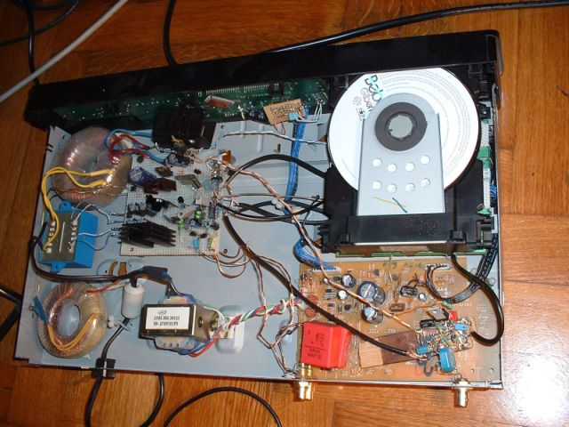

I tried the hack today on my modified CD4000. It works wonderful - smoother, more natural... :nod:
Thanks Robin!!!:drink: :drink: :drink:

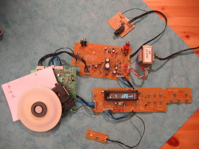

Anyone needs a spare display for their CD723? :D I decided to use a Crystalfontz PLED display (see image below).
I will only use a few parts from the original player, some of which are not easy to source - it's best to buy them in a cheapo player of some sort (You get an ESD protected packaging and built-in self-test, too :D)
  • VAM1201 drive mechanism
  • Drive Foil Connector
  • Infrared Remote Sensor
  • SAA7378
  • TDA1302T
  • Maybe some of the drivers (I think I'll go balanced to keep the ground clean)
BTW, this drive mechanism is really flimsy. The cog wheels from the tray loader easily wear out and then fail to push the drive assembly to the disc clamper. And the position of the disc "turntable" on the spindle motor needed adjustment. It can be moved up and down easily, so the disc might hit the drawer or be out of reach of the focus servo. Be careful when handling your player!
