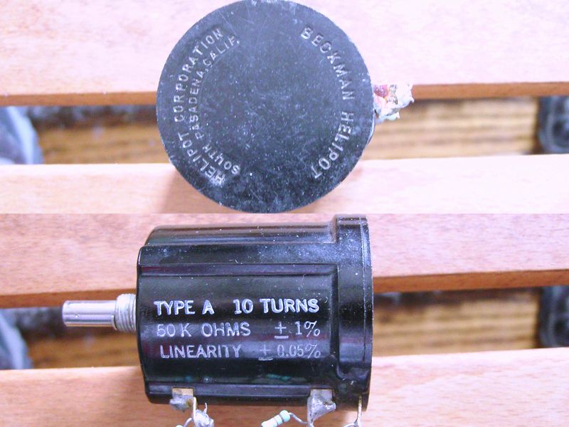

jackinnj is right about the price - i recently scavenged this wire round pot.
i wasn't sure if i would ever have a use for it but it sounds like it might be worth playing around with. i am building a buffer now so i may try it out in the prototyping stage.
it is too bad i don't have another so i can use it in a stereo set up.
in regular use 10 turns seems like a lot of work!
check out that plus/minus 0.05% linearity.
