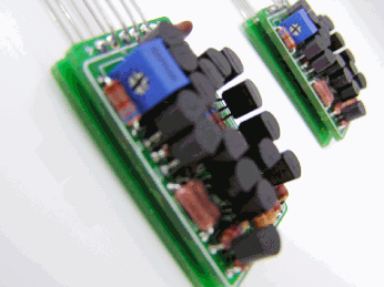

The Burson discrete Op-Amps I can use as a single module, they are burnt-in, transistors matched an set properly.
I am confident this solution (which I already used with great result in my cd-player's output - as dual Op-Amp - I/O and buffer) will give much better performance than most (any ??) of the Op-Amps out there.
In case the LM4562/LME49720 is really as great as said here the gain in quality will probably be marginal so I will be happy with the Burson unit.

Oystein, you are going the right direction, dont fear, the National chips will probably not touch the burson in sound quality, I havent heard the bursons but built a copy of a design identical to that designed by a gentleman from china and no opamp Ive tried so far matches it. There was a debate going on about who designed it originally .
There is a design here on this forum by euvl I think his nick is, very simple and tiny, only slightly bigger than a chip opamp with few parts thats great also.
the Burson is claimed to be a copy or rebrand of the Audio-gd Earth which gets panned in this detailed op amp comparison:
http://www.sg-acoustics.ch/analogue_audio/ic_opamps/pdf/opamp_distortion.pdf
pg 81
at least this discrete op amp falls short of the better monolithic competition on objective technical measurements that appear somewhat relevant to quality audio
pg 81
