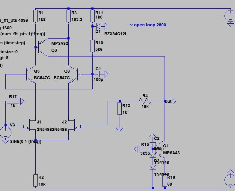

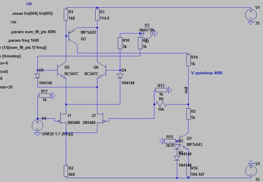

Why not this pre-stage driver?
The topology in fig 1 of attachment is well known.
The of fig 2 is not.
It features high olg with , even without ac feedback, very nice harmonics spectrum.
However apparently a stable dc op is difficult to find.
