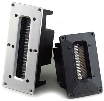

Why not the Aurum Cantus AST25120?
You could be right or it could be very poor QC. Aurum Cantus is no exception to that mater.
Okay, if the quality spreads that much, it's a very good reason not to buy the Daytons. Even the low price is no excuse for that.
Baaming of AMT tweeter of that lenght isn't negotiable. It is a matter of physics. Or you will provide us with measurements that will prove ICG wrong ?
Exactly. The only explaination would be if the hearing (upper frequency limit) would be impaired (but I wouldn't suggest he can't hear that anymore).
Aurum Cantus seems to have traditional ribbons (such as the G1) that do beam, and "Aero Striction" ones, that does not. Apparently.
Their ribbons are very deep in the driver, alone the (narrow) opening does not allow a wide dispersion.

If the AMTs were that good in dispersion, they would surely show measurements and praise them for that.

I'm sorry but I don't buy that.
You don't believe me. Buy one and find out for yourself. They do not beam vertically like a traditional ribbon, period. Chalk and cheese. It is really very very obvious if you have a ribbon to compare it with. Side by side I had them, and I am not deaf to high frequencies. It was astonishingly obvious the difference. I could not believe it myself when I first fired it up, but the microphone backed up my ears, and I am not the only one claiming the AC AST do not beam vertically. How they do it I have no clue.
Sometimes with a ribbon, if there is a peak in response between 5 and 10kHz the beaming effect can be precieved as exagerated. How carfully was the test conducted? each driver leveled in response etc?
If they dont beam then they have accomplished something no one has been able to do and believe me they have tried. I would think they would be all over this phenom in the press. And I would think many of us here would have heard of this.
I very much want to see measurments that show this dispersion but certainly not buying one to find out. Every planermagnetic and ribbon driver I have ever built shows the same beaming for size.

That won't work on an AMT because the folds had to expand differently, depending on the position, that would introduce very high non-linear distortions. They had to chop the membrane into shorter pieces (which isn't the case).
Wavefront shape of a ribbon is dictated by diaphragm shape of a ribbon, and a tall narrow ribbon will have a narrow vertical beam. It is inescapable.

The simplest solution to minimize a narrow vertical dispersion with AMT's and ribbons is to use shorter ribbons or shorter AMT's. Curt and I have used Fountek CD3.0's in our Statements series and a AST2560 in our Bordeaux design.
Both will have very broad horizontal dispersion with similar vertical dispersion when compared to a one inch dome. Both are awesome for seated listening and very nice for walk around casual listening at normal distances. No head in the vise effect.
I would suggest anyone buying AC AST drivers plan on measuring them carefully for FR. The AST2560's we used in the development Bordeaux (mine) was an older driver that measured extremely close to published FR graphs by Aurum Cantus. However sometime in early 2017 a production change was made which altered FR and caused a broad dip in response. That is why Curt introduced a revised crossover with the help of the builder who noticed it and took measurements. This isn't a lack of quality control just bad management by AC for not updating the documentation.
