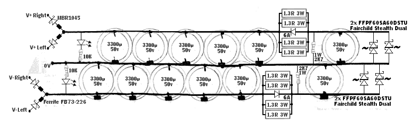

I'm assuming that both cases (for comparison) are a CRC supply, and what we're looking at is the benefit of a bypass diode for the resistor.
Next, the caps discharge as required to power the amp for moving the speaker. That energy comes from the caps (there would be no sound if there was no discharge). Even at this point, the voltage difference in our comparison, is not significant.
Once the power has been expelled (as is required to move the speaker), then we are left momentarily unprepared at the power supply reservoir.
Clarity returns AFTER the caps regain full charge, so I suggest that we might like to recover charge very quickly. This is the point where the difference has become significant.
Options include:
1). Buy a much larger transformer (more current capacity = charges faster), or
2). Short the "R" of the CRC with a solid copper wire (aka don't use CRC filtering), or
3). Diode bypass the "R" of the CRC to limit loss.
Option #3 above filters similar to a normal CRC and is cheaper than replacing the transformer with a higher current model.

I repeat my earlier questions (post #39). Please tell me exactly HOW the unspecified diode in parallel with the 1R3 resistors limits sag during heavy current demand and WHAT the MBR1045 schottky diodes on the DC outputs are doing and HOW they are doing it.
The diodes provide a direct current path in case of a big (short) load step. In normal operation, the voltage drop over the resistors is smaller then the forward voltage of the diode, so filtering via CRC is active. When the diode is conducting, CRC becomes CC i guess.
This will reduce sag, as the secondary capacitors will get current much faster.
Will they?.............. the secondary capacitors will get current much faster..............
The first C is a singleton electrolytic.
The last C is a multiple bank of many electrolytics.
This bank of electrolytics is sized to allow the amplifier to replay whatever bass signal is applied through the input filter.
Adding another C via diode does NOT speed up the capacitor bank, ("the secondary capacitors will get current much faster").
The mains charges up the First C during a duty cycle that is <<20% and often around 5% to 8%.
This first C charges up the main bank when ever there is a voltage across the dropping resistor. If there is no voltage drop then there is no charging.
If the Vdrop exceeds ~700mV, then either he has sized his PSU components incorrectly, or the amp is attempting to output a signal that is not music.
The diode does NOT
aka increase dynamic punch
Will they?
During that 5% to 8% period, if the single C's Voltage ever gets to be more than one diode drop higher than the bank of C's after the diode, the transformer will also be directly charging the bank through the diode.
edit: I just saw what you posted about 700mv. I would think that is a matter of opinion. I'm not sure that the CRC necessarily has to be designed in such a way that it is providing full benefit during the highest peaks of output.

Might try changing the diode in the simulation to MBR1645 or MUR820, for a tradeoff of a little bit less CRC filtering in exchange for a little more power. They can't completely turn off the CRC filtering anyway, since even the most efficient high current diode does have a voltage drop, and therefore the CRC filtering is never shut off (albeit we might could say "momentarily hindered").
To test those "all out performance" conditions, in fact, I did just put some MBR1645 crc bypass diodes in mine and cranked it up loud, with the digital bass boost switched on at the source.
Oh, yes, almost as much power as shorting the CRC's resistor, but more clarity than shorting the CRC's resistor. There an appreciable greater amount of bass slam than when using the 6a05 for bypass diode. In these cases, the bypass diode does exactly what it looks like it will do. With only the resistor, the more power you want, the more heat you get instead, and the bypass diode can be added to limit the waste. So, there's just not a mystery at that part of the circuit.
And, you're right, of course, the bypass diode is probably only applicable for loud replay.
That's like dual mono without the wallet smash effect. The $4 worth of added diodes is a LOT less expensive than the additional transformer and power board it would take for real dual mono.. . . WHAT the MBR1045 schottky diodes on the DC outputs are doing and HOW they are doing it.
In reference to this schematic <--link and on the topic of fun with schottky. . .
The output diodes on the left side of the schematic is for the virtual dual mono feature.
With virtual dual mono, the function is in making the left channel amplifier decoupling caps a bit separated from the right channel amplifier decoupling caps. As a bonus, working decoupling sounds really good.
Typical virtual dual mono schemes use separate left and right channel big regulators at the dc output side of the power board (or at the amplifier board). I have merely replaced that idea with something less effective, easier, more efficient, and less expensive (a schottky).
