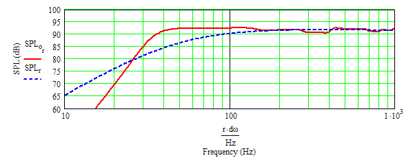

GM, could you reduce the line length at all and still not have to change the port and everything else? I was thinking of making it 48" instead of the 50.75" it would make it easier to cut it out of a sheet of plywood. Otherwise you need 4 sheets of plywood just to get the 28.5" boards out of it.

Re the shortening, it'd probably need adjusting as the height of the cabinet (i.e. the line length) determines the tuning frequency, and you'll be loosing some volume from the cabinet.

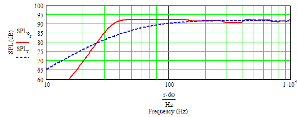

davidallancole said:GM, could you reduce the line length at all and still not have to change the port and everything else? I was thinking of making it 48"........
Greets!
To maintain the same simmed response, yes, so for the record:
L = 48"
CSA = 134.685"^2 ( prefer 28.5" W x 4.47" D)
zdriver = 18.637"
zport = 4" dia. x 1.75" long near/at the bottom for T/S max flat
All dims i.d. and approximate, minimal stuffing and add more down at/in the vent if too 'boomy'. Driver mass loaded against the back panel.

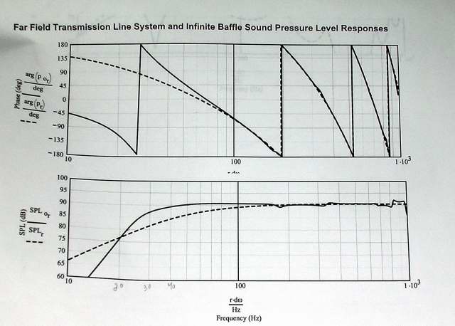

I actually did build a MLTL with the B20 several years ago when I first started playing with full range speakers. The B20 works very well in a MLTL, giving good base response down into the low 30's/upper 20's. I used Martin Kings spreadsheets to do the design work and the responses looked a lot like the ones Scottmoose posted. I ended up using a tweeter since I found that the B20 didn't have good high end extension, and has a few sins in response that I was able to avoid. All in all a nice sounding speaker. I'll try to dig up and post my design details for you to look at them.

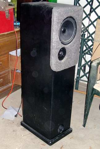

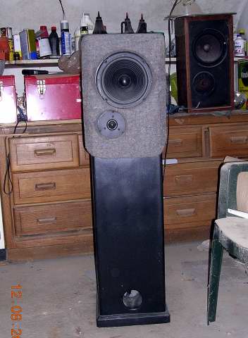

Whats that piece of wood you have glued on the front of your box Godzilla? Is that to help dampen some of the resonance from the box? If so, would that work on this larger box that GM has proposed? Do you have the front bolted to the back? There looks like there is some screw heads or something a little further out from the speaker.

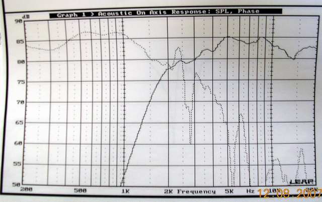

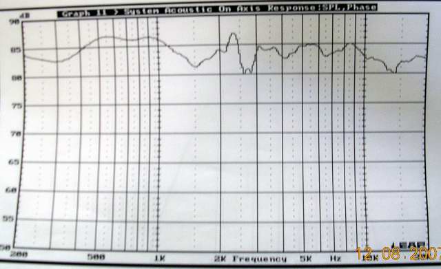

Some info on my B20 MLTL
David,
It's been a few years and I can't find any info on the crossover that I used, but here is what info I have been able to dig up.
Box dimensions (external) : H = 43", W = 10.5, D = 15.
The woofer centerline is at 36", the tweeter centerline is at 29 3/4", tweeter centerline is 3" from inside edge of enclosure. I mage the box out of 3/4" MDF. I also ended up removing the whizzer when I added the tweeter. I'll attach series of pictures showing some measurements, you'll notice that the B20 has some serious irregularities a little above 2K. I crossed 2nd order at ~ 2K to try and avoid them. The tweeter is the PE silk dome. The pic below show the finished project, they've been my garage speakers for about four years now. They sound good enough to be in the house it's just that I didn't sweat the details on the enclosures. The fuzzy stuff on the baffles is felt, I added there for diffraction control. All actual measurenents were done with the B20 mounted in the enclosures outside on the driveway, no smoothing applied. Ignore everything below ~ 200 Hz. The base is very nice, no boom, just tight and deep.

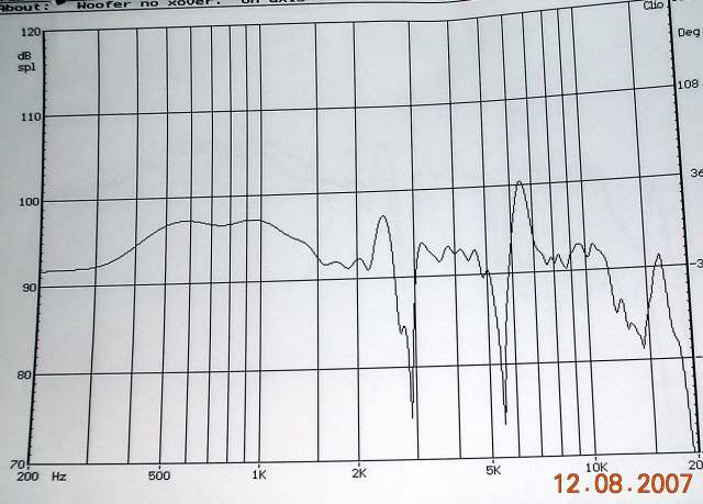

Actual B20 measurement
Here is the actual measurement in the box. Note the wild peaks. I tried to work with the B20 full range, but I couldn't find satisfaction so I decided to try and avoid the peaks and the poor high frequency response by making it a two way.
Thanks for showing us the speaker you built. Could you hear those dips in the sound? I haven't heard many people complain about something like that.
B20 MLTL
I think that I could, the sound was dull due to no HF but is was also dissatisfying in the mids like detail was missing. Good base though,
