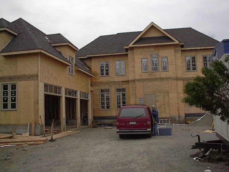

I've built a house or two also (though not my own):
