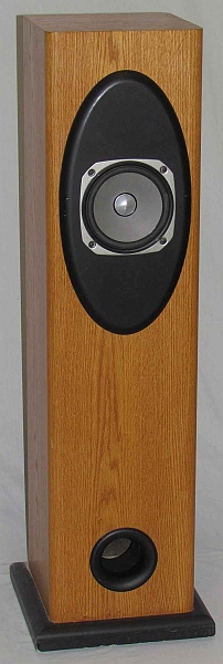

Before I got shamed out of using MDF, I used 3/4" MDF (NOT Lowe's/HD -- a supplier to local cabinet shops) laminated to 1/4" Hardibacker (a cement/fiberboard used as an underlayment for ceramic tile) with Liquid Nails. The inside of the cabinet is lined with 5/8" acoustic fiberglass and outside veneered. I still recommend this as a viable construction technique.
I had two problems with the MDF construction, well, three: 1. MDF dust gets everywhere and a mask is mandatory. 2. The finished cabinets are REALLY heavy and expensive to ship. 3. The cabinets are prone to corner damage during shipping as the edges are easily crushed. But, for one-off DIY work, have at it!.
Here are photos of the technique:
And the final product:
Bob
