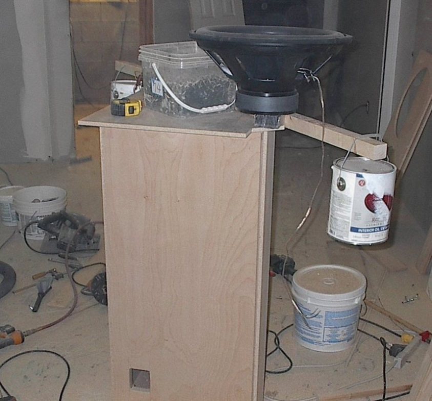

I was on the brink of building a simple bypass pump/reservoir for vacuum bag use, but changed my mind. I would not use it enough to justify its existence.
I use clamps and various ingenious jigs to laminate material, and unless you're looking for absolute uniformity of thickness, that's fine.
I've also used weights as clamps as Brian suggests. See the attached pic. the paint cans hanging from the ends of the board is my favourite.
