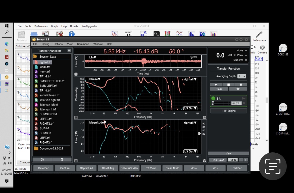

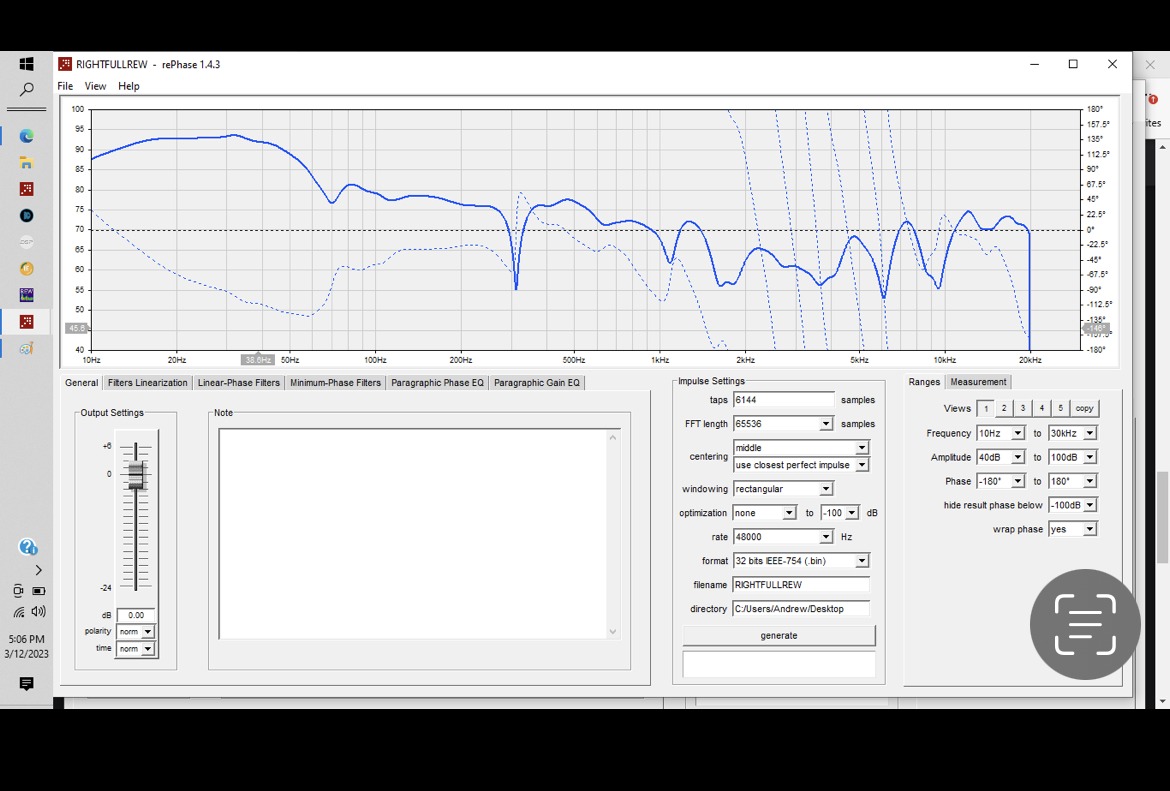

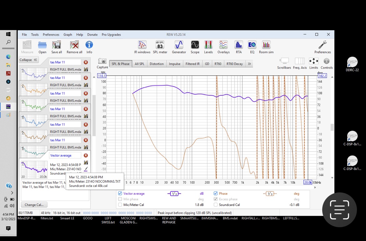

So here is my smaart averages and REW vector averages, and I did this order
Take measurements, have REW shift IR on each measurement, smooth all to 1/3, time align measurements , vector average send to rephase for work
Smaart is a direct capture and sent to rephase
Huge differences, you can see in the one named REW , the magnitude is dips like crazy and there not there in smaart,and smarts correction sounds 10x better…..
So how do we get phase data and mag data in REW that’s not riddled with errors

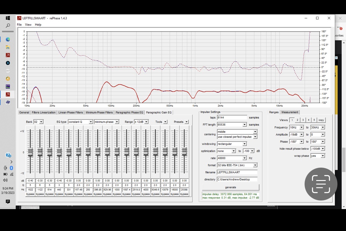

Here’s the right ch , and my left ch corrected. With no sub , in which I did move the phase to match the right ch and it works so so good…..
My sub is on the right ch because the path length and phase between the right ch and sub were a good match , the left was so wildly different I had to pick one to sum and the other one to correct and match to….

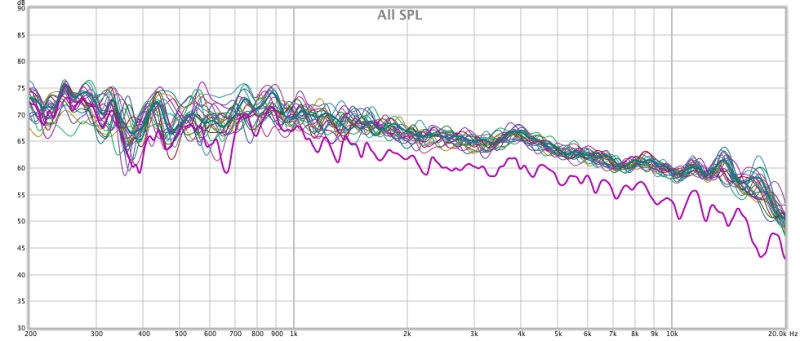

I can't say I completely understand the problem you are having. I would start by looking at all the separate measurement positions you have made and compare them. Is there really much difference between them ? If they are relatively consistent within your head area then I would just pick one and use that or maybe one to represent each ear. If there is a significant difference then an average might work better, but the more each response is different the less likely the average will be truly representative of anything. I think trial and error here is still the only way to go as I have never found exactly the same recipe to be preferred with a different speaker or room.
I would use frequency dependent windowing rather than smoothing, by windowing you will remove much of the reflections that are causing the phase to be less clear. And this should only be done after the measurements have been vector averaged.
Vector averaging gives a different response at different frequencies. In a room above 1K the reflections form a pattern that averages out quite well, below that the pattern is less coherent and the averaging doesn't reduce the effect of the reflections so much.
This can be seen in the image above, 1K plus gets clean and averages down evenly, 300 to 1K the dips get exaggerated and below 300 things revert back to look much more like a frequency average. A car is no doubt different but would have it's own characteristic.
You can also try frequency / RMS averaging without phase to perform magnitude correction, (this could be moving mic in the head area) and then use a windowed single point with that correction applied to look at phase.

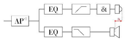

IIR EQ/XO and FIR global phase-unwrapping:
Now move the AP⁻1 phase unwrapper into each individual branch and multiply with the individual EQ/XO/delay and you will have individual FIR approach.
Diagram taken from https://www.grimmaudio.com/wordpress/wp-content/uploads/speakers.pdf which details on the "done right" thing.

Camplo, to build on the helpful diagram KSTR posted, here's my take on when global works best, and when it may not.IIR EQ/XO and FIR global phase-unwrapping:
EDIT: I see I posted that link on page 1 already ;-)
KSTR and/or others may have different views, so take mine FWIW.
If the AP-1 phase unwrapper, the global FIR, is unwrapping the xovers' summed electrical phase only, I think that's the best case for global FIR working well.
If it is unwrapping an acoustic measurement of the entire speaker, I'd say 'danger Will Robinson'.....'unknown alien may be good or bad'.

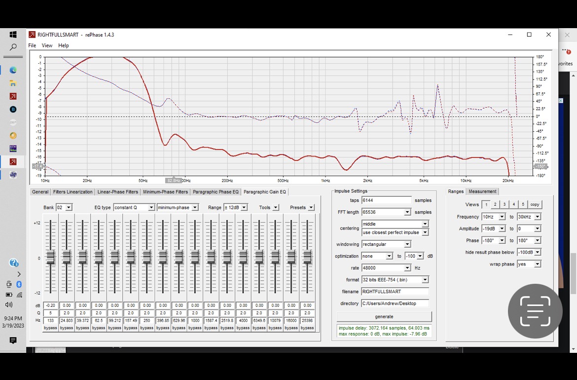

I don't understand what is meant by global phase unwrapping in this context. My aim is to have the response at the listening position be close to a minimum phase version of the overall response. For any speaker with good low bass output making the phase flat when the speaker begins to roll off from the box/port just does not sound good to me.But i think an attempt to use an existing speaker's acoustic measurement, and simply try to apply global phase unwrapping alone, is bad ju-ju at best.
@fluid
So wait a sec , the minimum phase version of the original response
Okay ….. so could we in essence make some db averages , and generate the minimum phase version of that , but use that as an overlay to match our target to weather it be another process of getting the same thing with our fir
I wondered if my sub phase should tilt down if response goes up like the minimum phase version does….
That should do it right? I think I can import a impulse into smaart and use it as a overlay… then match my phase to the minimum phase version with a few iterations….
Although I would have to get the averaging points the same on both sets of measurements, but that shouldn’t be too difficult
I’m curious about this , pos said something in an email to me and something just like what you said but it didn’t click till now (I’m slow)
Should work yes ?

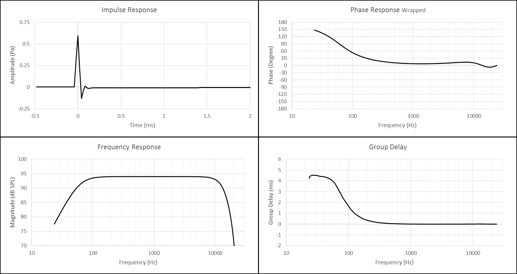

Yes, I want the phase to be as close to the minimum phase version of the magnitude response. Like below where the magnitude is flat the group delay and phase is flat but when the magnitude changes so does the phase. If the phase is forced to flat all the way down instead of being allowed to bend up that does not sound good to me given the caveat the magnitude response actually extends quite low.Okay ….. so could we in essence make some db averages , and generate the minimum phase version of that , but use that as an overlay to match our target to weather it be another process of getting the same thing with our fir
An anechoic measurement of a speaker with linear phase crossovers could look like that, when that speaker goes into a room what arrives at the listening position will no longer be that. I want to correct the early sound arriving to maintain that relationship between magnitude and phase.
@fluid
Wow this very eye opening
Yes I agree with sub rolloff it needs that tilt up , but the rest of the response, if it’s not perfectly flat , and has a tilt or some dips the phase has a peak right before the dip….
Like above 100 Hz, I thought we wanted everything zeroed out as long as our response is smooth and flat but not necessarily flat flat…
If I made mine match the minimum phase it also would have a small drift with the tilt I use and the dips would have there peak
OK so I’m gonna try doing this this is really exciting because I thought of this before but I just assumed it was wrong but it does make the most amount of sense possible to faithfully reproduce it in the most faithful manner possible…..
I can’t wait to try it …. Again as always thank you

By minimum phase version of overall response at listening position, do you mean a phase flattened minimum phase response at LP?

- Why not IIR filters + a global phase linearization by FIR
