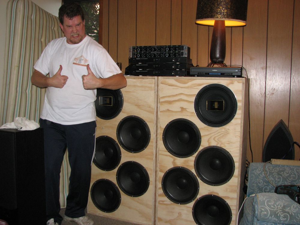

Speak for yourself there Mister. These are my cozy den speakers. :smash:

Dave, I know you already know the answer. These are not used at the level where stereo imaging is part of the conversation. They are the grandest of the 'single pairs' I assembled and they began to sound good in the great outdoors of Vancouver Island after Jesse stepped in to help by twisting the knobs the right direction.
It was like the third festival where you guys yelled at me from the balcony. I was so glad I couldn't hear what you were saying. 😎

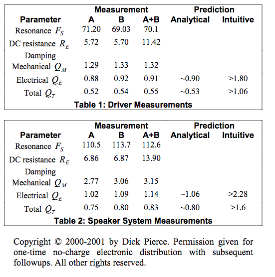

In series connection the back EMFs don't cancel, they superimpose on each other, which could cause interesting interactions with driver difference.
http://www.cartchunk.org/audiotopics/SeriesSpeaker.pdf
Damping remains similar:

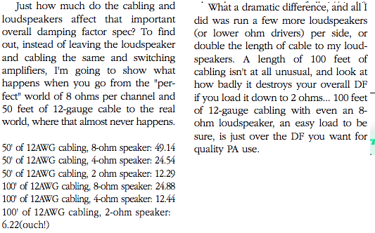

That said, going back to the OP's dual 4 ohm driver example, the series nominal 8 ohm load will have about four times the damping available as a parallel 2 ohm load using the same gauge wire.
https://www.bennettprescott.com/downloads/dampingfactor.pdf
There can be some hint of one-note-bass because for any out of-phase excitation (for whatever reasons, like any non-identical behavior in general) the combo will ring undamped.
The exact opposite happens in practice when damping is compromised by long cable lengths.
Back in the 1980's Harry Witz of dB Sound conducted A/B experiments with their flown EV MTL cabinets (four 8 ohm 18" drivers per cabinet), and with the length of cable they used, (as much as 175' was required for hangs in some of the tall arenas) the increased "punch" given by increasing the damping factor going from a 2 ohm load to a pair of 8 ohm loads bridged mono on the same wire made it appear that the woofers had gained between 3 to 6 dB more "level", even though by power or SPL readings they would be virtually the same.
