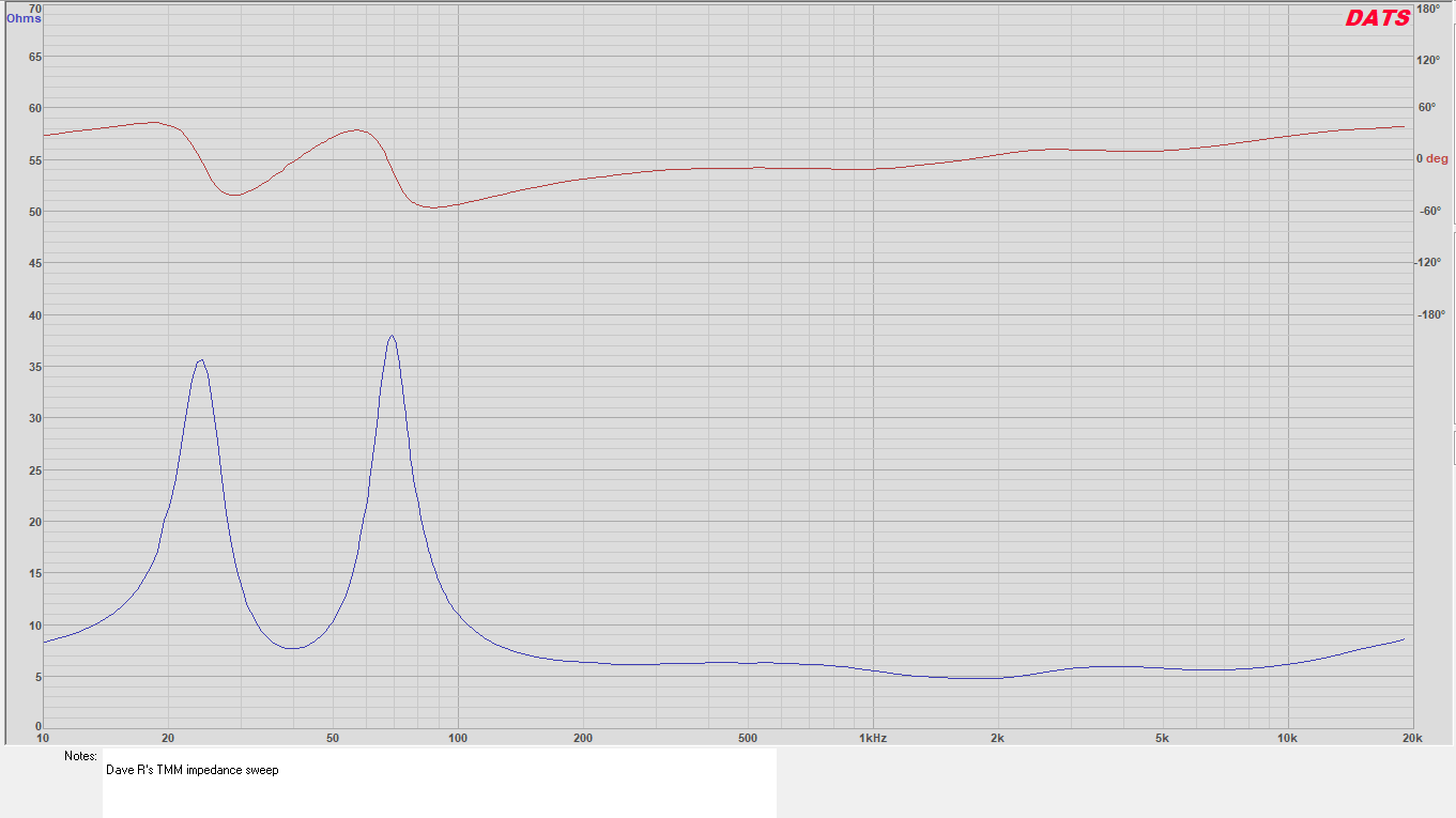

I made a TMM using two 4-ohm mid-woofers in series. The box is ported, and the resulting impedance peaks are nearly 40 ohms. My tube amp has a bit of trouble with bass in that area. My SS amp (as well as other more powerful tube amps) have no problem, however.
