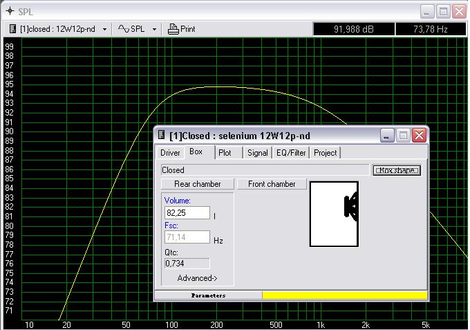

selenium high q required for closed box. Selenium has that only watch out for the limited xmax. works fine for hifi medium power.
simulation series resistance 0,4 ohm of filter is calculated.
http://www.selenium.com.br/site/assets/produtosfinal/262_pdfManual.pdf
It's 5 dB down at 60 Hz. Even with room contribution, the low end will be suffering. eq'ing the response just gets the overall sensitivity down, to a normalt 15" hifi woofer, with natural linearity in the low end (not the high mass moderne woofers - try look at the Peerless i'm linking)

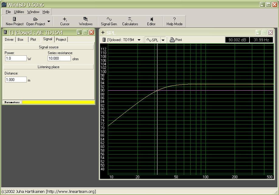

Er.... any limit to the 'box' size? If no, how about this😀
AE TD15M (what?), used in IB (or you can build a box of 1000 liter), and got this: 90dB/w at 32Hz. BUT, driven by an amp with 10 Ohm output impedance.

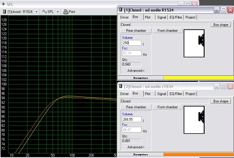

Pay attention for graph of response curve (dB) measurement with "mic" at 31.6cm (or 1/3M).:masked:
