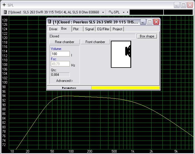

high efficiency woofers are always efficient above 100 Hz. The only way I know of, to get high eff in low freq, is massive cone area. Like the fostex 30" or multiple 12 to 15". Another way is large horns, but that's no what you asked for.
Try comparing a 15" pro speaker like Beyma and JBL. They could be rated 97 dB, but below 100 Hz. they are only 90 dB and at 30 Hz typical 85 dB.
You should go for low freq woofers designed for large cabinets (high Vas), since they will, in real life, produce deep bass with the highest eff. possible But don't expect anything above 90 dB.
Some factors just don't come together.
To get high efficiency, you'd need light cone & big motor, than you end up with a low Q driver with high fs, which is no bass.
To keep the above and make the fs lower and Vas high, you'd need super soft suspension which is not easy to maintain consistence, in both manufacturing and operation of the driver itself. (and even then, the Qts is still low, it's dominated by the motor)
If you manage to get all the above, than at the operation of high excursion at low fs, your light cone and super soft suspension might probably deform too much or even flapping around. (the high pressure of a sealed box is not even added to the picture)
Let's see the new woofers of those mainstream pro sound brands, the cones tend to be heavier and heavier. Because they need to lower the Vas to make the cabinet small. Thick and heavy cones survive the high power (excursion) torture better than light cones, and power is the easy part. So they just go this way.
Unless we have a super light and rigid material (let's say 24" cone of under 100g, for ex.), we can never escape the circle.

There is this relationship for sealed boxes-
(maximum efficiency)= (2E-6)*(F3)*(F3)*(F3)*Vb
Where efficiency is in acoustic watts, F3 in Hertz, and Vb in cubic meters. Believe this is the formula for a sealed box but it could be the formula for a vented box. The only difference between the sealed box and vented box formula is the constant in front. The key point is one can see there is a relationship between box size, F3 cutoff frequency, and efficiency. This is why there are no small woofers with loud bass. Please notice there is no mention of woofer cone area because cone size does not affect the outcome of the relationship. Cone area does affect the maximum SPL and so on. As example, I have a little woofer that in a quater cubic foot sealed is -3dB at 40Hz but is very low efficiency and will only play like 85dB max.
With this relationship in mind I look for woofers which come close to the maximum efficiency in a given box size with a given cutoff frequency.
Here is a 10 and a 12 that come moderately close to the max if no error was made in calculation:
Peerless 830500 12" XLS Subwoofer | Parts-Express.com
Peerless 835016 10" Aluminum Cone XXLS Subwoofer | Parts-Express.com

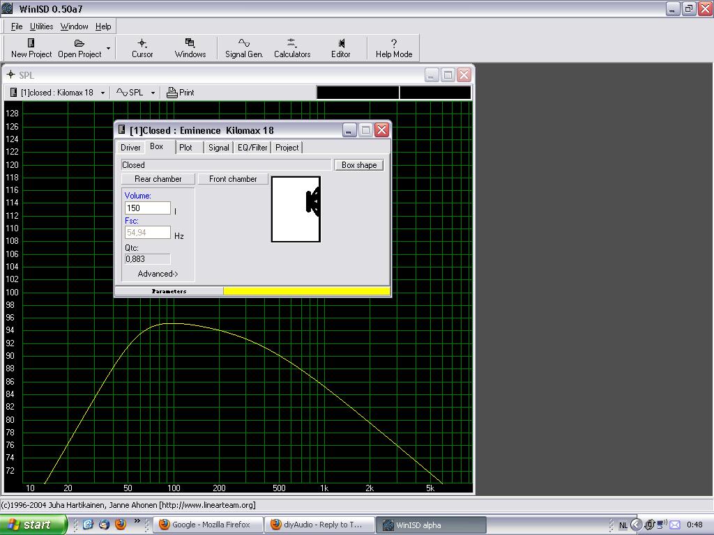

High efficiency driver for closed box.
The eminence kilomax 18"
Please don't let those numbers spoil the fun. In reality, these woofers are not that bad.
