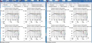

Below is a typical BW3 versus LR4 dispersion graph. You can see that BW3 does a much better job near axis with a two-way. It is theoretically even better with an MTTM.

Slightly separately, how BW3 works really, is it gives far more overlap between the drivers. Which means output falls off far less in all directions at crossover, including sideways. BW3 sounds much better than LR4 off-axis.
I'm not sure why you would advocate MTTM as you will typically get bad lobing through the tweeter range. I'm also not seeing a great distinction between your 3rd and 4th order examples.
Hard to generalize between 3rd and 4th order. We shouldn't make any assumptions about phase angle at the crossover point as it becomes quite arbitrary when unknown driver delay is factored in. Also, the rules that apply regarding phase blending at the crossover point don't apply when symmetrical arrays are considered. This was the primary finding of DiAppolito, that a 90 degree phase shift at crossover gave less severe lobes at crossover point.

How can you get any lobing whatsoever with a symmettrical driver layout? MTM or MTTM? Frankly, speaker dave, you're confused! And I am thinking clearly.
Lobing is where the upwards and downwards axis response is different. You KNOW I am right. :D
Steve, I'm somewhat confused. You appear to be stating that two tweeters in an MTTM configuration are exempt from the issues that they would have in any other situation, that their outputs will sum throughout their passband to behave exactly as if they were a single unit, without any kind of interference pattern (i.e. 'output lobing' / 'comb-filter' or whatever you like to call it) being created per Huygens, Fresnel that varies depending on phase angle from each unit.
Lobing can be both symmetrical and non-symmetrical. Whenever driver outputs are out of phase at some angles, lobing will occur. Dual tweeters will definitely lobe.
