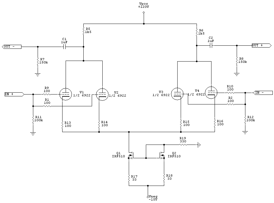

Why no CCS in PP output stage?
SY said:
Using a CCS output stage as its own phase splitter is fine as long as you don't mind the cost, inefficiency, and distortion. The RDH discusses this topology and pretty much dismisses it. And possibly for good reason.
If you mean the section in Chapter 13.3.viii, I don't think that applies to the case where the input section is the phase splitter. Is there a more detailed reference somewhere else?

BTW, my latest idea on how to build my power stage was to have a triode/UL switch, and in the UL position have partial feedback with a 100k resistor (don't want to use an OPT connection since the input stage is in a different box). I haven't yet figured out if the 70 mA/tube CCS setting in the AA amp jives with that. In Jones' book he glosses over how he biases the EL84, and that's what I need spelled out in crayon! 🙂
In the linked John Swenson schematic, the input stage is not a phase splitter, it's a plain vanilla single-ended voltage amp.
The V1 version of swenson's amp used a trafo phase splitter. Tony's "preamp" is already a differential stage with balanced output -- the idea was to use the output of that to directly drive the grids of the EL84s.
dave
