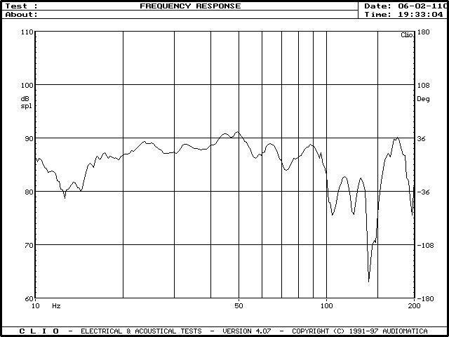

I am frustrated with my speakers that i put a lot of time and learning into building and I still have a nagging problem of no bass with my system.
My design goals were to create a system with high SPL and extended frequency range. My amp is only about 50 WPC, so efficient speakers are pretty much a must. I use these for playing music mostly.
The speaker is a 3-way with a 15" JBL 2235H woofer, an Audax PR170M0 for the mid, and a Morel MDT-37 tweeter.
The mid and tweeter are in their own sub-cabinet. The 2235H is in a 6 cubic foot ported enclosure with two 3.95" diameter flared vents 6" long (tuned to 32 Hz).
I should see a flat response down to at least 35 Hz (according to LEAP and Bass Box Pro), but it dies at about 55 Hz.
Madisound designed the 3-way crossover using LEAP. It sounds great, except the lack of bass.
Anyone have any ideas?

THAT'S the problem! You should be just kicking back drinking margaritas-then it would sound just fine! 😉
The port's maximum output is around 35 but the woofer minima and port impedance coincide well around 27 or so. That's just because this is not a perfect textbook alignment.
But oddly, your system plot seems like the ports are not contributing much, it has the same dip that the woofer nearfield does. I expect the woofer to have such a dip-that's the port operating-but I do NOT expect the system response to look like that.
--> Take all the stuffing out completely and see what happens (though I think you have enough clearance at least for low volume levels, but maybe the woofer back is blocked or something).

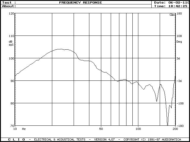

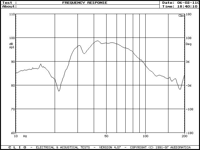

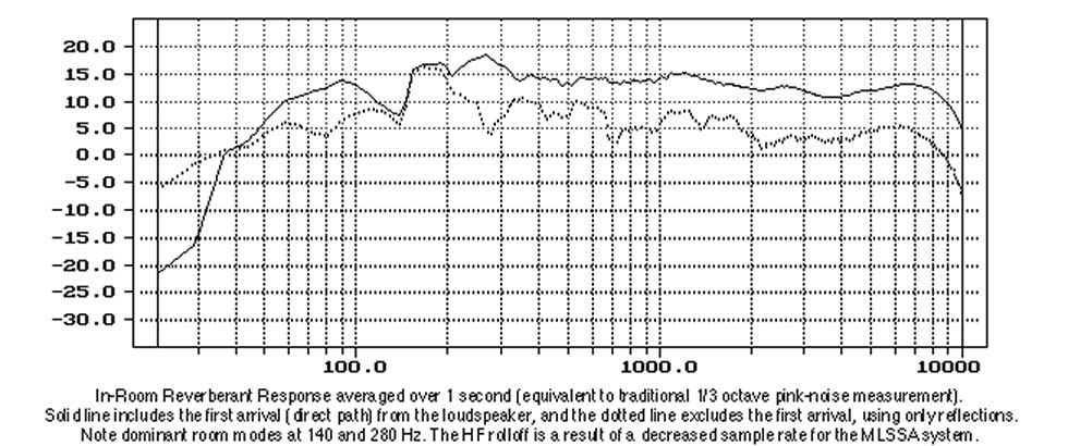

Okay, but this feels like putting pictures of my soiled shorts on the internet, you know. 😀
This is with the mic sitting at the sofa at the same position the listener's head is (before they bury it in there hands, of course), both speakers swept at the same time, same volume.
Obviously, I have a little issue with room acoustics at about 60 Hz.
I did measure both speakers and they do perform almost identical.
If you look at a few posts back, I did a 3-D picture of the room layout. See post #58. The plot above was with the sofa against the wall and one speaker in the corner (first 3-D layout).
Eventually, we would like to rotate everything 90° counterclockwise when we get some more redecorating completed.
To get an idea of what the impact of those changes I moved everything in the room as we plan to put it and ran another plot from the head position at the sofa. Both speakers were jammed into the corners with them angled toward the listener (mic). This was the best performance. Moving the speakers away from the wall made the bass worse. Here is the plot with the speakers all the way in the corners (second 3-D layout):
The bass is much better. However, what gives with the treble at 8,500 Hz?
Moving the speakers from the corner does not help the treble, incidentally.
I will try the idea of pulling the center stuffing panel out this weekend.
Thanks for posting the first curve - several things jump out at me:
1) The bass is essentially one note at 50 Hz, so it'll sound like a thud, not bass, and there are two huge suckouts at 100 and 200 Hz. This is the frequency range that gives music "support" - if a system is thin in this range, it'll sound like "no bass". The problem with "filling in a hole" with equalization is that it costs a lot of power and woofer excursion - better practice is removing the peaks, and letting everything else come down to average level.
2) What jumps out at me is the region from 700 Hz to 2 kHz is elevated 5 dB compared to the treble and much of the rest of the range. This is a crossover design error, and will dramatically affect the balance of the entire system. You don't have too little bass, your mids are too hot!
Beg, borrow, or steal a parametric equalizer, and set a 10 dB notch at 50 Hz, and pull down the region between 700 Hz and 2 kHz about 5 dB. Once you hear what a halfway flat system sounds like, you can get to work on the midrange crossover. The rise at HF, by the way, is caused by increasing directivity from the tweeter, and is normal - you can see the same thing happening with Ariel room response, shown below. Subjectively, the Ariel has a slightly "warm" balance, and sounds very smooth. That is designed in, since mid or HF emphasis is very rare in nature, and usually sounds like a recording artifact when you hear it.
Some people like artificial sound, but I don't, so I deliberately adjust the frequency balance to bias the response in the direction I want. A 1 to 2 dB tilt from 100 Hz to 10 kHz is a common practice in the industry, and sounds subjectively flat. Flat does not sound flat. What matters is subjective flatness, not what you see on the measurement.
P.S. By the way, professionals never measure the frequency response at 1 meter. I've been doing this since 1975, and I've never come across anyone in the industry measuring at 1 meter. The reason is simple: the wavefront hasn't fully "gelled" at that distance, and if the system is EQ'ed flat at 1 meter, it most assuredly will be wrong - sometimes very wrong - further out. In practice, 2 meters is a very common measuring distance, and the efficiency is back-calculated to the 1 meter distance - although the true Thiele/Small efficiency of the woofer gives more accurate results, since it's not affected by peaking elsewhere in the range.
To summarize, deal with the 50 Hz peak any way you can. Measure the port directly - is it tuned too high? Well, there's your answer. Otherwise, assuming the port is tuned to the correct frequency, you must physically move the speaker or apply EQ to get rid of the big peak.
The mids are way too hot, and stand out from the rest of the range, particularly the treble. Even your second curve shows the elevated region. This will not sound good, unless you're trying to replicate a JBL L100 or Klipsch Heresy, where the mid emphasis was a deliberate design feature.

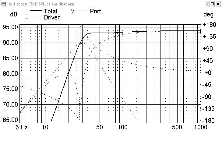

Hi Loren42,
Working over the weekend on a speaker project – you must be an avid speaker builder !
I’m not sure if I can be of help here, but I took the data you posted and entered it into LEAP5. As it turns out, Leap5 has a model of the JBL 2235H in its library of transducers, so it didn’t take long to run a simulation on your system. I noted in one of the pictures you posted, you were using a vacuum tube amplifier, with a power output of about 50 watts. I made the assumption that the output impedance of the amplifier plus the DC resistance of the Xover was about 1 ohm, which I included in the simulations.
The enclosure volume in the first simulation (red curve) was fully stuffed with fiberglass stuffing material and as you can see from the attached, the response is reasonably flat, except for a very shallow roll-off below 100Hz, followed by the normal low frequency –3dB point at 32Hz.
For the second simulation, I reduced the amount of stuffing from 100% down to 30% resulting in the response shown by the blue curve. As you can see, this gave an increase in level of about 2dB at 40Hz.
Keeping the stuffing the same, I then ran a simulation with only one port having a diameter of 6”. The length of this port was adjusted to give the same tuning as with the 2 x 3.95” ports. The results of this simulation are shown by the green curve and as you can see, it pushes the response up just a little bit more at 40Hz.
For me, I often find that a small amount of bass boost like this sounds much more natural than a flat response in my listening environment.
Lastly, I note you said that you had installed a curtain of damping material in the enclosure. This reminded me of a comment made by Martin Colloms in his book High Performance Loudspeakers, where he described the measurements made on a 3rd order BP subwoofer with damping material that was not well secured. One of the responses was made with a swept sine wave and a second response made with an impulse response + FFT. Under normal circumstances, both measurements should appear the same, but in this particular case, they were very different, especially at frequencies in the range of 20Hz – 50Hz. The swept sine wave measurement showed an extended low frequency response, but the impulse response did not. The reason for this was said to be due to the swept response allowing the damping material to move more freely because of the long time it took to make the swept measurement, but the impulse response took very little time to measure and did not allow the material to move at very low frequencies. Colloms credited the publication of this phenomena to Fincham at KEF Electronics.
Hope some of this is of help to you and good luck over the weekend.

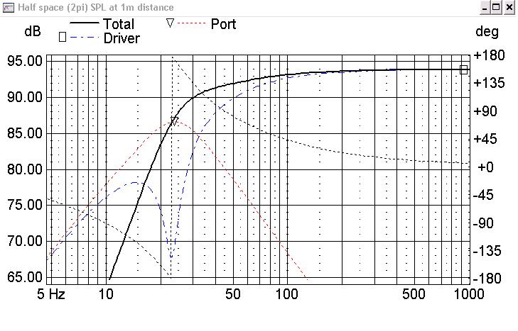

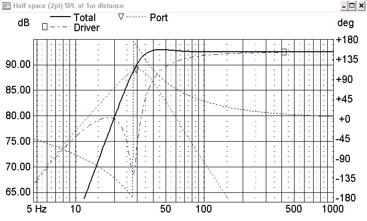

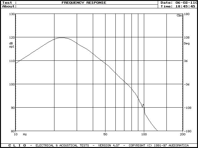

A friend of mine use two JBL 2235H as subs, enclosure about the same size as yours but tuned lower @23Hz. Last Saturday I did some measurements for comparison.
Attached pics in following order:
Simmed result 2Pi 28Hz tuning
Simmed result 2Pi 28Hz tuning , 1Ohm source
Simmed result 2Pi 23Hz tuning
Meauserments with active filter 80Hz, no EQ and subs only:
2235H 5” away from dustcap
Port contribution (5” distance)
Inside box
Listening position (disregard the 10Hz disturbance)
Quite good I’d say, room gain sum nicely with the falling slope ebs alignment.
I’d suggest a measurement out of your room, preferably outdoors to see the real response out of our design.
Now it seems like either some box issues or room issues that you need to compensate by corner placement. A 2335H in a 6cu ft box tuned to about 30Hz should do just fine imo. Also, try another amp to be sure.
Inside box
