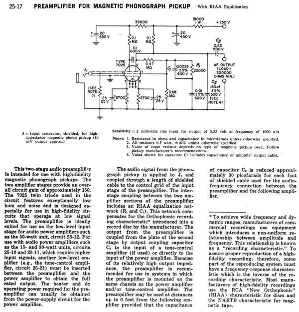

The 12AX7A is identical to a 7025.
Not so. The key difference between the 7025 and a 'X7 or 'X7A is the presence of a spiral wound, hum bucking, heater. The difference between a 'X7A and a 'X7 is controlled heater warmup time. Please notice that RCA called for the 7025 in the famous passive EQ RIAA preamp. While difficult to implement, AC heating 7025s can yield tolerable hum levels. The Sovtek 12AX7LPS is a genuine 7025 equivalent.

Hi Eli,
I ran across some literature a while back that stated that the 12AX7A was a 7025, and it wasn't sales oriented stuff like a white paper. Then there are all the tubes out there branded 12AX7A/7025 from all the really good manufacturers of the day. I'm referring to the NOS, new in the day stuff. Any tube not marked with both numbers are either 12AX7 tubes, or old 7025s. I think that it's perfectly reasonable to assume they are equivalent being marked in that manner. A spiral heater doesn't even cause trouble on the production line. It slides into the same cylinder with the same coatings.
I'm not attempting to second guess you, but the truth of the matter has to lie somewhere and I can't see the large corporations of the time telling big fibs.

My understanding is that the original 12AX7 had a conventional heater. Philips/Mullard made a similar valve but used a spiral heater, calling it the ECC83. Then the 7025 appeared, essentially a US version of the ECC83. Finally some later 12AX7 acquired a spiral heater too.
The net result is that if a valve is labelled ECC83 or 7025 then it should have a spiral heater - but we know that modern valve makers play fast and loose with valve naming conventions (e.g. the ECC99 on a B9A base, when '9' means B7G!). A valve labelled 12AX7 may or may not have a spiral heater.
