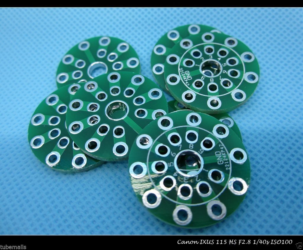

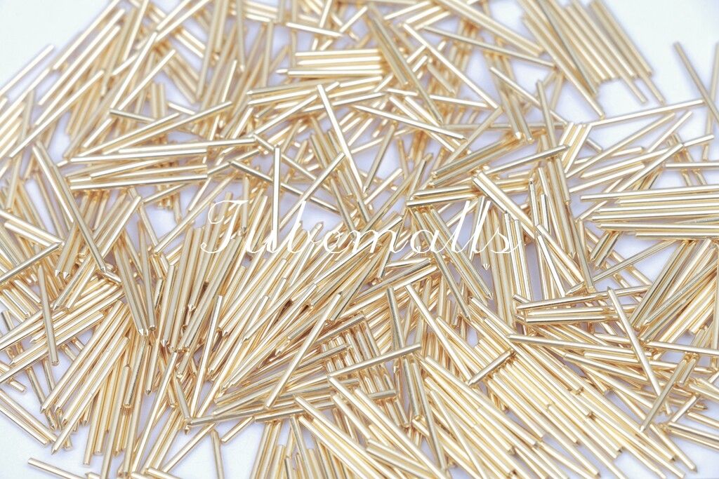

Make any tube into a 7199 base: (pics)
6AU8 is interesting, since it uses the 9DX base. Over 20 other tube types use that base too, including some frame grid types. Some resistor changes likely needed to try them however.
