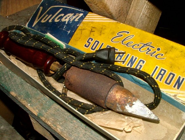

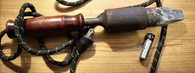

This 310 Watt Vulcan will solder very large Copper, must be 50 years old, still cooks, and the factory is in a field an hour away from my house.
