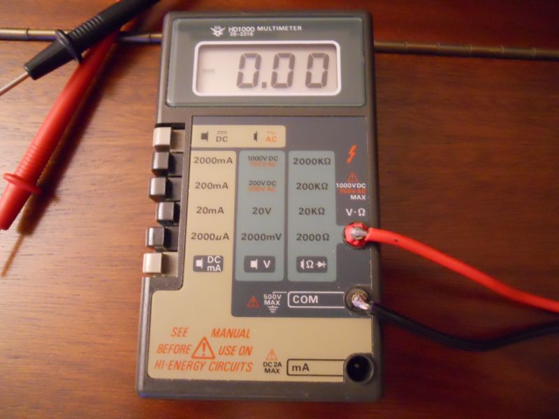

Despite having some half decent meters, I always keep this handy in a drawer. Note the high quality test lead terminations on the meter :D Just be careful how you grab hold.
