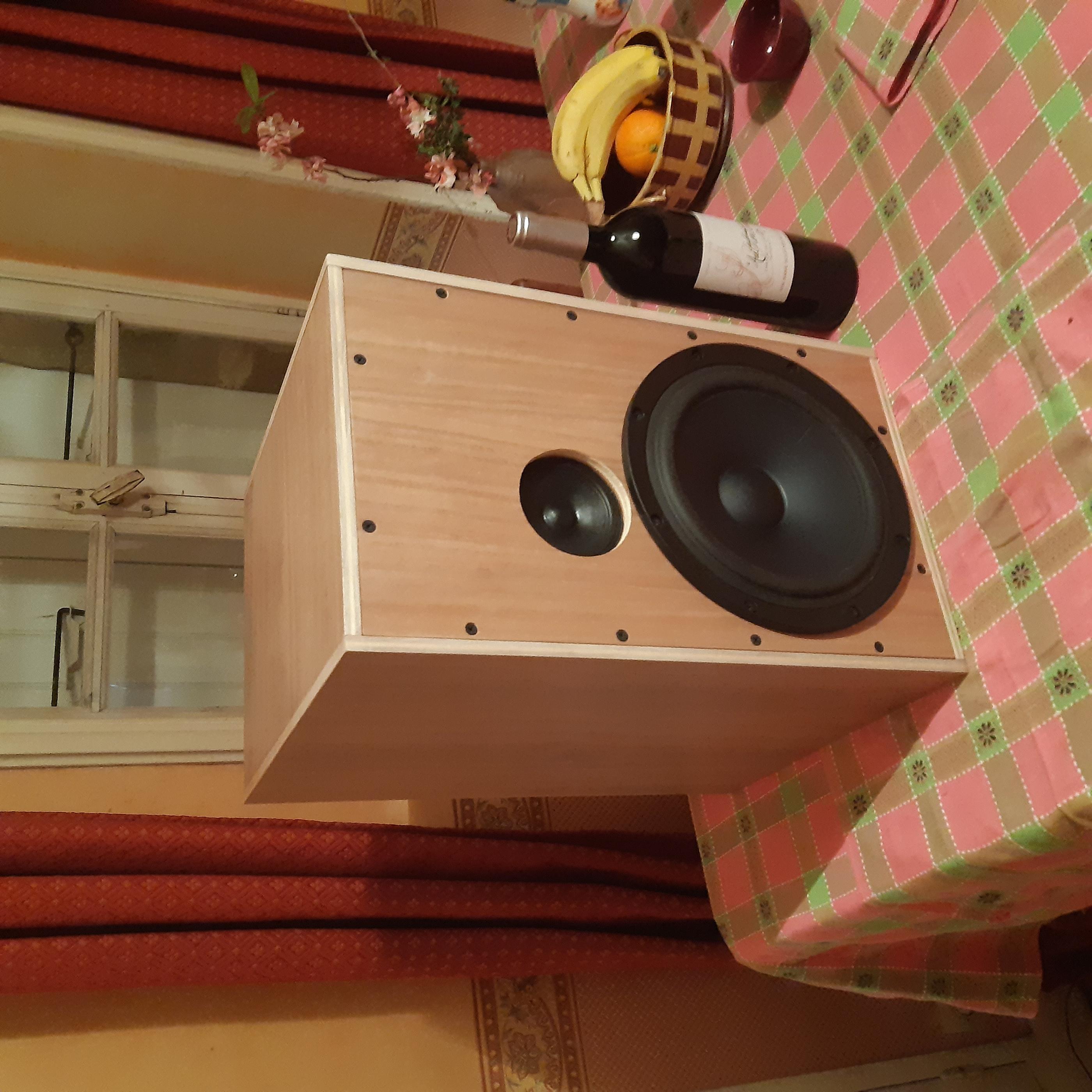

Btw the 0.4 eucalyptus/poplar ply AB furniture grade is not chipping and seems ok inside.

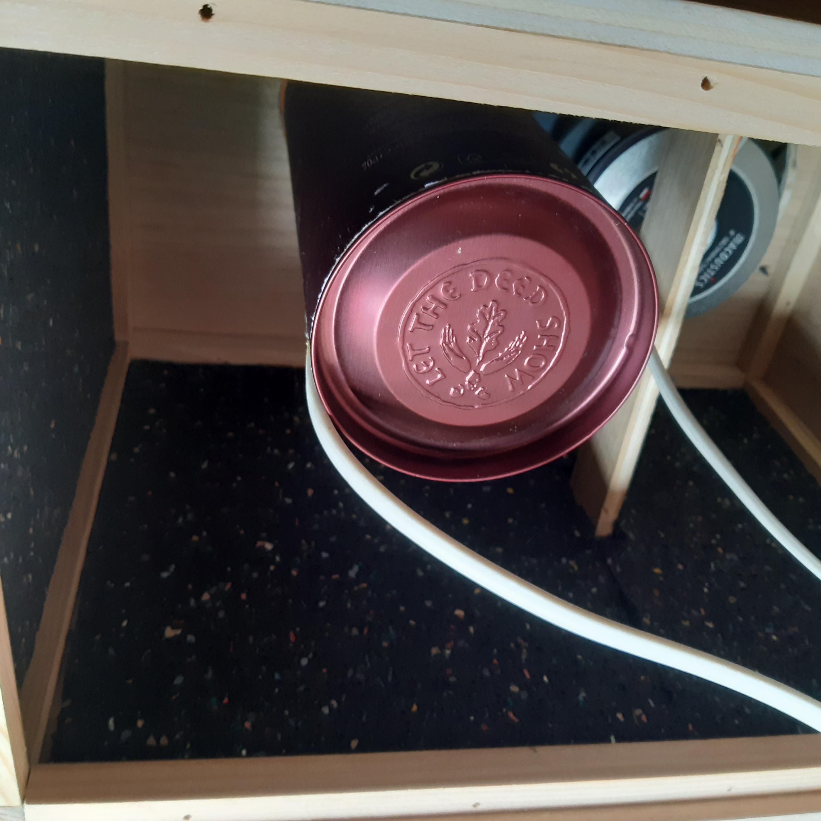

I'm trying to make a sort of but with thin plywood. I was surprised how a little driver unit like the SS 10F, a 3", is able to check all the cabinet !
Thanks, will try both ways as it's here to experiment !
The tube was also for bracing, the back is not touching the back trap.
Well it becomes off topic, more later elswhere. Just to say I'm happy with the ply quality AB I have, but not for cement or concrete mold grade as Jim is using for the garden shed but AB furniture grade for mine (very light, but 100% poplar is even ligther)

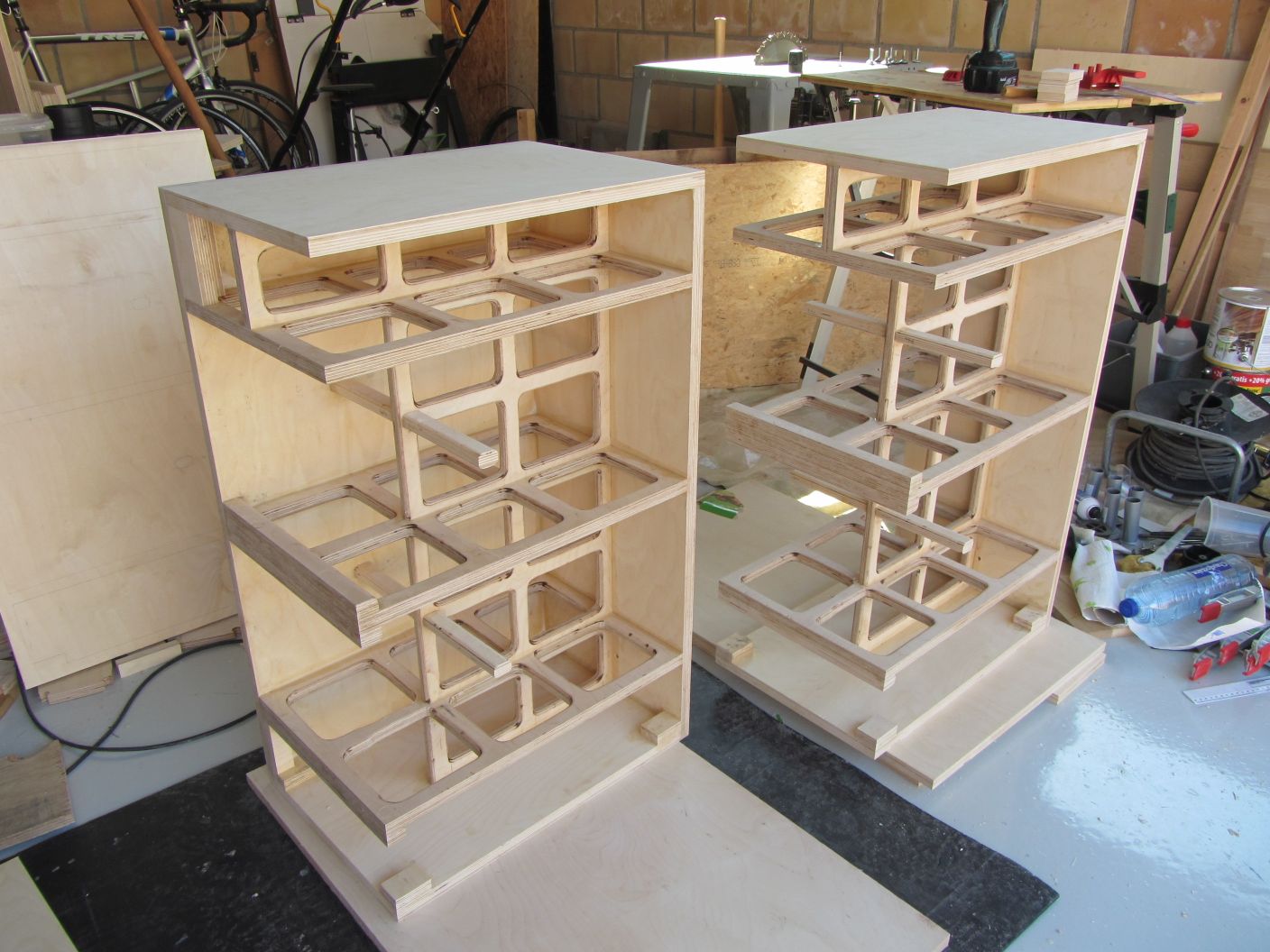

Hi diyiggy,
it's like planet10 said,
without bracing large panels are easy to bend and they will vibrate/resonate at low frequency.
By adding bracing you divide the panel in much smaller panels that vibrate much less and also higher in frequency.

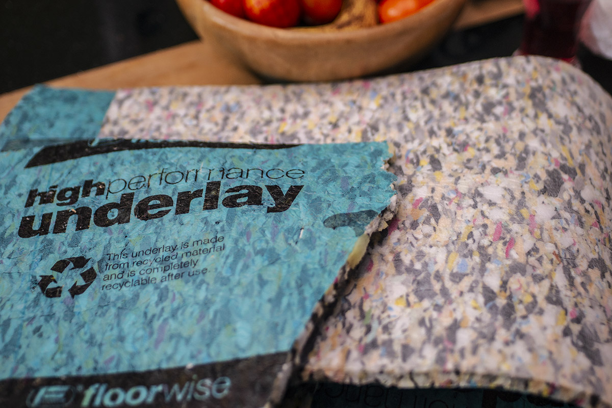

Yesterday I salvaged some nice thick carpet underlay from the dumpster behind the local carpet store to use in some speakers I'm upgrading. I'm still hunting for some bituminous roofing felt and waiting for sheep shearing season to obtain a load of Herdwick wool

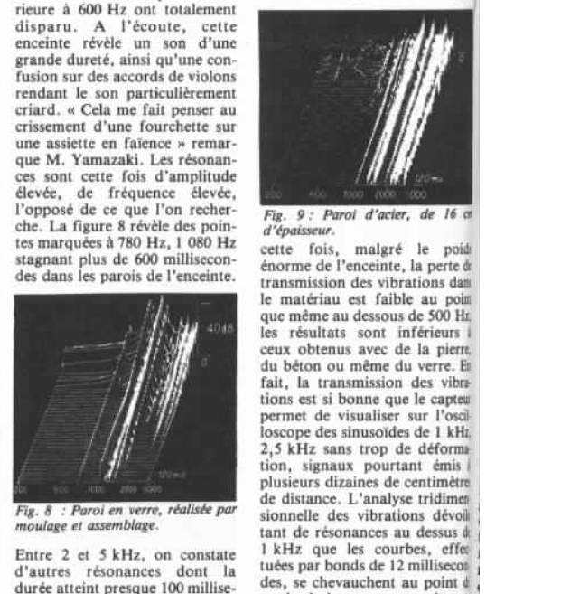

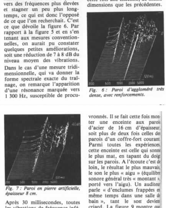

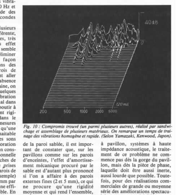

Hello,
Jean Hiraga wrote about a test that the Japanese have done in the eighties. By using certain materials like glass, concrete, steel they could kill all the vibrations in the lower frequency area but they would end up with vibrations at higher frequencies which would last much longer and all give a loudspeakers with an unpleasant sound.
Usually the best results were realized by using a sandwich that would dampen vibrations in a broader range and reducing the level equally.
Greetings, Eduard
