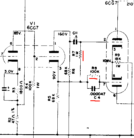

When browsing Altec schematics posted on the web, found this asymmetric treatment (from 1568A, attached) of the coupling/blocking capactors following a 6cg7 split-load. What is the advantage of doing this?
Notice that the bottom section of the PP 6CG7 is direct coupled to the cathode of the split-load tube through R8. C4 is not a coupling cap; as Miles said it appears to work in combination with R8 as a phase compensation network. The 1M R7 provides grid bias for the top section of the PP 6CG7 which is cap coupled to the plate of the split-load. Perhaps Altec decided that the compensation network is necessary because only one of the two sections is direct coupled. WTFDIK.
-- Dave
I should add, I'm not completely opposed to asymmetric PP drive just because it doesn't look good on paper.
I haven't heard one, but many people report that the Seth amp sounds very good. I do know (from conversations with someone that has probed a similar circuit) that the signals at the two PP grids of the Seth are FAR from symmetric. The top grid - which is really just cap coupled with a grid choke - looks very 'good' while the bottom grid - which is really just fed from an inverting interstage - shows all the expected frequency anomalies. Still, people say the amps sound fantastic.
Returning to the subject of this thread, I have built very good sounding PP amps with isodyne phase splitters (as found in the simple Magnavox amps.) This was some years ago when I was experimenting with PP EL84 amps. I found that the isodyne seemed to have more of the realism present in SE amps than the much more symmetric concertina and LTP.
-- Dave
