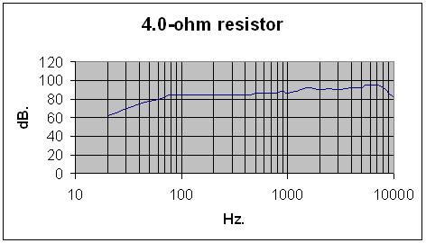

The question I'm asking is, in effect, What composite of attributes looks like the right balance? Can we make a formula that takes phase, driver agility/compliance/speed, FR, comb filering, distortion of different types, sound stage (which might be a function of directivity and dispersion), and other attributes, and roughly weight them such that a high number is a speaker that sounds better? I'm looking for the variables and the coeffecients.
I know that Mr. Linkwitz places a great deal of emphasis on a flat frequency response and coherent phase response.
From his theory on speakers, a fun speaker is inaccurate and deviates from the recording itself. If the recording sounds fun then so does the speaker. If the recording is boring then so is the speaker. This is how a speaker should act. A speaker that always sounds boring has some design issues and a speaker that always sounds fun also has some design issues. Namely in the FR response department.
I find that at live performances the cymbals sound with greater volume than the rest of the band, my goal is to recreate this with an slowly raised top-end, but not for a broad area. It is tough and I've come very close to the sound that I remember. Of course, balance with midrange is more important than the raise in the higher frequencies. I'm tapping my feet and the speakers aren't in an enclosure yet.
